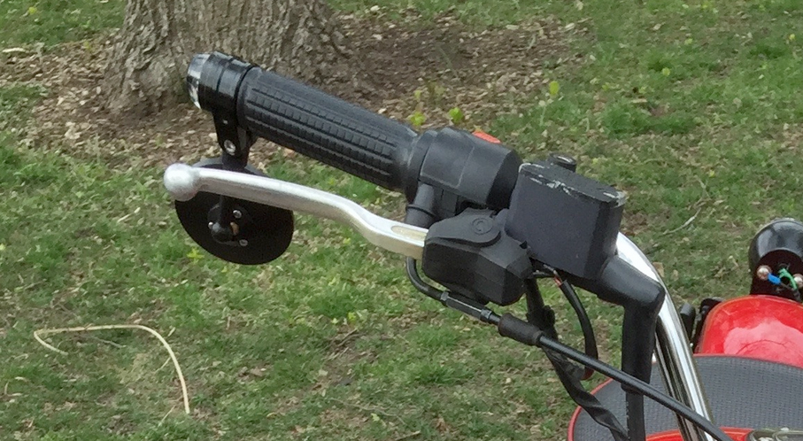

Offline kidsmoke
  • Posts: 1560
  • Location: Indiana, USA
Re: Throttle assembly - terms and parts query
« Reply #3 on: April 25, 2015, 01:55:42 PM »

Online rodekyll
« Reply #4 on: April 25, 2015, 02:09:49 PM »
I think that has the throttle that takes two cables.  In 2000 they only shipped with one installed.  The second cable is a good idea (positive throttle return) and might also limit that travel.  My stop (2003) is also worn, but with the two cables it doesn't seem to matter.  ymmv
