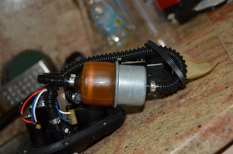

Ok, for the record my '14 USA spec v7 stone has the half-plastic fuel filter.  I couldn't see it with the inspection camera, so I just pulled it.  I don't know if it is swollen or if it comes like this from Austria. This one has been soaking in 10% ethanol since about Sep of last year.
I'm going to swing by an autoparts store (advanced, autozone, pepboys, or napa) to pick up an all metal replacement filter and some stainless clamps.   Any filters you all recommend?  Can I use the screw type clamps (jubilee clips)?

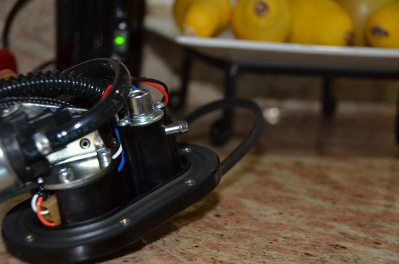

Also, before I put this all back together again, what is this nipple supposed to connect to?  Did a hose come off this while I was pulling it out of the tank?

I just ordered the Mahle 145 from Amazon.  Still need to now what that nipple connects too.  Can I lower my low fuel sensor while I'm in here?

Think that's some sort of pressure release valve.  If your hoses are still connected at each end, you're good.  While you're there, I would replace the rubber hose that's upstream of the filter.  Even though we've heard of no failures on the V7's, that's the one that pops off on the earlier bikes.  Use Otiker or the smooth collared fuel injection clamps.

If you are going for the rack-and-pinion clamps get the ones with the rolled edges -- less likely to cut the hose.
That nipple is the pressure regulator/fuel return.  It needs to stay open and clear.
