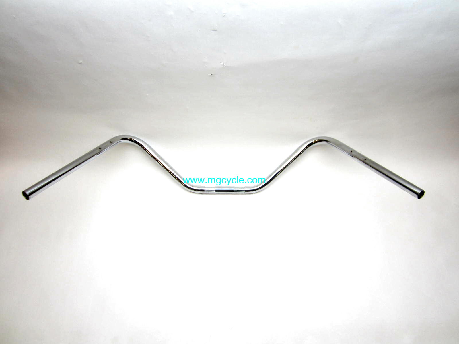

  I have a customer with gout that is looking for a more comfortable bend bar for his Griso.  It seems the Mana bars seem to do it for a lot of people.  Is there anyone out there who could share there experience?  Any pics?

Mana bars on my Griso. They're 45mm narrower and have more pull-back.

Norge & Breva take oversized bars if you swap the uprights that hold the stock tubular bars...  and replace with the risers/clamps from a Sport 1200. This worked great on my B1100 but can't say if it would interfere with the Norge fairing.
That is the route I went, and I used a ProTaper kx High bar which cost at least $100 less than the Mana piece... Tho the stock bar ends will not fit & you have to sort your own locating holes. I added hand guards when I swapped my bars so the weighted bar ends were not an issue for me.
On the GRiSO is should be a straight swap, unless cable lengths become an issue due to some crazy high rise bars.

I had a G11 with stock bars and now have a 1200S that I converted to Mana bars. The Manas will be significantly narrower and have more rise and pull back.  This all makes for a much more natural arm position. With the standard "flat" bars, your elbows are sticking out to the side. Pull back allows your elbows to drop down.  I'm sure the change will be welcome.
