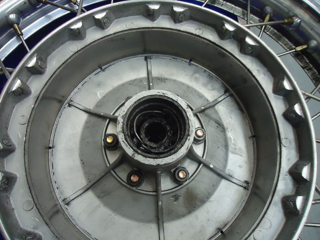

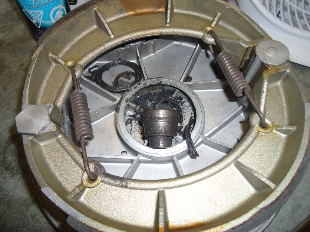

Make sure you check the shimming of the bearings, when I rebuilt my Eldorado a couple years ago I failed to check the shimming and in short order I destroyed a set of tapered wheel bearings.
Not pretty
Follow Gregory Benders advice on cleaning the bearings 1st, oiling them (no grease) and checking the shimming. Once the shimming is right then you can grease them.
Or you can wait for this to happen :sad:
