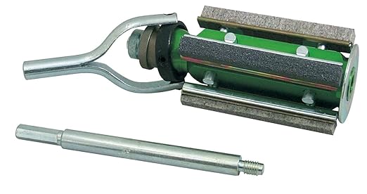

 I have a rack and pinion drive hone like the one in this photo. With patience and guidance using a hand held drill motor it can hone out a cylinders .010 and keep out of round and taper to less than .001. But it will follow the path of the existing bore... I have used it successfully on low performance vintage car engines...It might be a tool of last resort on a high performance engine...
