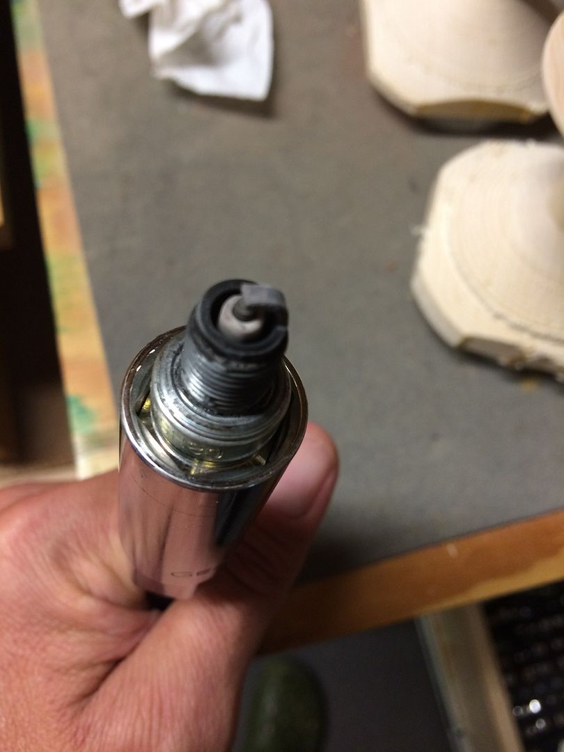

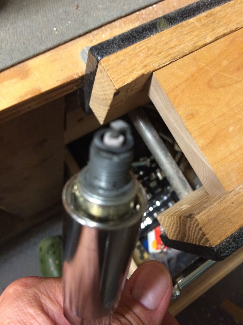

« Reply #15 on: August 19, 2015, 11:49:50 AM »
Yeehaa... Looks like I can keep going! Last change: Bikey reacts to throttle nicey!
None too rich.

« Reply #16 on: August 19, 2015, 04:06:32 PM »
Good deal, those plugs look like a perfect burn to me.
