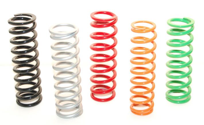

Boing Boing - Is there a easy way to measure a springs rate?
I have the optional chrome shrouds on my YSS shocks (I forgot to mention earlier that they are not the model with the remote reservoir - they look more like the stocker shocks).
But I had a problem with my YSS springs under the shrouds. The shrouds were a little small for the spring diameter - not enough clearance, and after a few years some serious rust formed inside the shrouds and the springs started to bind inside the shroud. Oh oh.
I couldn't see that rust until I took the shocks apart in order to paint the springs gloss black. I had to use a lot of force to get them out!
The painted YSS springs wouldn't work with the nicer original stock shrouds that I planned to reuse, so I had to go back to the stock springs on the YSS shock body. Works pretty good. I think it is a stronger spring. :undecided:
I should have measured the spring rates of the different shocks for any future decisions.  doh!

I measure unknown spring rates with a hydraulic press and a trailer scale.  I compress the spring and see how much the scale deflects for every inch of compression.  The spring must must be captured during the testing as they have enough force to seriously injure you if they get loose while compressed.  Safety first when dealing with springs.  Mike
