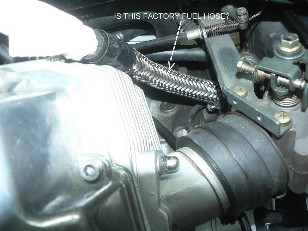

Just bought this bike and am unfamiliar with Guzzi. Want to make sure if I'm missing parts, and current status of parts which may have been replaced.
Is the fuel hose shown what comes from the factory, or did previous owner replace already?

Yes, and yes.

fuel hose is stock.. battery hold down, looks reversed, I think the hole goes under the tank bolt? maybe.

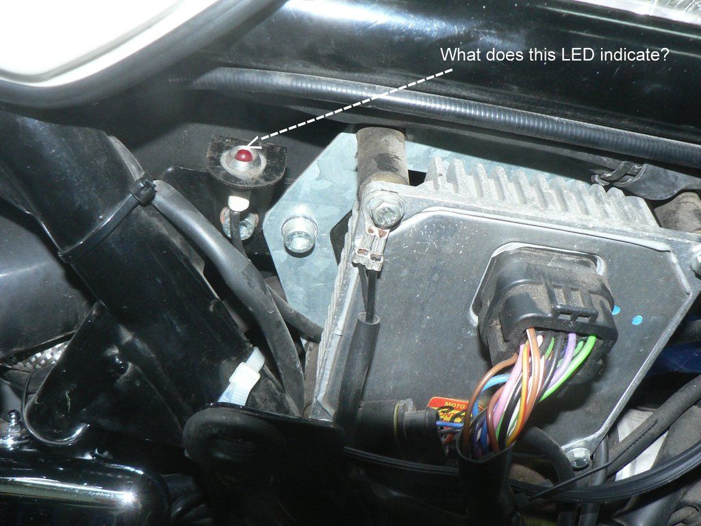

Guess I'm lame but I cannot find the description of what the LED light shown in the photo does. I see it identified as #47 on the schematic calling it 'LED diode light connector (NOT ASSEMBLED)'. I see no reference in the owner's manual or the shop manual, so guess I'm looking in the wrong sections. Harper's only says 'not for sale idividually'. While I'm at it, I assume that is the 15M control module adjacent to it, correct?. Can someone please educate me? Thanks, Dean

I think it might be there to indicate engine fault codes. I never pay any attention to it.

 Yes , 15 M .

There's a method of counting the pulses for stored fault codes. From memory, it involves first sacrificing a chicken..

it is the trouble code flasher.. details in the Fuel Injection supplement manual, get it from thisoldtractor.com

Thanks, I'll get the manual. I noticed it lit when the key turned on and I could hear the electric fuel pump. I'm definitely gonna start looking for that chicken though......
