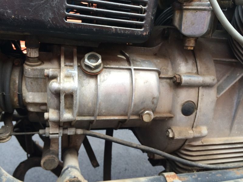

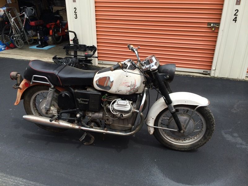

I have a '71 ambo with a 5 spd Eldo transmission on it, wanna trade? This is a non-running barn fresh bike FYI
Serious offer, here's some pics, PM me if yr into it
