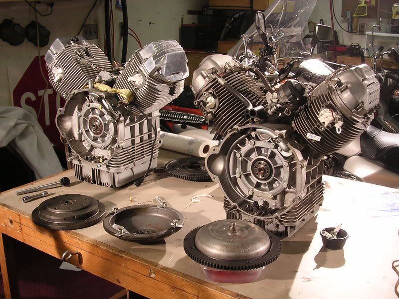

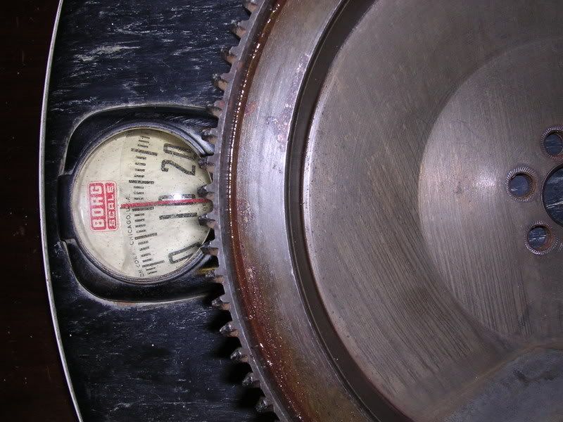

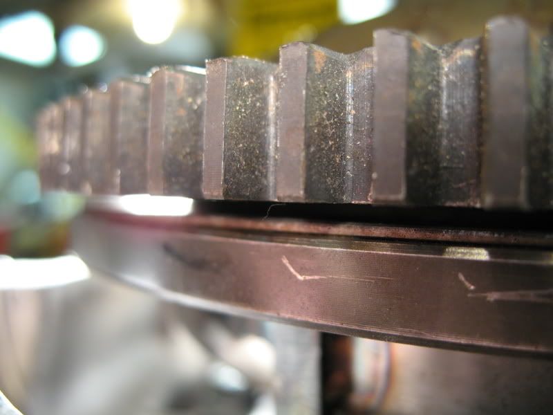

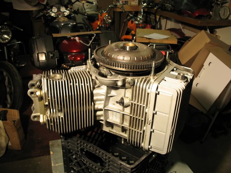

Still learning about these bikes.  How can I check for what kind of flywheel?  I understand there is a timing access hold somewhere?  Where to look?  Thanks
  • Posts: 20001
Re: convert-possibly dumb question
« Reply #7 on: September 24, 2015, 11:04:12 AM »
Right side of bell housing has a rubber plug, same as 5 speeds, in that hole you can see the edge of FW.. If it's one piece with ring gear it's the heavy FW. If thin and ring gear a separate part it's the recalled stamped sheet metal one.
 Light FW:
center one is the recalled FW on left is an EV FW
here's a heavy FW
