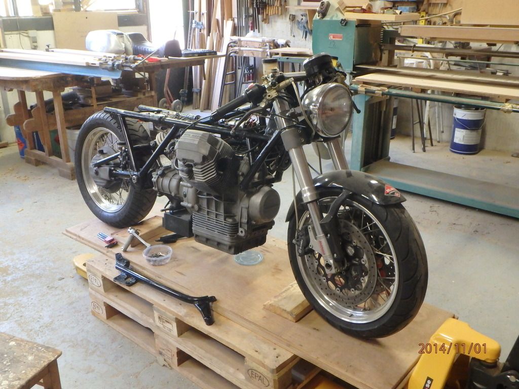

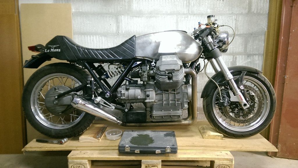

The reason I'm going back to the standard frame is that I don't believe that the danish MOT guys will allow me to run Mono shock and no lower frame rails. So I'm going back to standard twin shock and standard frame.
Have you chopped up your frame yet? If not, maybe you would be interested in buying mine? I will return from Indonesia next week, so I can snap some photos of the frame and timing cover in about a weeks time if you're interested.
Bike as it looked when I bought it. I have returned the swingarm to twin shock mount, so that's not available. Wasn't really made that nice anyway.
Sideview
Without clothing.
If you're interested in the frame you can PM me, and we can find out about something, also we safe another guzzi frame from being cut up  :grin:
