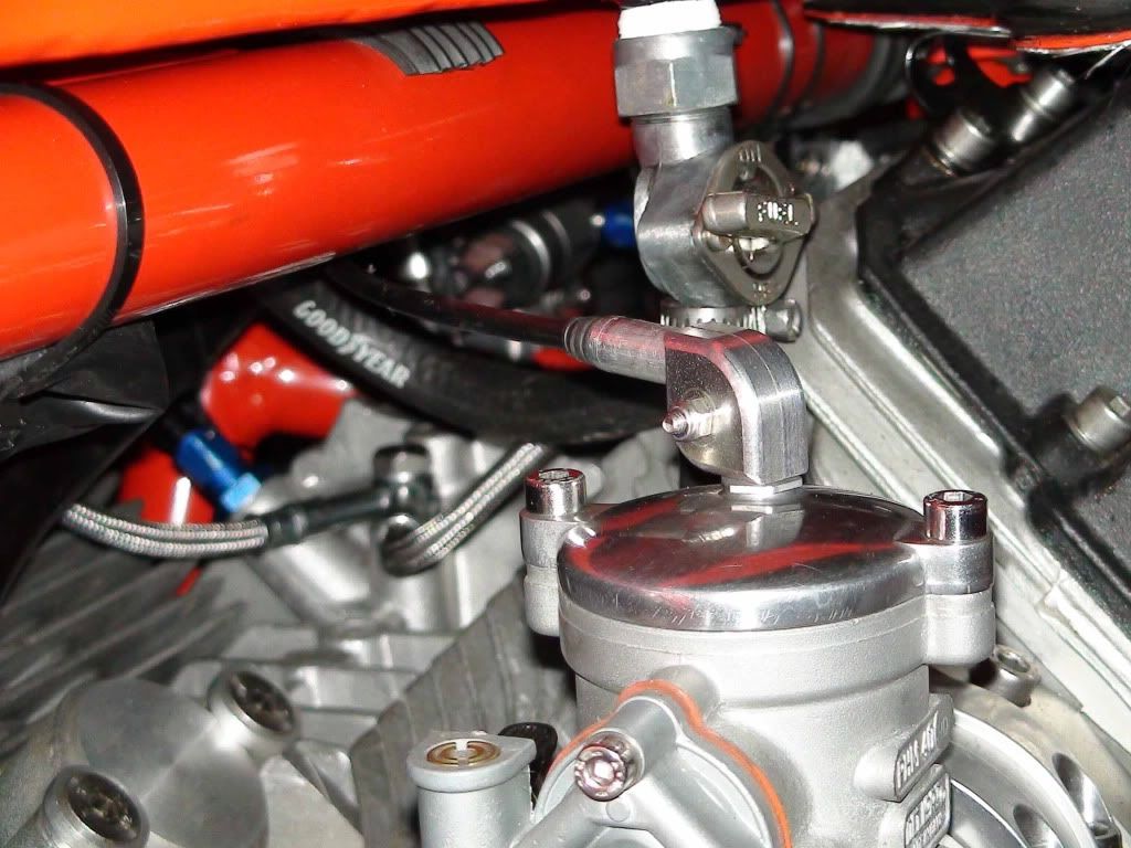

clue is PHM on LM 1000 not PHF, can't remember if all LM1000 were like this but certainly late ones were, funny rod, no jeesus clip on needle, plate (#31) instead
Guzzi steadily made throttle worse from orig LM , peaking with this one (also on 40mm carb 1000S), then over revving on 1100 Sport, the very worst
The answer as with all of them
Tomaselli 2C  throttle, flat tops, light springs deviators and teflon lined cables.
Throttle as light as a normal bike,
Exactly what I did, difference is amazing on an LM1000. I also got the Guzziladen roller 90 degree cable pulley with a bearing inside and made cables from a set outta the local bike store
Works a charm and have not had any sticking open events either (I do have a kill switch in case it ever does manifest itself)

« Reply #16 on: January 03, 2016, 05:41:51 AM »
there is a difference between the bell cranks and the flat tops in terms of ratio of cable pull to slide pull. With the flat tops, the slide moves 1" if the cable is pulled one inch (1:1). With the bell cranks, you get "quick pull" action. I can't remember the ratio, but the ultimate effect is you get faster lift at the expense of harder pull at the wrist.
On top of all this is the pumper lever. When that hits the ramp on the slide and gets pushed into the diaphragm,  you can feel the effort go up substantially at least momentarily.  Add a quick turn throttle and you are really having fun.  Figuring out what kind of throttle you have isn't tough. Just compare the diameter of the barrel (usually plastic) where the cable wraps around it. The smaller the diameter, the slower (easier) the pull.
IIFC, the tomaselli 2C has a relatively small barrel compared to some. Some throttles have a snail (or cam) shaped cable run at the throttle for variable pull.
When I raced, I used the plastic flat tops mainly because they were lighter and had the pumps levers removed. I also used a 2C throttle. Interesting some folks associate the bell cranks with accelerator pumps. In reality they are not connected. I believe the bell cranks came into being to provide a quick throttle function, and to allow quick cable replacement.
« Last Edit: January 03, 2016, 05:45:07 AM by mtiberio »

Offline guzziart
  • Posts: 1152
  • Location: Northeast Ohio
Re: PHM 40 carbs question
« Reply #17 on: January 03, 2016, 08:24:00 AM »
FWIW, my '87 LM IV has PHM 40 carbs with bellcranks, there are no internal slide springs.  The slide return springs are on the outside of the carbs.
Art
