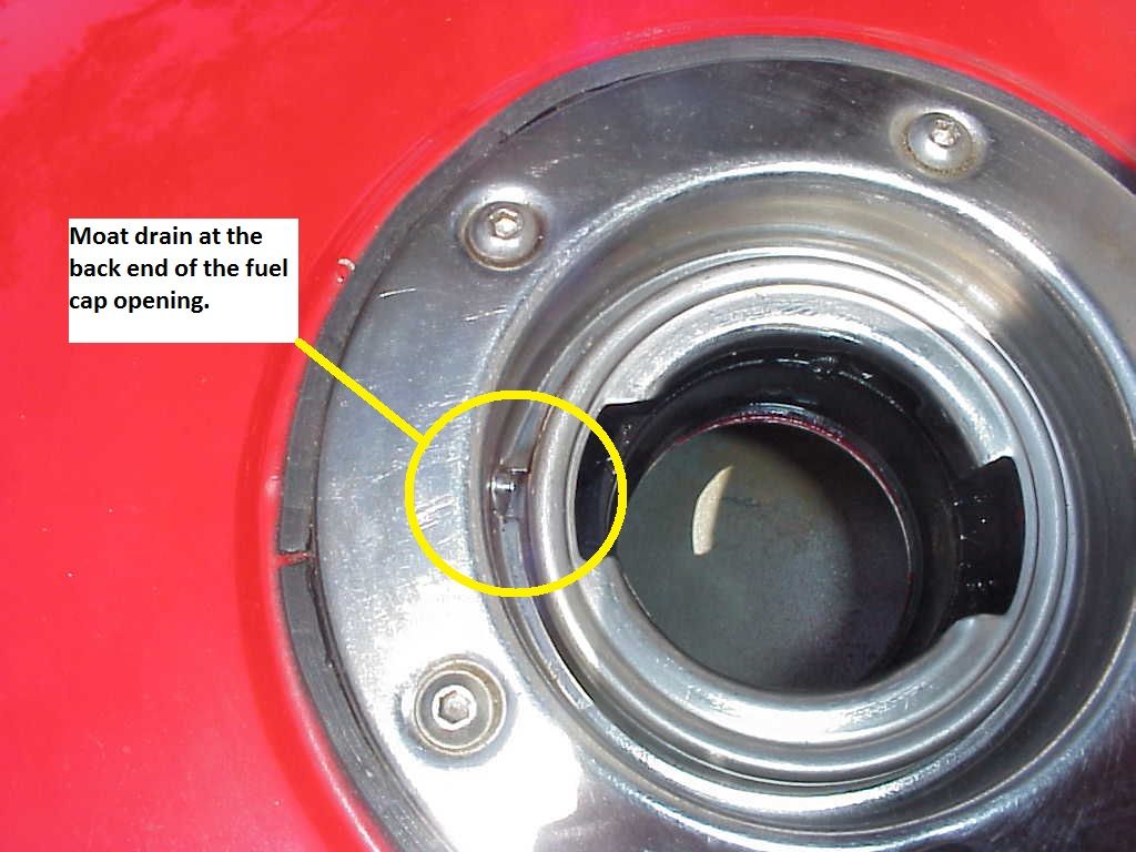

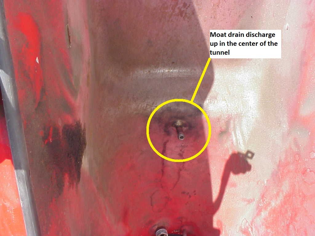

I can't believe I'm the only person with this issue.  I've never heard others discuss it.  1998 EV.  The fuel tank has a flush mount fuel cap.  Around the rim of that cap is a shallow moat.  If you overfill or spill fuel, where does it go?  When you ride in the rain or wash your bike, water gets into the moat.  Where does it go?  The tank has a steel drain tube running from the cap's moat area, through the tank, to an external fitting in the tank tunnel.  Attached to that is a simple drain hose to ground.  If water or fuel gets into the cap moat, it SHOULD simply drain to ground.
However, the tank's internal steel drain tube is small diameter and, in order to tolerate expansion and contraction of the tank, it is formed into a multi-coil within the tank.  Next time your fuel is low, remove the cap and look down inside to see the coil shape of the drain tube.
Now, when fuel evaporates, it leaves sticky residue.  Any dust, grime, pollen, etc. sticks to the fuel residue and eventually completely blocks the drain.  Now, if you ride it the rain or wash your bike, the water does not drain away but fills the moat.  As soon as you remove the fuel cap, some of it spills into the tank and then sinks to the very bottom.  It may periodically get sucked into your fuel stream and cause some performance hesitation.  More likely it will just puddle at the bottom of the tank and eventually rust its way out.
I am a firm believer that this drain system must be tested and verified every time the tank is off.  If you find it blocked, it can be cleaned out a la RotoRooter.  If you ignore it, it may become too blocked to get corrected.
Here is the fuel tank opening showing the tiny moat drain at the rear, center of the moat:
Here is the drain opening below the tank.  From here, a simple hose leads to ground:

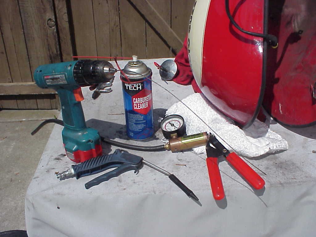

Unplugging the drain is VERY difficult.  You need the following tools:
Orient the tank nearly upside down so that the drain exit is the high point.
Spray some carb cleaner into the tube exit so that it softens any plugs and lubricates your roto rooter snake.  BE CAREFUL with the carb cleaner as it will eat your paint.  Pack some protective toweling up in the tank fuel opening.
Use the hand vacuum pump to suck on the exit tube in order to confirm if it is blocked or free.
Ditto with the compressed air gun and tapered tip.
For my roto rooter snake, I used a 13" piece of 1/16" bicycle shifter control cable.  Tin the very ends so they don't fray or unfurl.  I clamped 1/2" in the drill chuck jaws and was able to feed the entire remaining 12.5" into the drain until the chuck literally hit the drain tube exit.
The electric drill allows for slow rotation action while your fingers feed the snake up into the drain.  Go VERY slow or you risk having the cable kink and double-knot.
It is a very slow, tedious process but eventually I got the blockage free.
Afterwards, I force fed some carb cleaner in both directions to wash out yucky sludge.
I'll gladly do this for anyone in the SF Bay area.  Just drive your tank over here.
While mine is a 98EV, I have to believe this same drain function appears on any of the tanks with a flush mount fuel cap.  Easy to test.  Just raise the tank, disconnect the hose, connect your vacuum pump and give a few strokes to see if it holds vacuum or passes air.
