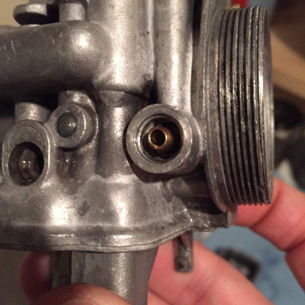

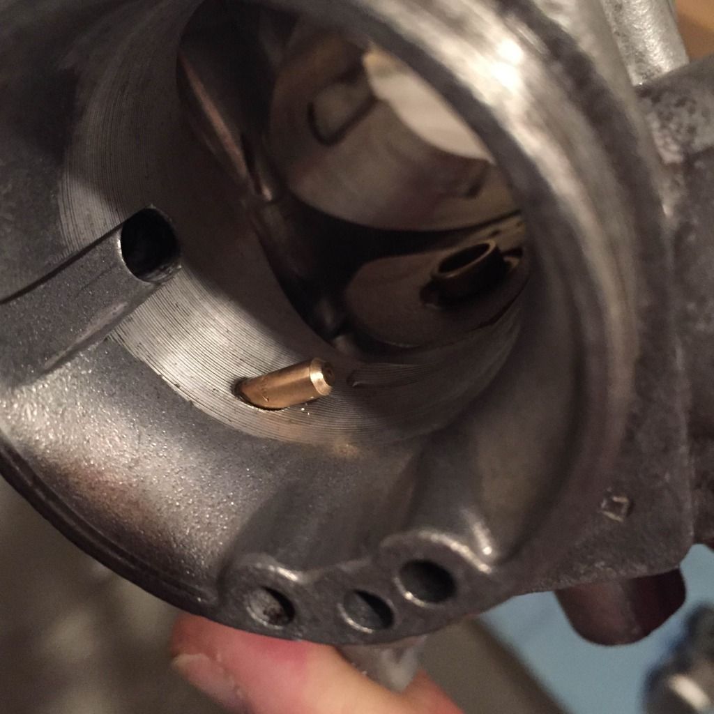

I'm cleaning /rebuilding carbs for a '78 Lemans.
I understand that there is an o'ring to get to at the pump jet (7 on the diagram). It seems to me that one should just press the jet from inside the carb.
I cannot get them to budge and am concerned about forcing the part too much. Any feedback would be appreciated.

That's right, after you remove the cap, it just pushes out from the inside. If it's stuck, I use a small piece of wood to save my fingers and hopefully get a straighter push.

You may need to soak the area with carb cleaner. I would not try to force it, it should push right out.

I am not sure if there is a flat spot on theses Jets. I notice that the slots in the Jets are aligned differently in each carb.
The Jets are stuck in both carbs. O-rings musta turned into some kinda cement.

Tried boiling. It's nice and clean but jet's not moving
Tried flame broiling. Still not moving - seems like alot of aluminum to heat up around the jet, I thing the brass jet is heating up just as fast.
Used a pair of plumbers pliers and some wood to press it out. I realised that the holder screw could be screwed on only part way to allow for movement of the jet, and to provide a surface for the pliers and wood.
Now onto the next.....
