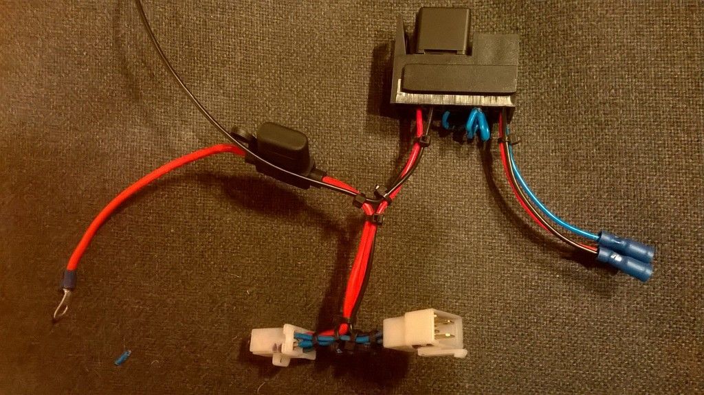

Tris, can you tell me what you did for startus interruptus?
Sure
I don't like cutting into any loom if I can avoid it so wanted a "plug and play" solution that I could reverse if needs be
Secondly I wanted an ignition controlled power supply for grips, GPS etc.
So I made this
The key bits you need for the stautus interuptus is the 2 white plugs and the red wire with the inline fuse.
The 2 white plugs are put between the existing starter relay and its plug.
There are 3 wires (I'd make these longer if I did it again) linking the 2 plugs together and the red one comes in to replace the yellow one at the relay end.
On one of the other forums it suggested using existing the now obsolete yellow as an ignition controlled supply which what I did to trigger the relay with the 3 fused circuits for the ancillaries
I hope that all makes sense
EDIT
Google "Sumitomo lock type .250 connector" for the white plugs - they're only a couple of £/$ for the pair.
It took me 4 months to track them down  :shocked: :shocked:

Since the yellow took the entire load before, it would seem that it could provide quite a bit of power for accessories (switched) perhaps degrading over time a little hence the need for the repair in the first place.
Correct?
Offline tris
  • Posts: 2898
  • Location: United Kingdom
Re: Buying a BREVA 1200 - Tips for 20,000k bike servicing essentials
« Reply #37 on: February 21, 2016, 04:45:44 PM »
Dunno about that NP
However the theory behind it (I believe) is that due to the circuitous route the juice takes to get to this point the voltage can drop off to such a level that there's not enough left to pull the starter solenoid in
Doing this makes sure the starter sees the full battery voltage
Go here for the full story http://www.guzzitech.com/forums/threads/modern-no-start-issue-solution.4908/
I feel that using the yellow wire to pull the relay in and using the same 20A inline  fuse to feed the starter and the ancillaries met with my wish not to mess with the standard bike wiring too much
« Last Edit: February 22, 2016, 12:22:04 AM by tris »
