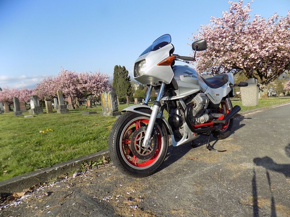

Around 6000 miles. (10 K) Some have made it over 20000, with strict observation of a 7K rpm rev limit. The problem is, power is still going up at that point, and past the 7800 red line. That's where the fun is.  :smiley:
Thanks again Charlie I don't know how I would have got on without your guidance with the Eldorado.
So it's way overdue to drop a valve then.
Seems like I should do something with the valves this winter.
I do know it has dual valve springs according to PO
I will follow the link you posted as time permits.
Re: Older Small Bores - One Followed me Home
« Reply #36 on: April 11, 2016, 04:32:22 PM »
Dawg here.
Bike comes with third-world valves/too tight springs-- they go BANG. People replace with third-world valves (made in China). Do yourself a service and pay a little more (non-Guzzi content) and get good valves (USA Made Kibblewhites are very good!) and lash caps. This will give your Lario a good start and a prayers chance. There's more to the story, so don't think a good valve train is the holy grail. Make sure you have the right cam. My biggest beef is putting two piece Chinese valves in a bike that's known to pop valve heads.  Again, it's a good start! 2-3 hundred more greenbacks and WILDLY unpopular.
Kevdog3019, thanks for telling me what I didn't want to hear, I think.
I will seek some good valves.
What are lash caps, do they fit on the valve stem outboard of the collets?
What about the valve springs do they need upgrading also?
I'm not one to hover around the red line, cam I extent the life by staying under 7k?
I will measure the tappets before I ride it again.
I'm sure the Chinese use top quality Melamine in their valves but I'd rather pay double and do it once.
Thanks
Roy

Roy, the Lario Rehab thread takes about 4 hours to go through, and will give you a good feel for the Lario.
Definitely. It takes a *lot* of fun away from the Lario engine, however. Kevdog has said he does this.
Valves are made in one of two ways. Most valves are two piece, friction welded about an inch or so below the head. This allows the head to be made of heat resistant alloy, and the stem to be made of a wear resistant alloy, a good combination.
Because of the Lario (and other small blocks) tendency to spit the head off the valve, some have experimented with one piece valves. That, at least does away with the join between the two dissimilar metals.
But. That requires using a lash cap. It is a hardened cap that fits over the valve stem to keep the rocker arm from deforming the end of the valve.
Yes, but there are two schools of thought on that, too. One is that the double springs are exerting too much spring pressure on the valve, possibly causing the heads to pop off.
The other is the springs are too weak, and not closing the valves rapidly enough at high rpm for heat transfer to the head, and the valves get too hot and drop a head.
 :smiley:
Got all that?
Ok. Significantly, in my opinion, when Guzzi upgraded the small block valve train, they used a single progressively wound spring. This is what is called the "Nevada" spring, and the modern small blocks use it and it is reliable.
Kevdog's engine was done by Ed Milich.. a racer. His 2 valve small block engines have been tough to beat. Back when I was going to Daytona, he was a regular winner. Kev's has higher compression, bigger valves, and heavier springs. All (except for the heavier valves) is designed to keep the valve on the seat longer because the mods make even more heat. That doesn't matter to a race engine that is only designed to go a few races between overhauls.
Is that the definitive answer to the 4V small block problem?
*I don't know* but my gut feeling is the stock Guzzi valve, which is not third world as Kev alludes to, is pretty good. Not as good as a Kibblewhite, but pretty good. That, combined with the Nevada spring seems to *me* to be the best combination.
Rod Yeomans RIP was a well known small block guy. I'd recommend looking at Greg Bender's site here:
http://www.thisoldtractor.com/moto_guzzi_small_blocks_older_small_block_issues_.html
All this should muddy the waters..  :smiley:
