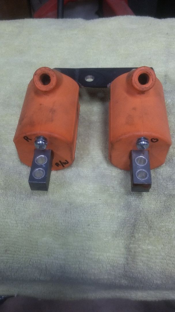

Hello Folks, I was checking the timing on my 85 LM, and I noticed one of the coils had at some point leaked out some of the epoxy from inside. These have been on the bike for about 3 years, and the bike is running great. Should I replace the coils since one has leaked? Is that a sign of impending failure? I read somewhere that some coils are "self healing" is this true? i measured the resistance across the 2 terminals, and it is 3.4 ohms. My LM has a Dyna III ignition, should I replace the coils with 5 ohm coils? These coils are orange in color, and have no label ,or identifying marks anywhere. Does anyone know what brand they might be?  any suggestions, and advice, mucho appreciated!

They look exactly like the Black Dyna coils I bought for mine. If they are not Dyna and you want to replace them, replace them with Dyna and not those crappy tin can coils.

Thanks, OMG, I think you are correct re the paraffin, I scraped it off, and it felt like paraffin, not epoxy.
