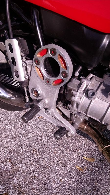

Offline Blueboarhound
  • Posts: 933
I finally got around to having mine switched out this week. Mounted right up.
Original Daytona 1000 Pork Chops and foot rests:
Retrofitted Sport 1100 Pork Chops and footrests:
No faults in the original pair I just got tired of my calves pushing them into the up position at stops. Since they're not sprung they stay up and I had to find them with my heel while in motion and put them back down. Sprung Sport 1100 footrests solve the problem.
