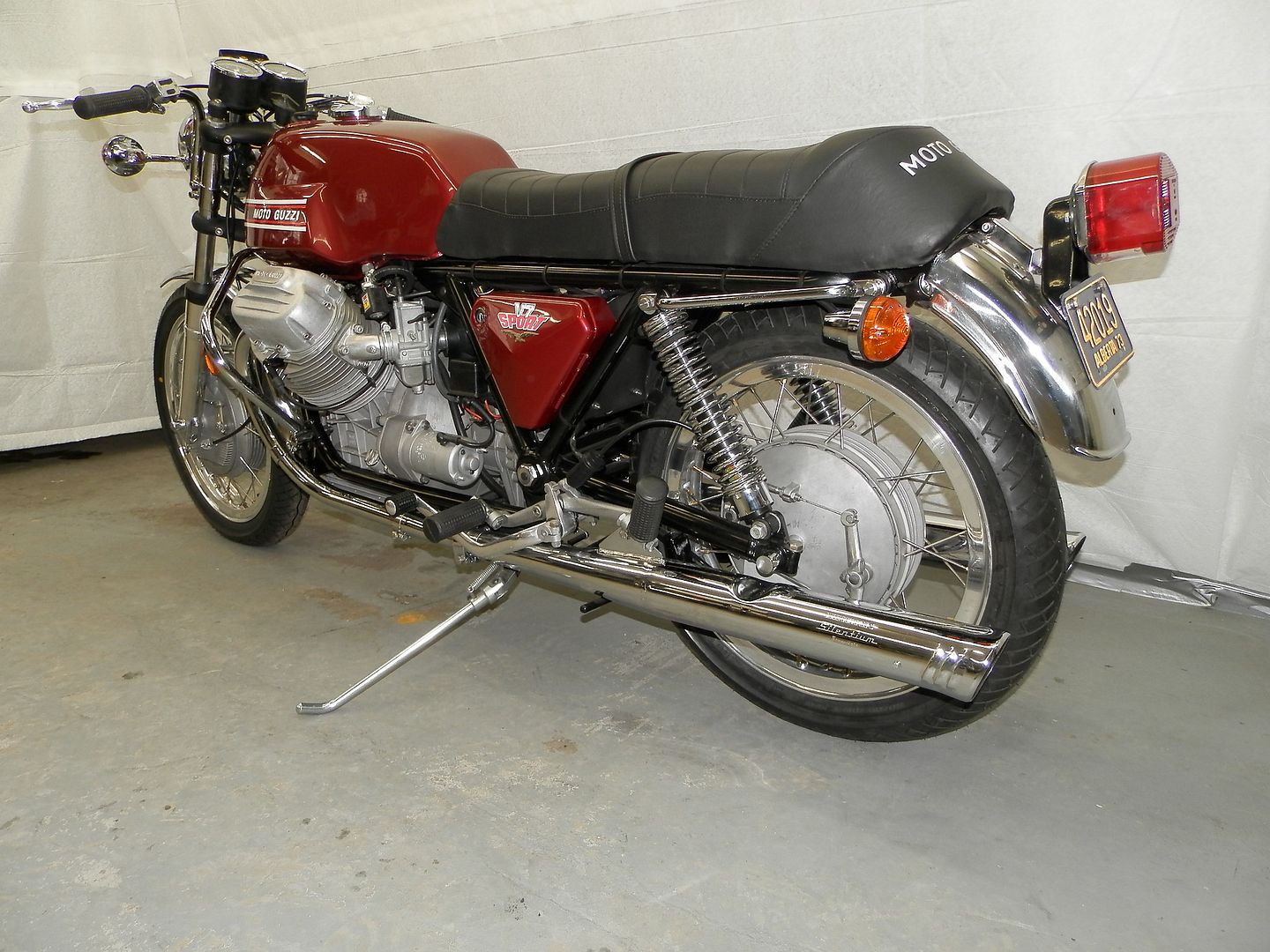

I have a Brown side stand on my V7 Sport and will be installing on eon my 750S as well. The mounting is hidden and the quality is super. Very stable stand.
Boxerworks sells them to fit the Tonti frame
http://www.boxerworks.org/new-parts/misc-accessories/brown-sidestand/

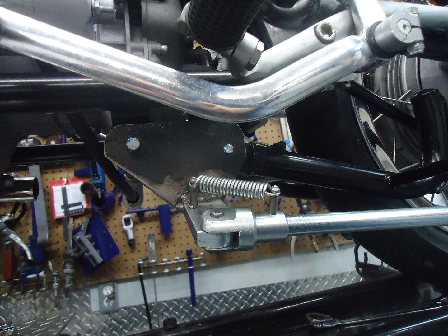

I worked with the guys at Boxerworks to develop the modified Brown for Guzzi Tonti frames.  The prototype is on my V7 Sport.  It's bolt on.  You need to remove the exhaust and run the rear engine mount through the tranny from right to left.  Same for the laft center stand bolt.  Each gets threaded into the mounting plate on the stand.  I did a photo tutorial of my installation if you search this forum.  They're expensive, but so is your bike's bodywork.  Piece of mind!
