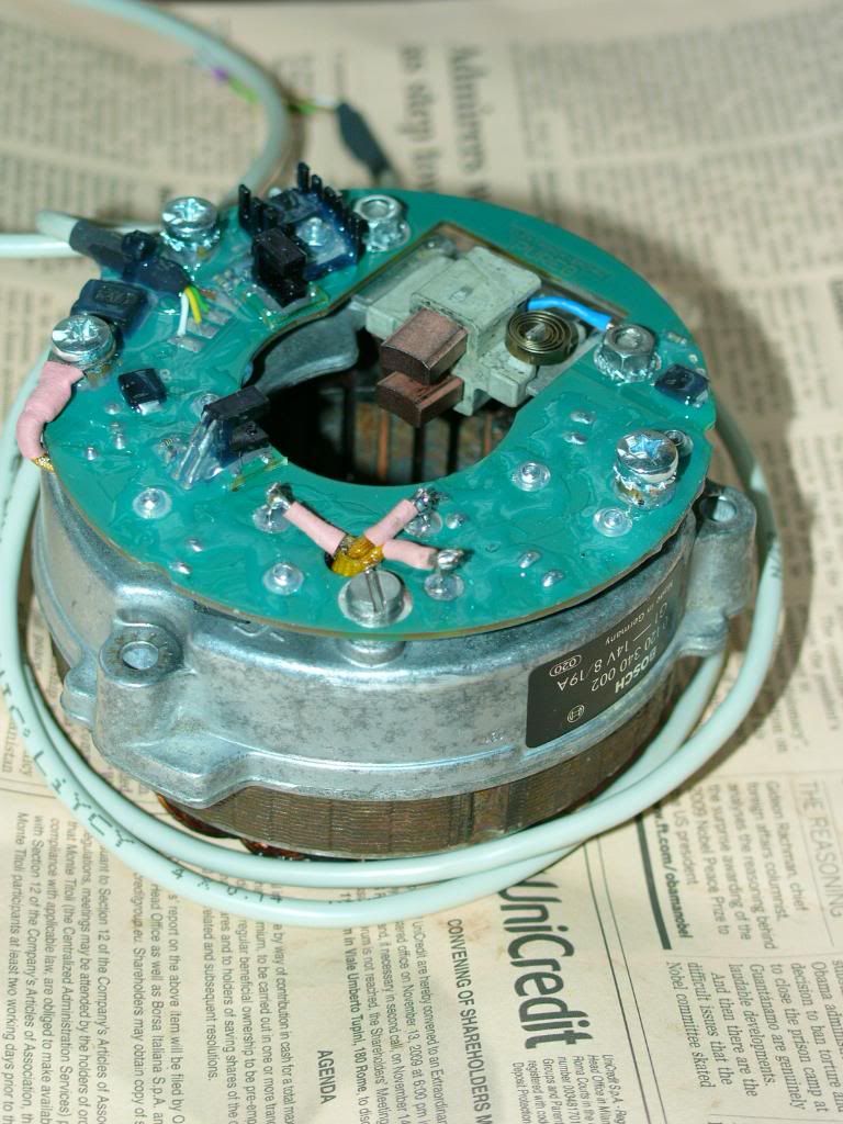

I have the ZDG3 but with the diode reg/rec board too, the PUReg. This is the same system but with a different board for the triggers that mounts to the stator. Mine just went straight on but as I said different board.
I've probably done around 4K miles on it and have never had to touch it, IMHO its a very good system.

Offline Old Jock
  • Posts: 2655
Re: sachse ignition
« Reply #7 on: June 03, 2016, 08:15:39 AM »
Found a picture of it off the bike when I was installing. My only complaint is it may make replacing brushes a tad more complex, but I can live with that
