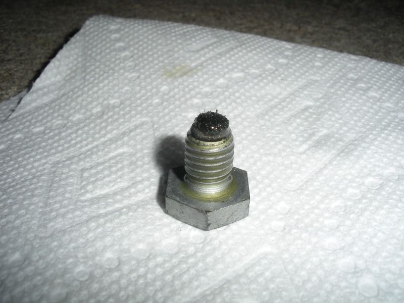

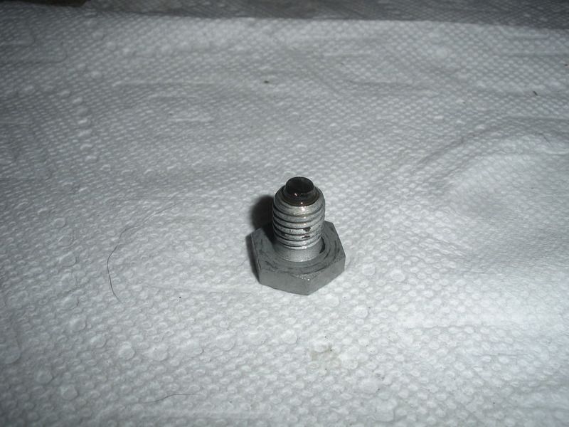

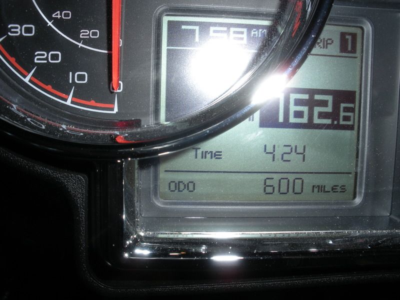

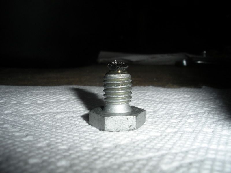

I rolled into my garage with 600 miles on the clock and started draining fluids.
The CARC drain plug magnet has what I thought was a normal amount of fuzz.
The transmission drain plug magnet looked about the same.
The engine drain plug magnet had very little fuzz which is what you should expect.

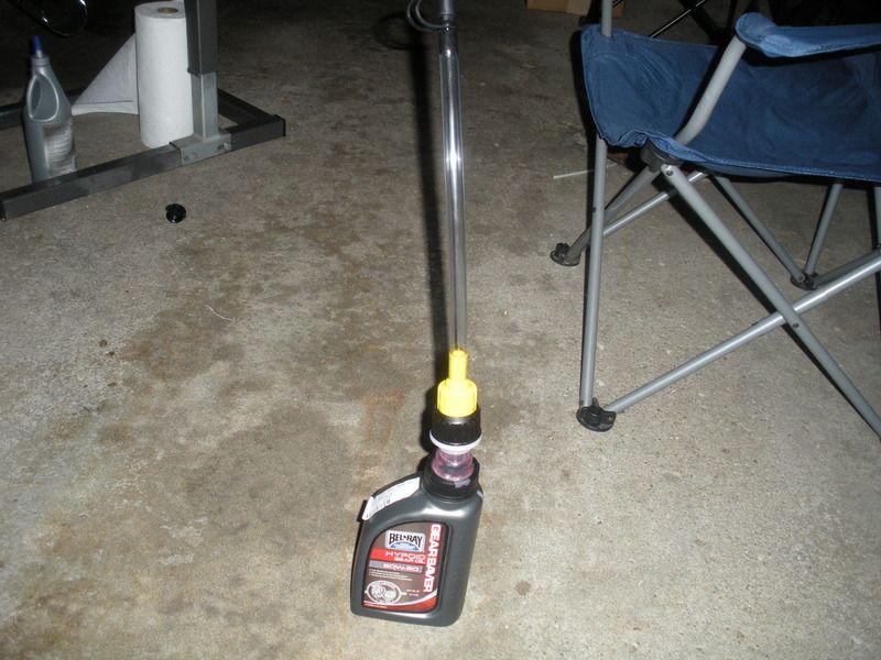

Filling the trans and CARC was easy with this little screw on gadget.
Filling the engine was no muss no fuss with this pump set up.

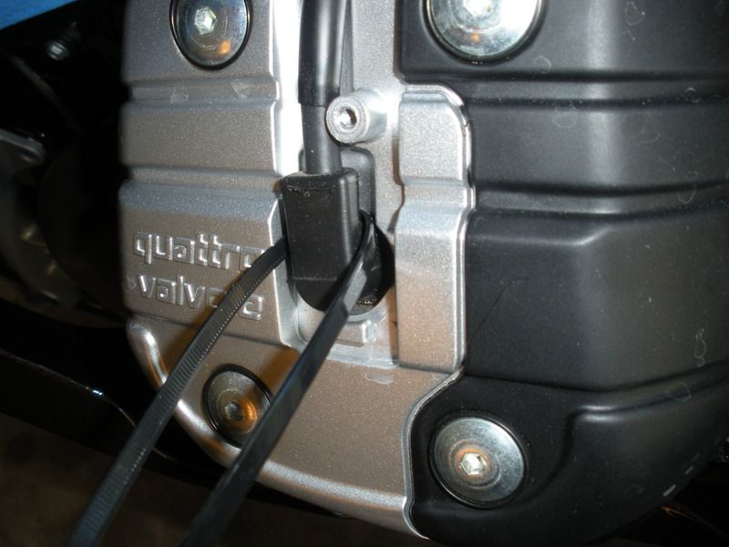

Pulling the infamous spark plug boots was easy with a tug on this tie wrap that I looped under the boot.

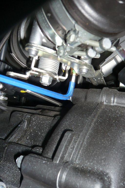

Checked the throttle body sync with my Twin Max and it required a bit of touching up.  The idle balance needed touching up also.
Then I reset the TPS with GuzziDiag, and reset the learning parameters, put the lower plastic back on and went for a ride.   SWEET!

Actually it's a 1,000 mile service, you will need code 28315 to reset the 'wrench' at 1,000 miles.
I did the same, had first service at 600 miles.

Dang, I have not seen the oil pumper gadget, that is pretty cool! How do you track how much has gone in (or that you have pumped enough)?

Rboe, the graduations on the Motul jug were pretty accurate.

Just a quick word of caution Dave, where you were pulling the spark plug cap from is where they generally crack and leak electricity to nearby metal parts. (Right on the underside at the angle.)
Prior to replacing my caps on the Stelvio, I did something similar. I used a Ty-Rap around the body of the boot just below that, and put another tie as a loop sticking up through that. That way, you're pulling from below the angle part. It was still a pain, but I didn't have any trouble with a cracked boot.

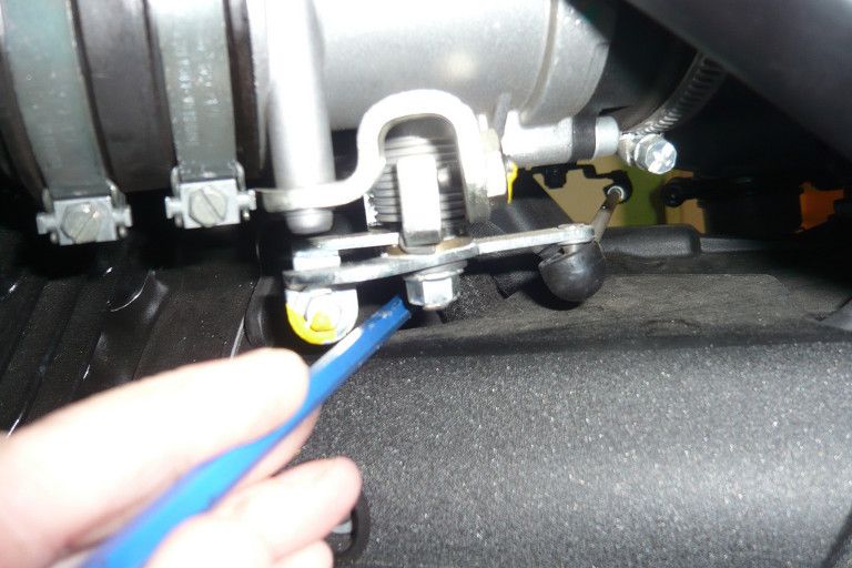

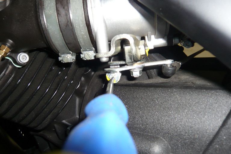

Dave, I noticed in your original post you mentioned that "The idle needed touching". Just wondering what you did to adjust that.
Bad nomenclature reference on my part!  My old school is leaking out!!  No I did not go near the sacred screw!!
Instead should have said air bleed screws.  As part of the tune up process the throttle bodies synchronization (balance) must be checked.
The following is copied from Pete Ropers How To.  I am sure Pete's article is on WG somewhere but I haven't been able to find it.  I did find it over at GrisoGhetto.
Before the 4,000 rpm balance can be checked the air bleed screws must be closed.  These are located under the throttle body tubes.
RH
LH
Then hook up your manometer of choice.  Hook up GuzziDiag start the bike with a decent sized fan blowing on it and let the engine temp come up to 60F.
Run the engine up to 4000rpm and check balance.  If you have a Throttlemeister or something similar they are a great help  if you are doing this solo.
If the 4K rpm balance is out you will touch it up with the bellcrank adjuster on the left side.  My bike needed a minor adjustment.
Shut the engine off and check TPS with GuzziDiag it will probably be off if you had to make an adjustment.  If off from the 4.6 to 4.8 reset TPS with the Guzzidiag Actors function.
Now the idle balance needs to be checked.  If one side is pulling more vacuum than the other on your manometer that is the side that will need the air bleed screw opened up.   My LH screw needed less that a 1/4 turn out to balance at idle.
Thanks Pete, hope you don't mind the plagarism!!
John Henry
John, thanks for the information.  My boots popped off very easy so I am sure no damage was done, but will keep it in mind for the future as they might grab hold more as time goes by.

Don't be surprised if you have to replace them after taking them on & off a few times, the stock caps are pretty fragile. I've found the best method to get them off is levering them off from the bottom with a long thin screw driver inserted through the air channel in the back of the head.
