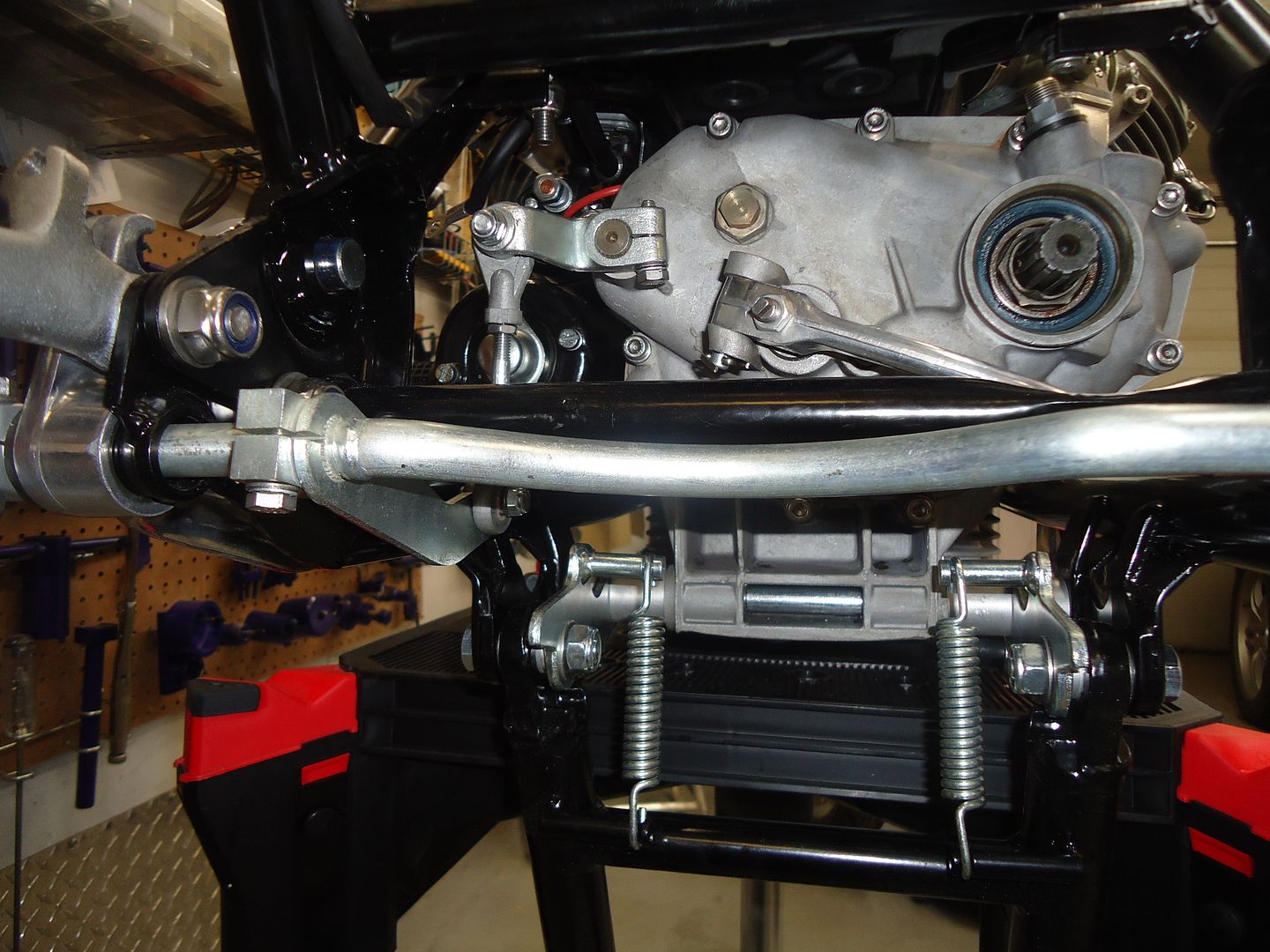

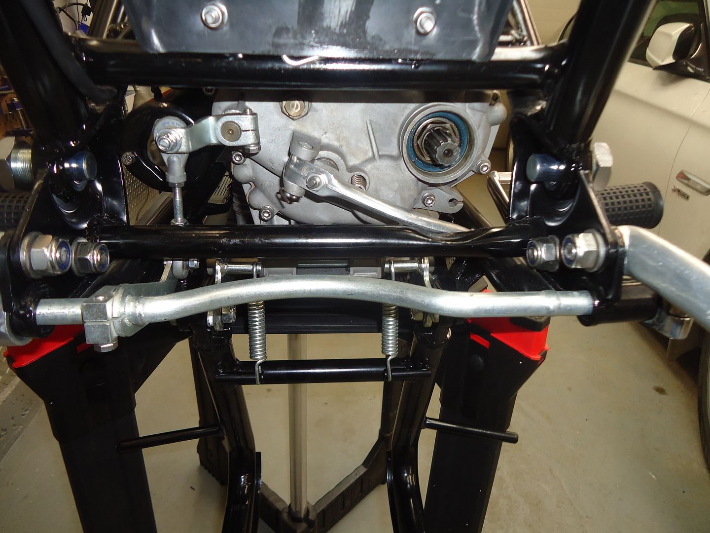

Brake side looks easy. The shaft end is already exposed and there's a clamp on it. Looks like it just needs the right pedal.
Shifting looks trickier as the crossover shaft doesn't extend out. Maybe this is where the 7 shifter will work.

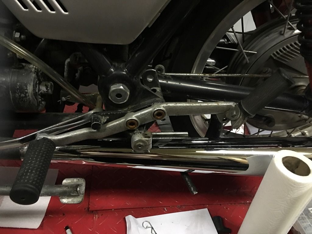

[/URL]

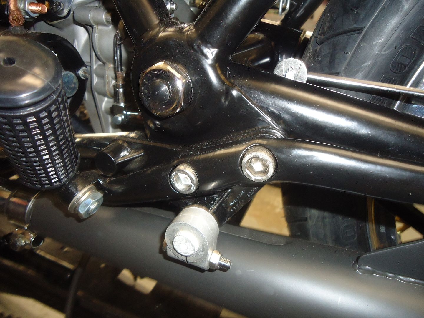

Is the bracket that holds the footpads suppose to be black? Were folding footpegs an option?
2001 V11 Sport
Re: Right shift 850T
« Reply #8 on: July 27, 2016, 02:03:58 PM »
The pictures are of a 750S, it came with black folding foot pegs like the V7 Sport. The foot pegs from the 850T, T3 are a little different riders peg more foot forward.
