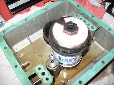

While it is most likely the sending unit (did you just happen to wash the bike recently or ride it in heavy rain), it is good/cheap/easy insurance to inspect your internal oil filter and add a hose clamp for security.  I have found loose filters.  It will look like this:
or this:
or this:
