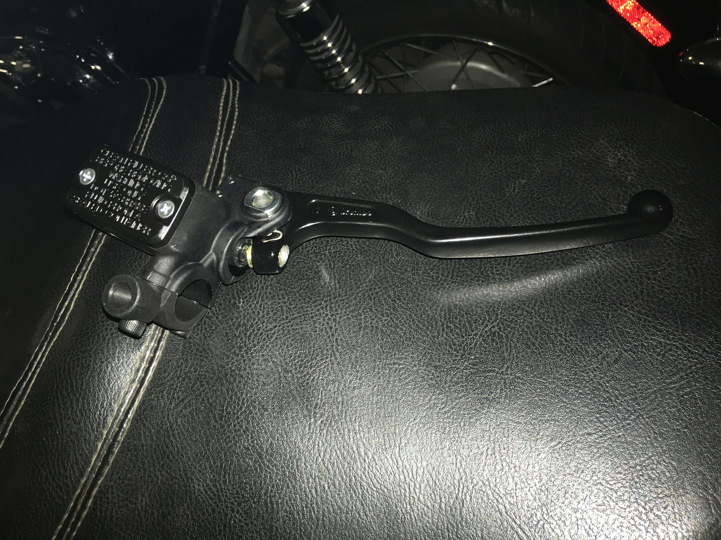

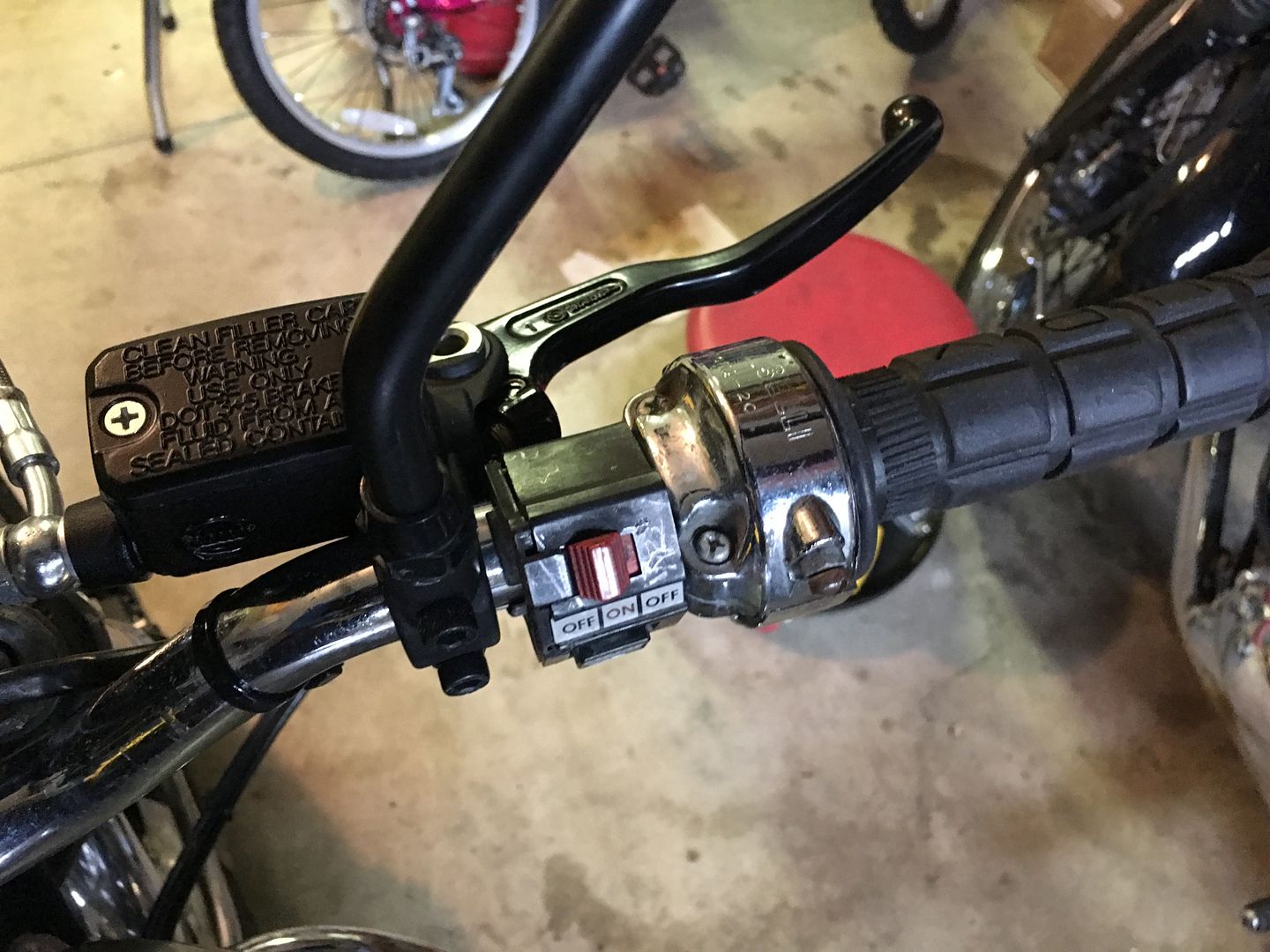

I'm getting tired of the rock hard brake. I don't think it really needs dual disks so the cheapest option is a new master cylinder.
I was going to order from MG Cycle but I went with Bevelheaven as they are closer and a few bucks cheaper on the Brembo stuff. It shipped on Friday and I got it today. Not bad.

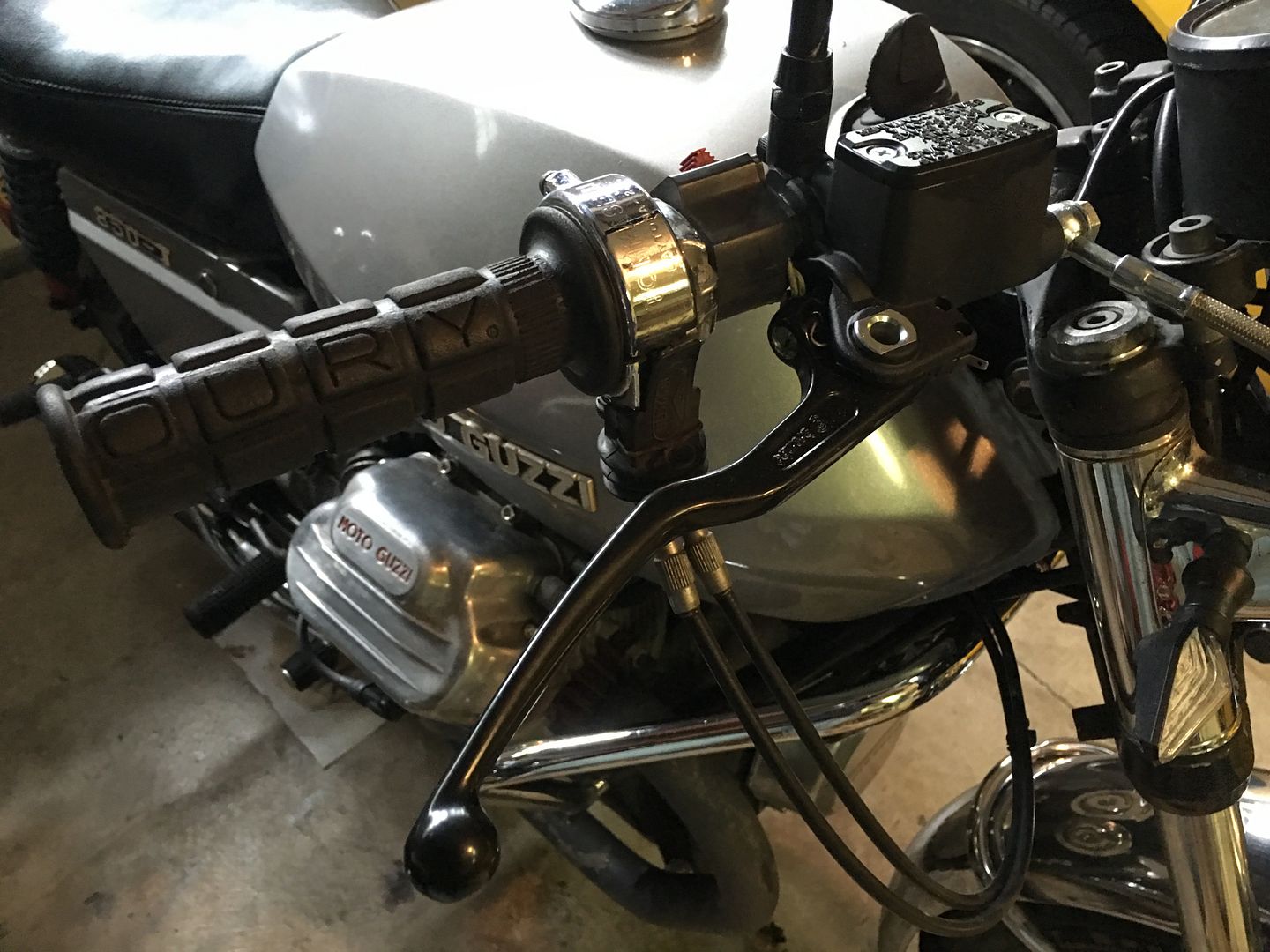

Installed the new master cylinder. It makes a huge difference. What felt like squeezing a brick now feels like a brake. It does pull back nearly to the bar which might mean more bleeding or maybe that's the way it will be. I have the lever clamped back tonight to see if that helps.
It's now a one or two finger brake with excellent modulation. I don't think for most riding a second disk would help. That being said if I add a second disk I'll just put the original master cylinder back on.

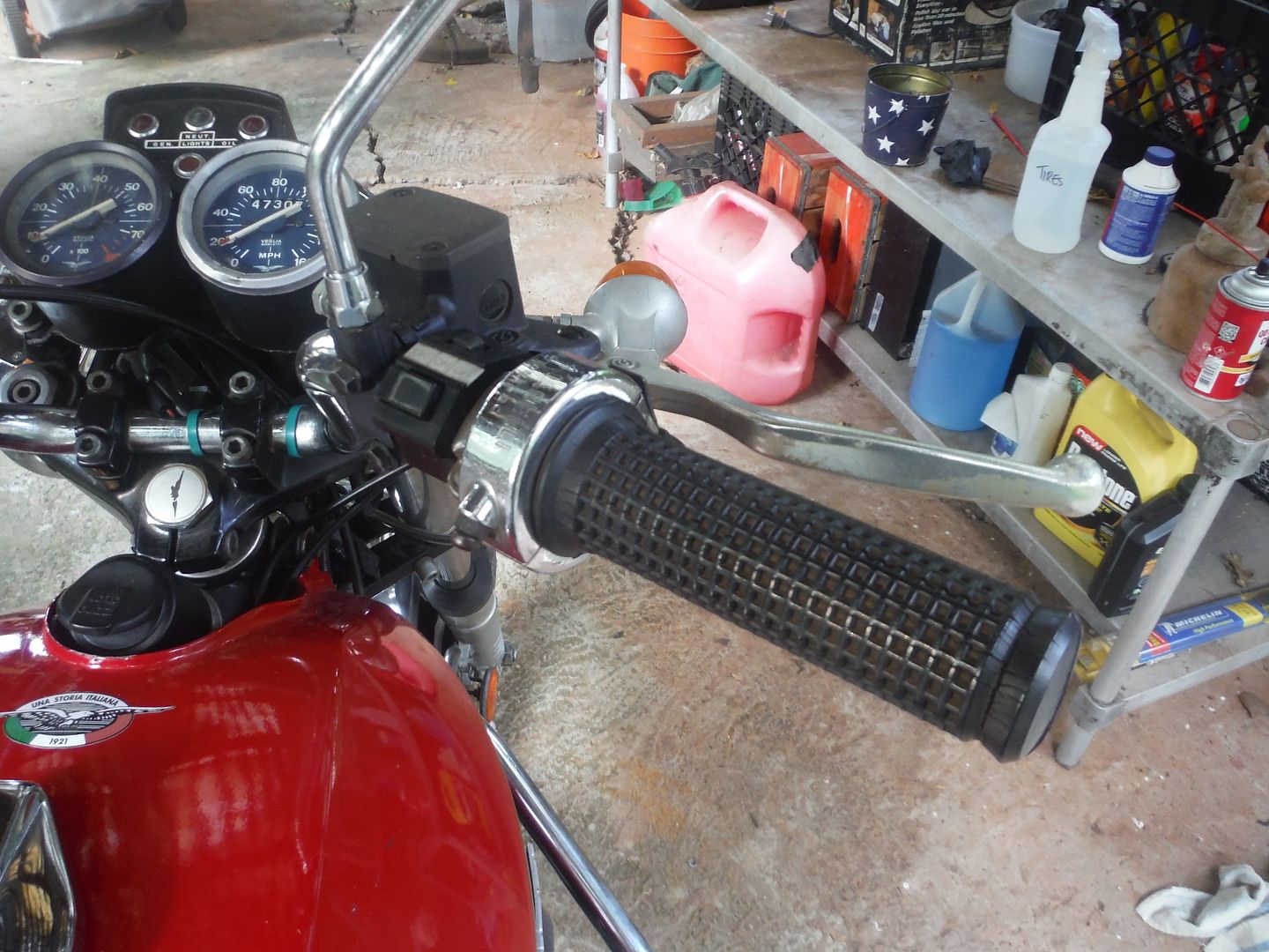

Here is what I put on - works great -
BTW what are those grip you have?  I have the old waffle style and it kills my throttle hand - makes it hurt to keep the throttle open on longer trips.

On/Off/Start all work although switch is falling apart.
I believe the ignition switch on the 850T doesn't work with the starter but it did with earlier bikes. I suspect it can be modded but I haven't looked into that yet.
The grips say DURY on them. They are pretty soft. Seem to work ok. Still trying to find out why they used such stiff throttle springs. I assume so your right arm would get as big as the left because the clutch is a pain too.
I'm going to look into getting lighter springs or bigger arms.

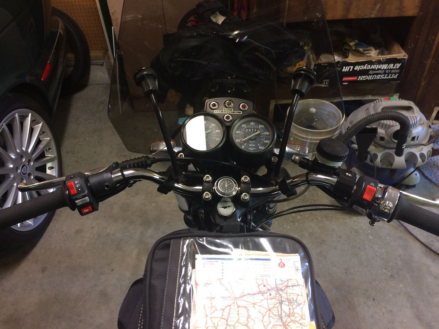

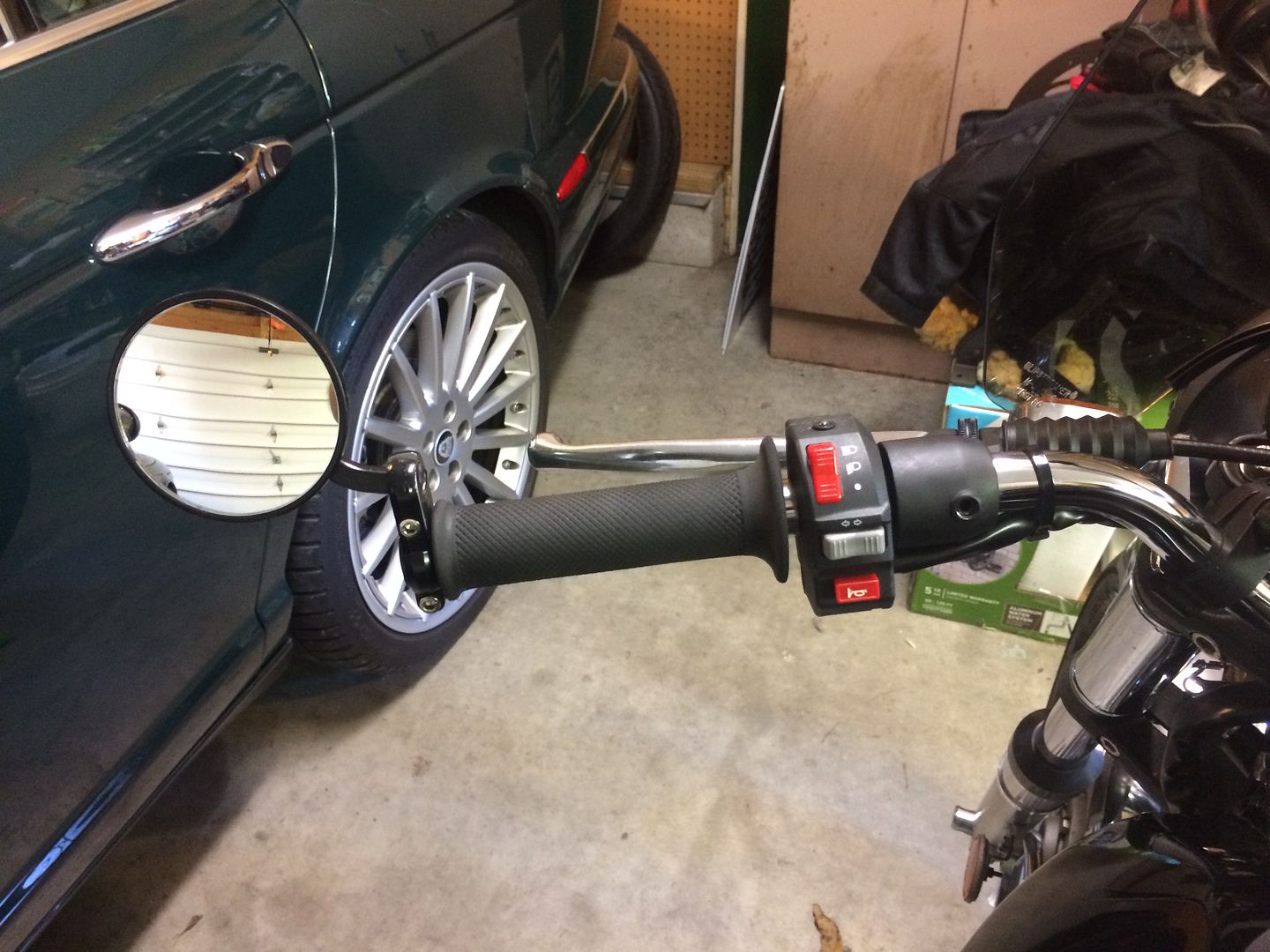

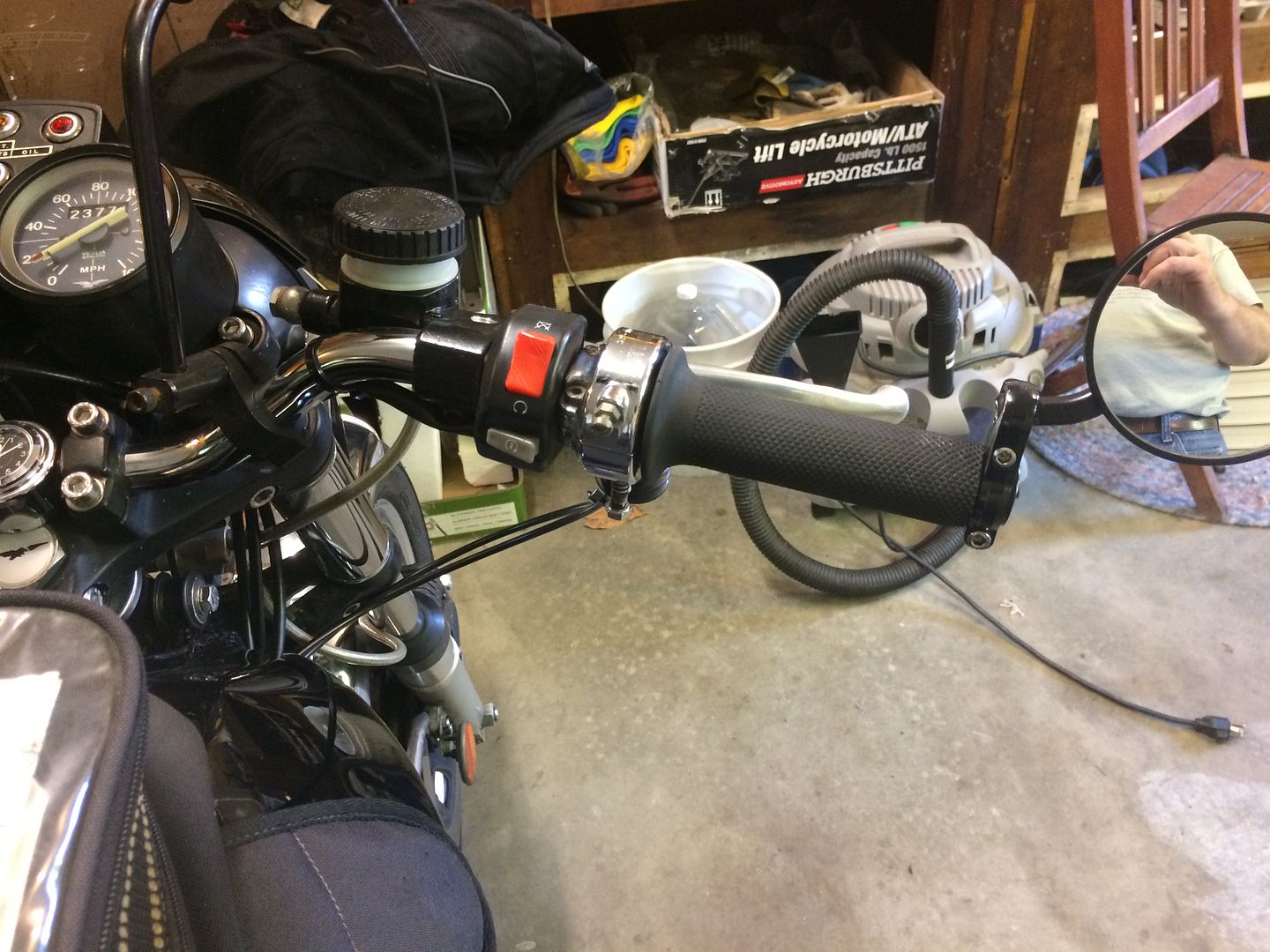

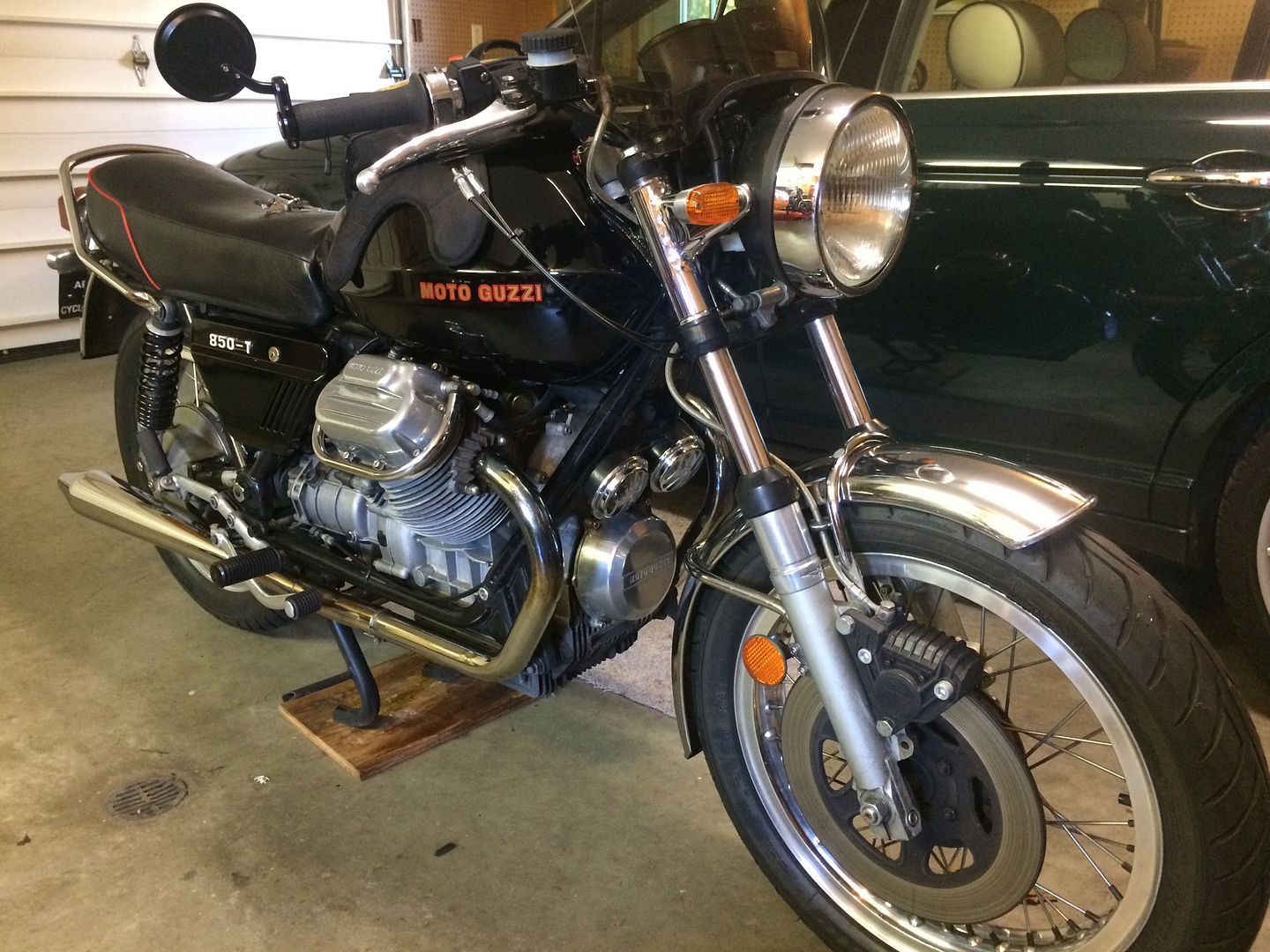

Here are some pics of mine after I modified my handlebar controls, switches and master cylinder last winter.  Parts were purchased from MG Cycle.  I sent the new switchgear to Greg Bender who cut the wires to length and installed the correct molex connectors.  Perfect fit!  And much more functional.
The master cylinder is a 12mm unit and coupled with braided steel lines, F09 caliper and HH pads.  It's now a truly one or two finger brake with great modulation - a joy compared to the old one!
Nice!
Where did you get the handlebars?
I have some of those mirrors which will need to go on soon.
2001 V11 Sport
Britcheflee
Re: 850T Master Cylinder Swap
« Reply #12 on: August 31, 2016, 12:06:00 PM »
About to ask the same thing - love the handlebars (kinda look like the ones which were on my Ballabio) - where did you get the mirrors and how do they work for you?
Lee
KAWELL® Universal Round Bar End Convex Mirrors For Inceased Vision For 7/8" Handle Bars Fits Most Harley Davidsons, Suzuki, Honda, Kawasaki Cruisers, Touring Bikes, Sport Bike, Cafe Racers, Electric Scooters side rear view mirrors motorcycle https://www.amazon.com/dp/B002GTKAHQ/ref=cm_sw_r_cp_tai_ggXXxbXZH8NGC
Lee
The handlebars are Emgo Superbike bend. I got them from one of the big online retailers (Bike Bandit, Revzilla or Motorcycle Superstore, I can't remember). They are just a tiny bit wider than the Euro bend bars they replaced.  They also have enough room for the new mc, switches and throttle/clutch assemblies.  Very comfortable!
The bar end mirrors are el cheapo (Guzzi-like) eBay items (queue snapping suspenders). Think they are less than $20 pair and work well.

They say OURY on them.  http://www.ourygrips.com/
http://www.ourygrips.com/road-street-grips/
They sure do. Isn't that's what I said?  :boozing:
