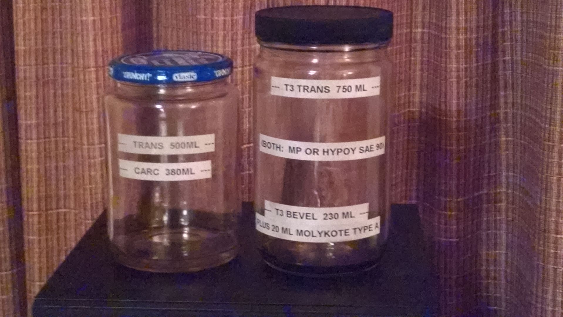

You can find a variety of good oil-measuring devices in an auto parts store that have metric markings.
But I have a couple of pickle jars that I marked for the exact volumes needed for my transmission and bevel drive on both my bikes. I just filled them with the correct amount of water using a kitchen measuring cup, and marked them on the outside, indicating the cc's. Two jars, each with two marks, make a set for my two bikes. Save time, and easy to keep clean with the screw-on lids.

Moto
Re: Measuring Liquids and Torque Wrenches
« Reply #23 on: September 12, 2016, 09:30:07 PM »
The left jar is for the transmission and CARC of my Griso, and the right for the transmission and bevel box of my T3.
In defense of my jar system (which I mentioned earlier)...
1) cheap! (free jars with every set of pickels)
2) easy to clean, since you can fit a sponge inside
3) easy to keep dirt out of, since they come with lids
4) self-documenting, as you can see, using label tape
5) using wide mouth jars reduces the problem of oil adhering to the walls of the container*
Against my system:
1) It's hard to get the labels on exactly horizontally, in my experience. (The dashed lines at either end indicate the correct levels.)
2) Subject to breakage
Moto
P.S. After measuring, I use a syringe or a funnel to put the oil in, depending on clearance.
*Elementary calculus shows the area of the sides and the bottom of an open-top cylinder is minimized for any given volume when the diameter is twice the height. (Not when it is equal to the height, as for a cylinder when including the area of both a top and a bottom.)
