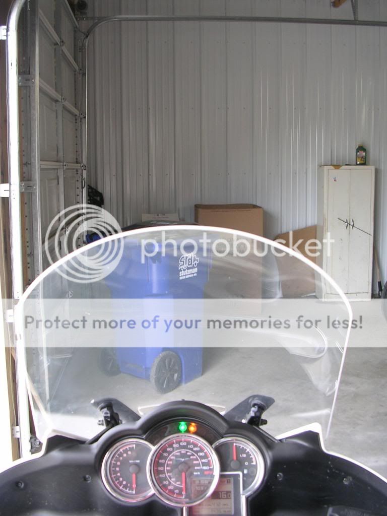

You might consider the California Scientific medium height screen. These two pictures are from my Norge with the screen in the lowest and highest position. The highest setting has me just having to look through it. I am 5'10".
It flows air very nicely at any setting. Been very happy and they are less than $150.
