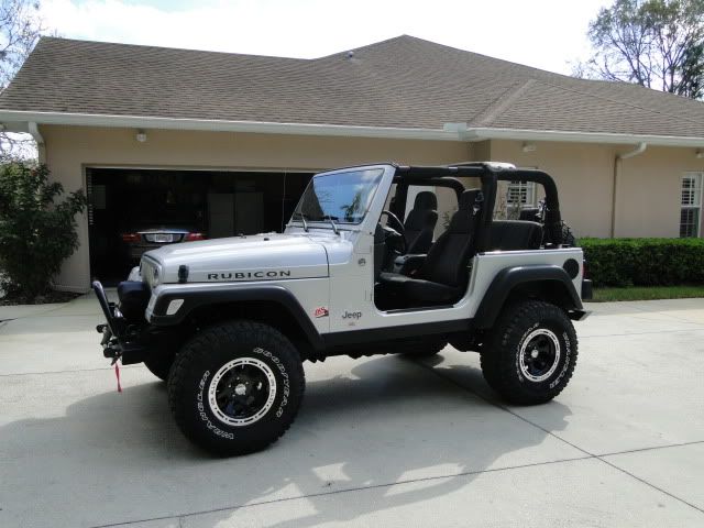

I've been looking at sidecars and talking to people who own sidecars for a few years now.
My Holy Grail would be a hacked Quota with a mounting step because Quota's are so tall
Yet the more I think about it I'm probably better off taking the hard top and doors off my jeep, driving it and not worrying about the difference in gas mileage.
not mine but very close to it
Mark
Just like sitting on your couch watching racing with a fan blowing in your face. Its like you're almost there!
