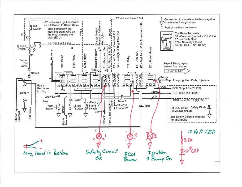

Re: 98 EV intermittant no start
« Reply #16 on: March 05, 2017, 10:38:36 PM »
A light on the petcock fuse No 1 will let you know if the power is getting half way to the brain, now you know if problems is before or after that point.
Another small light No 2 on relay 5/87 will let you know you have power going to the ECU
Light No 3 will let you know if the Coils, injectors and pump have power.
Break down on the road, no worries just hot wire the petcock with 12 Volts and the bike should start, may have to hit the start relay 87 contact with 12 Volts to engage the starter then fix it when you get home.
There's a ship load of wiring that will disable the EV but no excuse for having to get a tow without trying to get going. The wiring is 20 years old, try and be ready for when it breaks, learn how to bypass stuff while you are in your comfy garage not on the side of the road.
