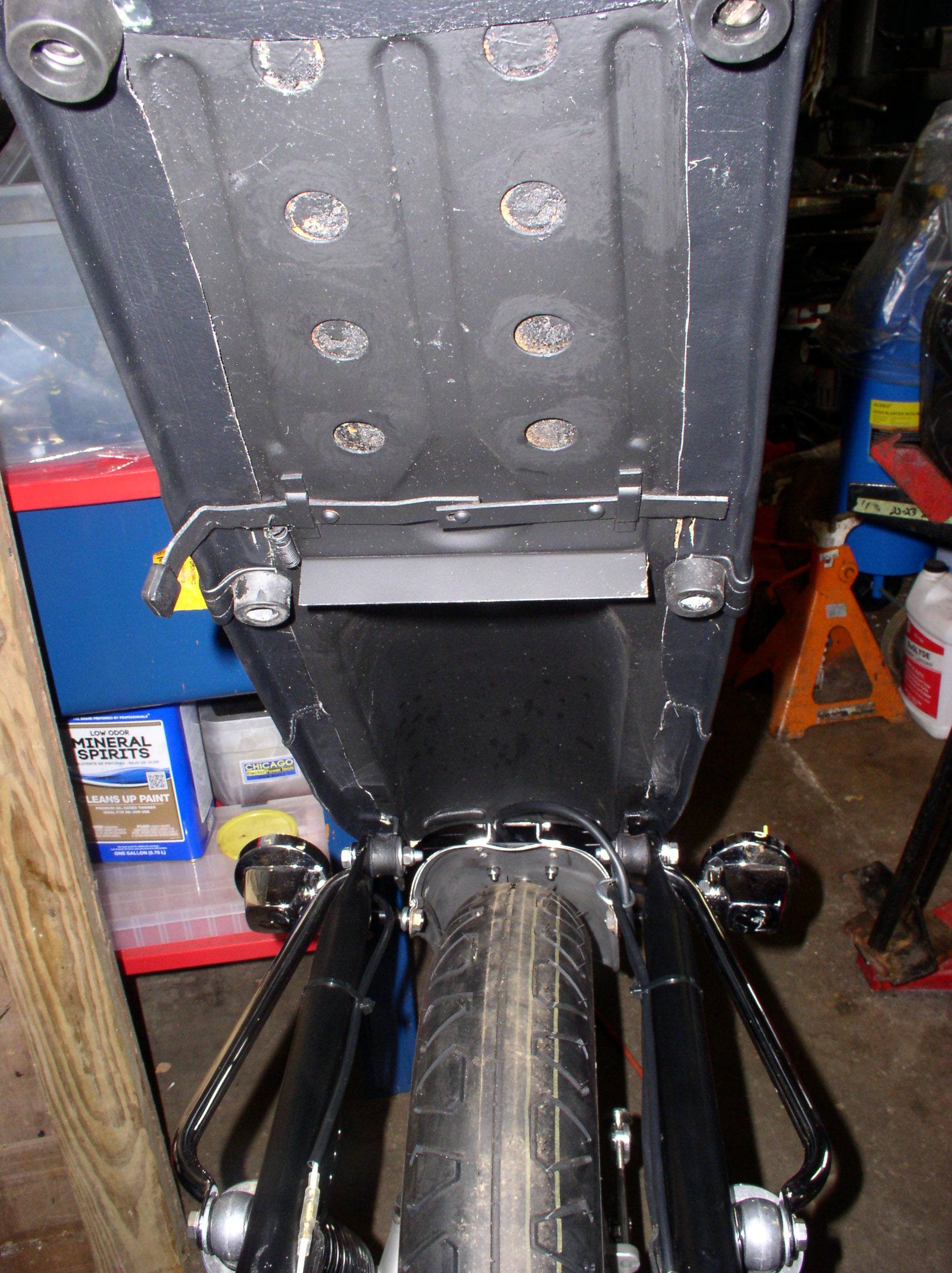

« Reply #12 on: March 30, 2017, 05:39:38 PM »
So the fender from mgmark arrived today. You may remember it from here: http://wildguzzi.com/forum/index.php?topic=82950.msg1310577#msg1310577
I removed my original T fender and stored it away carefully (i.e. threw it on a shelf) and got this new one on, at least for a test fit.
I have a long list of hardware to purchase (will head to my favorite store, Tacoma Screw, in the morning).
I believe the original V7 Sport fenders probably had a nut welded to the fender and a knob to facilitate easy loosening.
I'm not sure what I'm going to do here as Mark didn't quite finish this fender. There are ears coming down but they are pretty thin. It looks like he just used the knobs and some nuts. Maybe that will work. Maybe wing nuts on the backside might help?
[/url]
What I can't figure out is how the wiring is suppose to look on a V7 Sport. It has to accommodate the fender that fold out of the way. How did they do this?
2001 V11 Sport

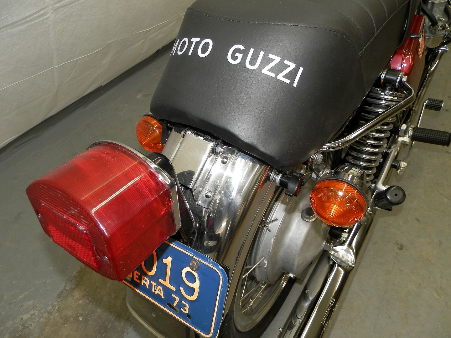

Re: V7 Sport Rear Fender Options
« Reply #13 on: March 30, 2017, 08:26:08 PM »
The stock V7 Sport rear flip up fender has a bracket riveted to the top surface, the wire sub harness passes though the inside of this open ended bracket to supply the tail light.
The signal lights are frame mounted and the signal sub harness is zip tied to the rear frame rail extensions.
750 S3 signal lights
« Reply #15 on: March 31, 2017, 09:19:52 AM »
Thanks!
From my research it looks like you have to undo the bullet connectors to the tail light every time you want to raise the fender? Or is there enough wire that you don't?
On the 750S does that mean about 5 wires?
I'll make some of those turn signal brackets if I decide to put them there.
No, there is lots of slack in the harness to allow the fender to tip up.

Offline swooshdave
  • Posts: 1303
  • Location: Portland, Oregon
« Reply #20 on: March 31, 2017, 11:53:52 PM »
Ok, I have it all together and the tail light and brake light work. I'm declaring victory, for tonight. When I go in and sort out the turn signals I'll re-wire the back end of the bike. The PO had some "questionable" wiring choices, like, ahem, using only one color of wire...
55mm bolt going all the way through.
Knobs and wing nuts to hold the fender. Works surprisingly well.
Final, well, for tonight, look. Sorry for the poor lighting, it's 10pm and I'm getting tired. I have a club event tomorrow (N@rton) so I will get a better picture. I don't like how the wiring is so I'll fix that later. But the electrons are going where they should.
Thanks to everyone who helped!
