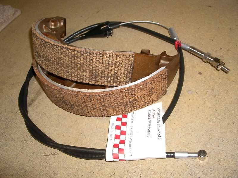

Here's a photo of "Classics" lined shoes.   I made the mistake of running a finger over the surface when I got them and promptly cut my finger.
