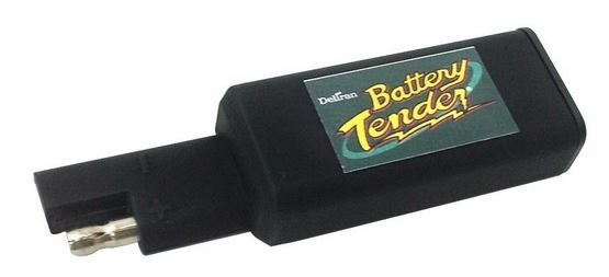

Thanks everyone for the replies. Malik mentioned the car plugs in a pm too so I'll have a look but if this is 12v then it will need something to convert it to usb 5v wouldn't it? Sorry for the newb questions.

Do as Zoom Zoom suggests (and what I do too) is cut off the connector and replace with the defacto motorcycle standard aux SAE connector.
Then you'll just need one of these:-
https://www.amazon.com/Battery-Tender-081-0158-Disconnect-Charger/dp/B00DJ5KEF4
« Last Edit: June 28, 2017, 11:15:45 PM by Kiwi Dave »
