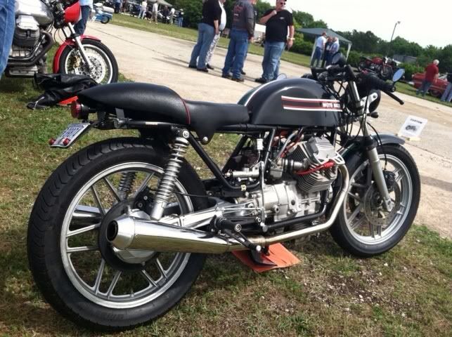

Welcome.
They do make a nice simple light-weight cafe project:

@wrbix - that's beautiful, exactly the cleaned up (if not needed, throw it out) look I'm going to try and achieve!
