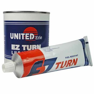

For gaskets in places that come apart on a regular basis like sump & rocker cover, I really like this. Oil & fuel resistant, helps to seal and prevents gasket damage on disassembly + no scraping.
https://www.aircraftspruce.com/catalog/cspages/ezturnlube.php
