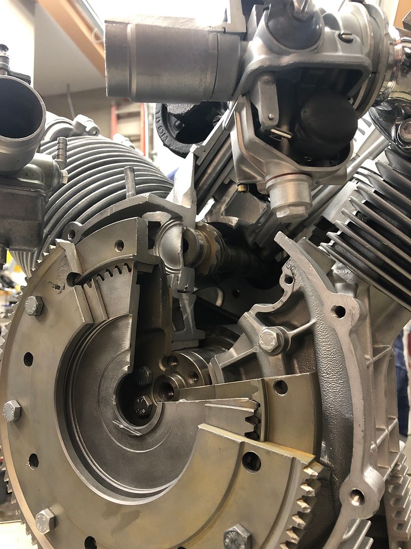

Made another deep cut, maybe too much chopped out, oh well can't undo it... I am impressed by how tight the Guzzi castings fit, even where they are not a sealing surface and they sure didn't spare the alloy, the block walls are seriously thick! I am out of sawsall blades and my band saw blade is done.

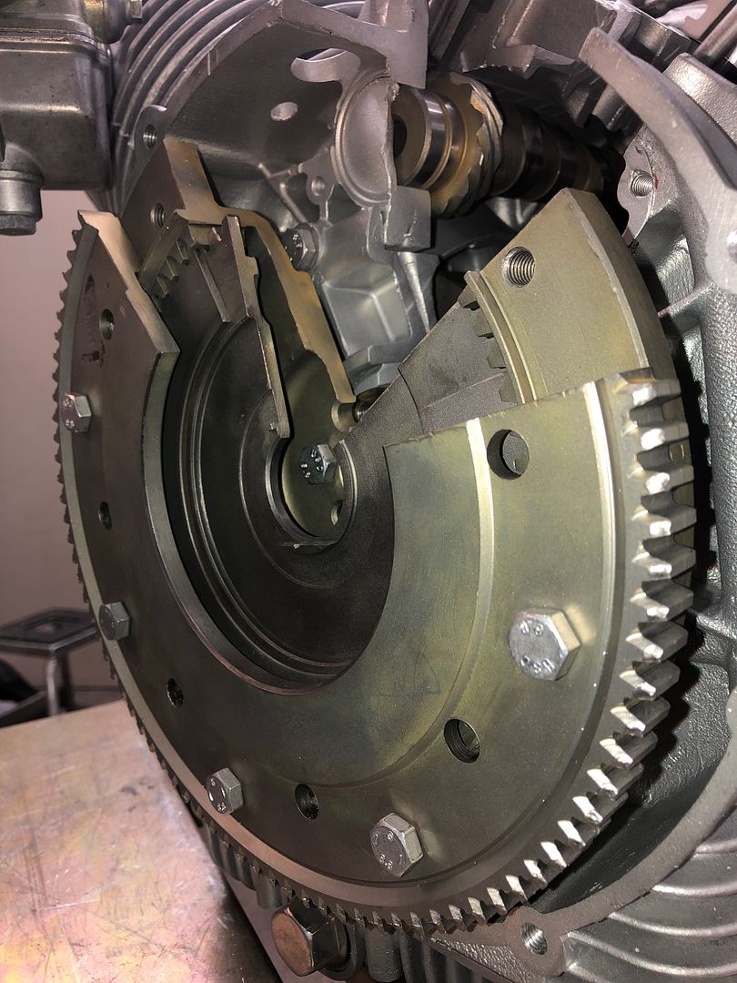

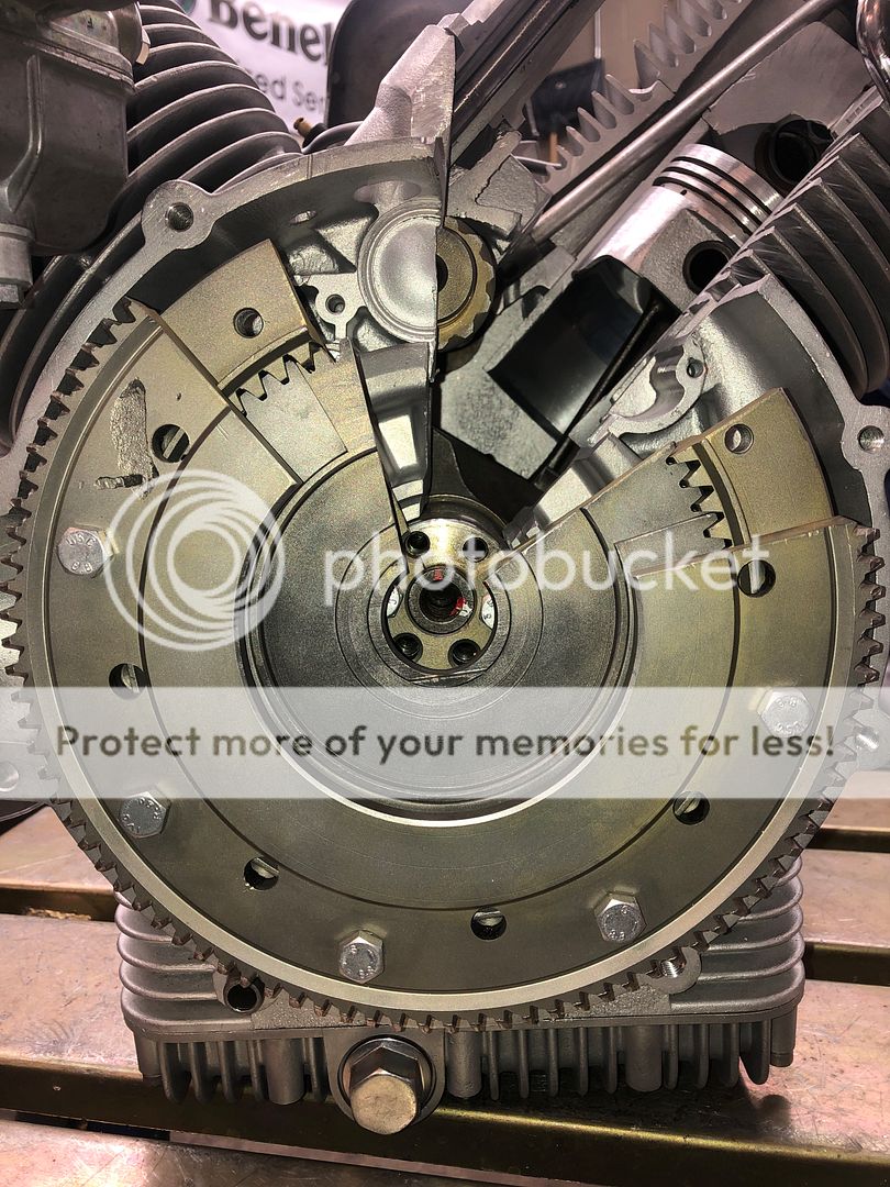

Chopping through the flywheel and ring gear should prove interesting, cut off wheel or band saw??

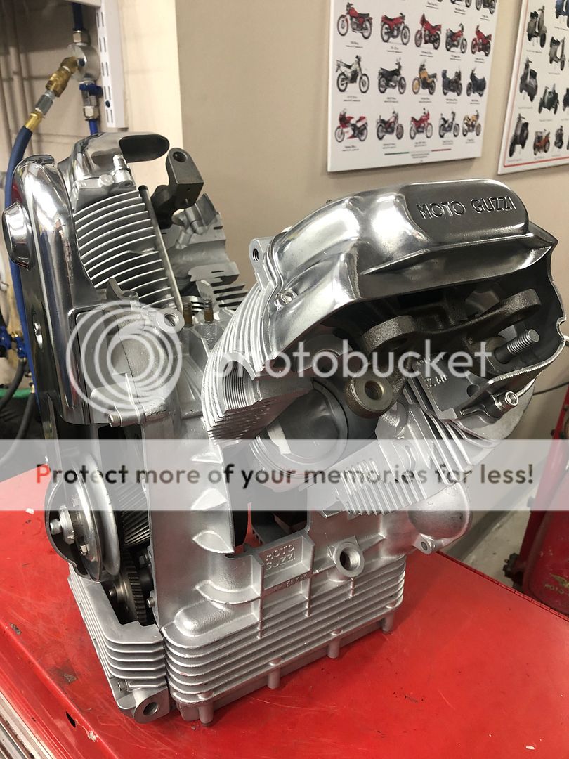

Cut the rocker covers and the font covers

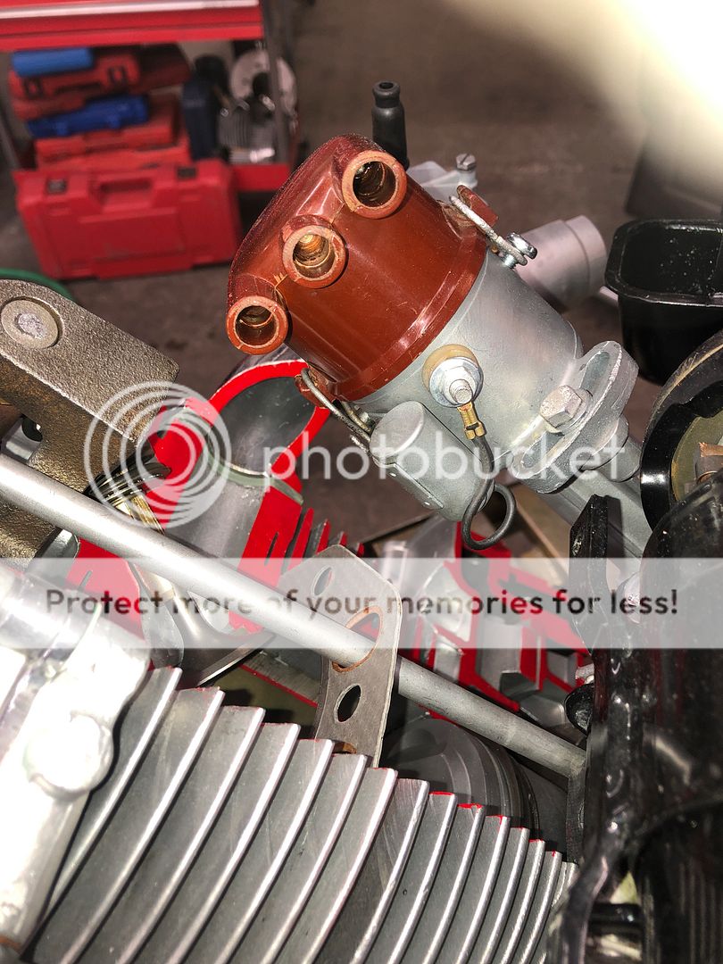

« Reply #34 on: March 28, 2019, 08:04:17 PM »
cleaned up an old corroded distributor, the main shaft is badly pitted but it make a good static display
Slit it down the length to expose the sleeved body and mount and see the shaft, you have to really peek deep down to see the distributor gear mesh wit the cam gear

For cutting crankshafts and clutches I personally would use a 1mm slitting disk for the first try at least.
  • Posts: 29679
Re: Now That's a Hemi! or how I cut apart a Guzzi motor
« Reply #36 on: March 29, 2019, 06:48:02 AM »
I would think the ring gear would be hardened. Cut off wheel for that. Assuming  :rolleyes: the flywheel is cast, a band saw should go through it like butter. A file will tell you what to do.

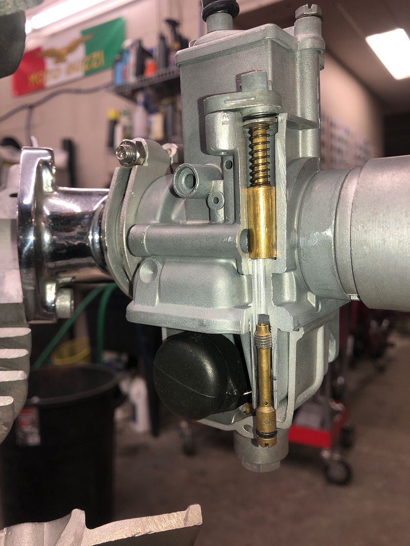

Glad to hear some of you guys find this as interesting as I do! I see it as art more than mechanics .... I am not that cultured :azn:

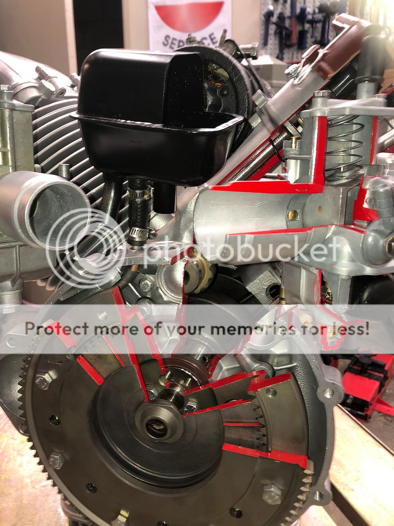

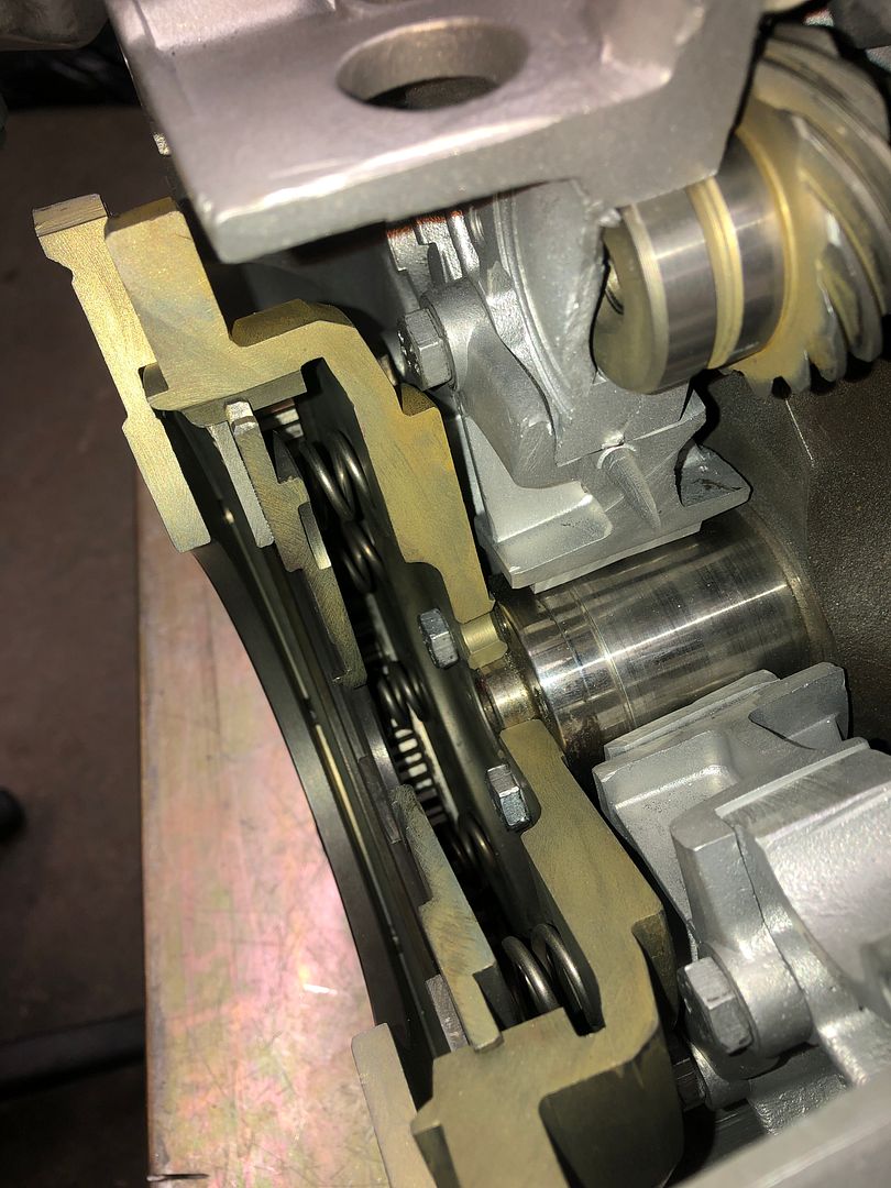

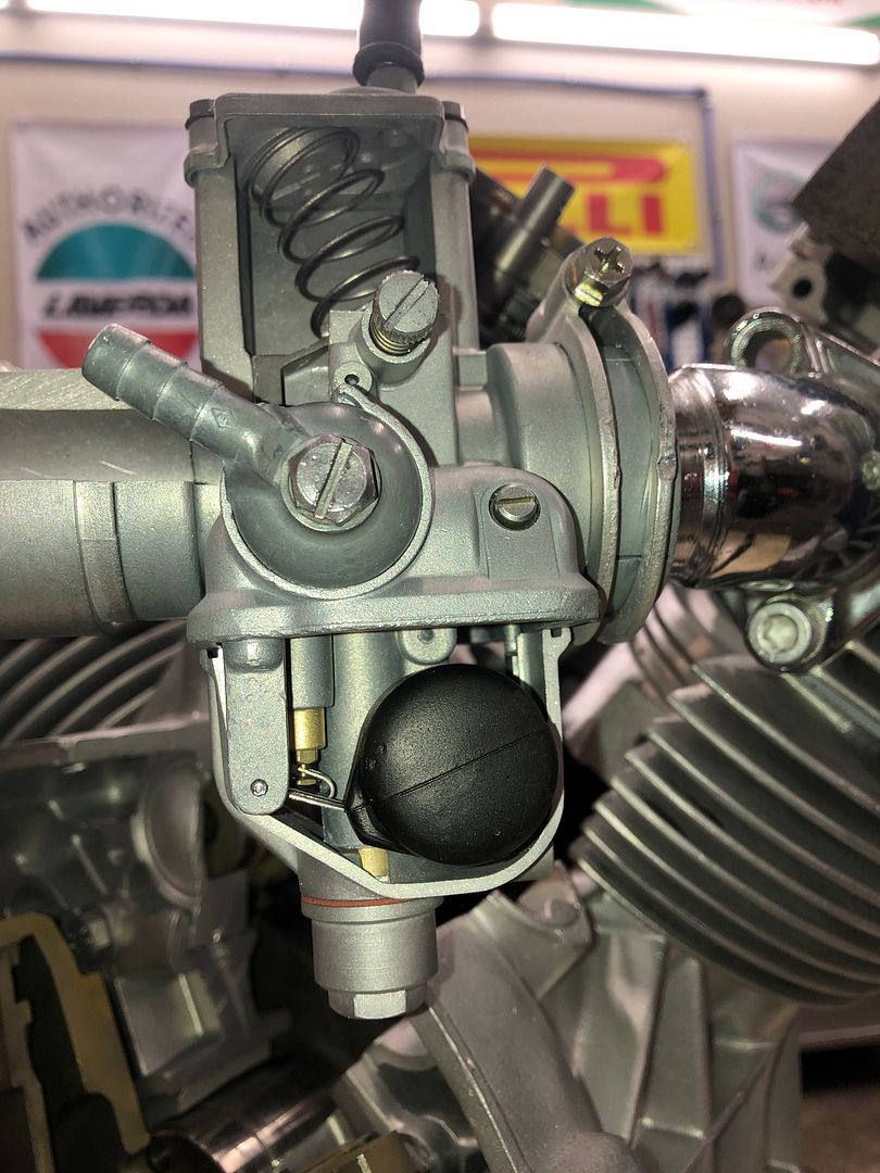

I used a cut off wheel in my 4" grinder to slice through the flywheel, ring gear and steel clutch plates, I need to find some old clutch discs to clean up and slice.

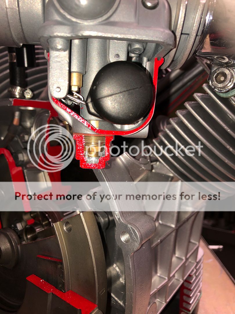

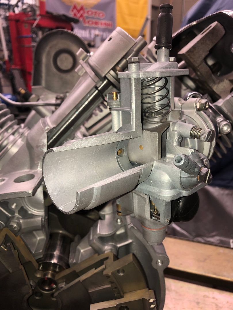

I sawed open a carb at various points, hard to see the needle but it is exposed on the inner side of the carb
The enricher circuit, pulling up the lever (not attached) and a passage is opened to the intake drawing fuel up through the small brass tube extending down to the float bowl
The float with the fuel valve attached
slide and velocity stack

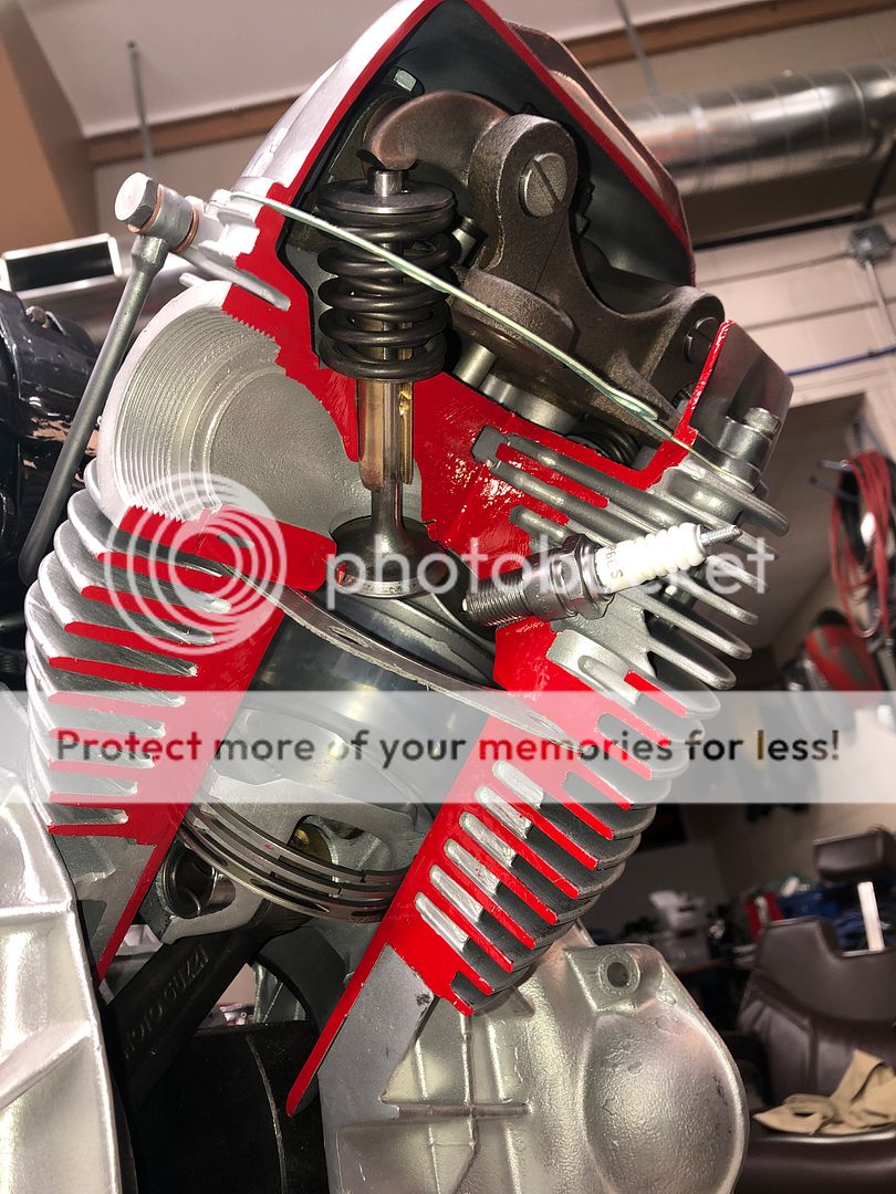

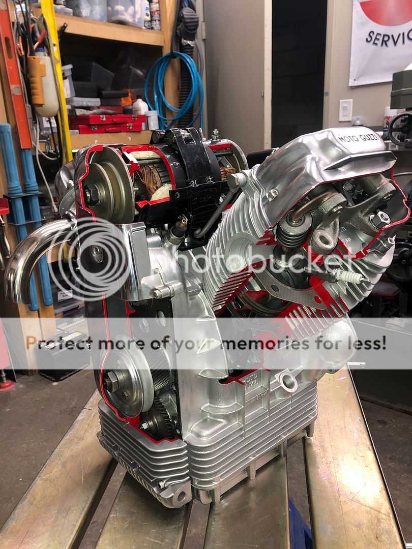

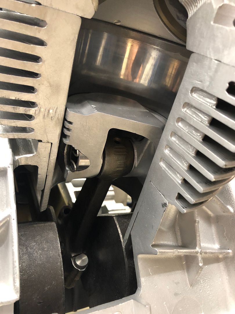

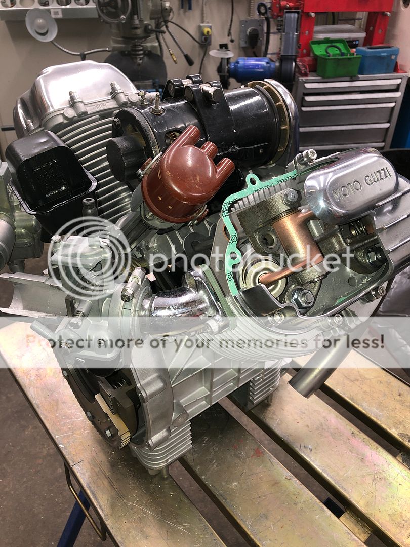

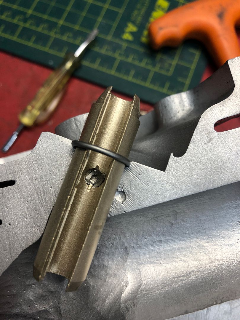

I cut open a little window in the block to view the base of the distributor gear

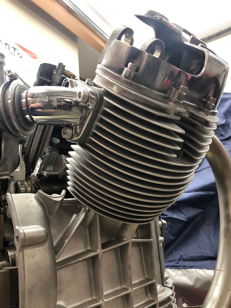

I replaced the one cylinder because it had three broken fins but this cylinder has an iron liner and the bore must have been for a bigger piston so this piston is loose

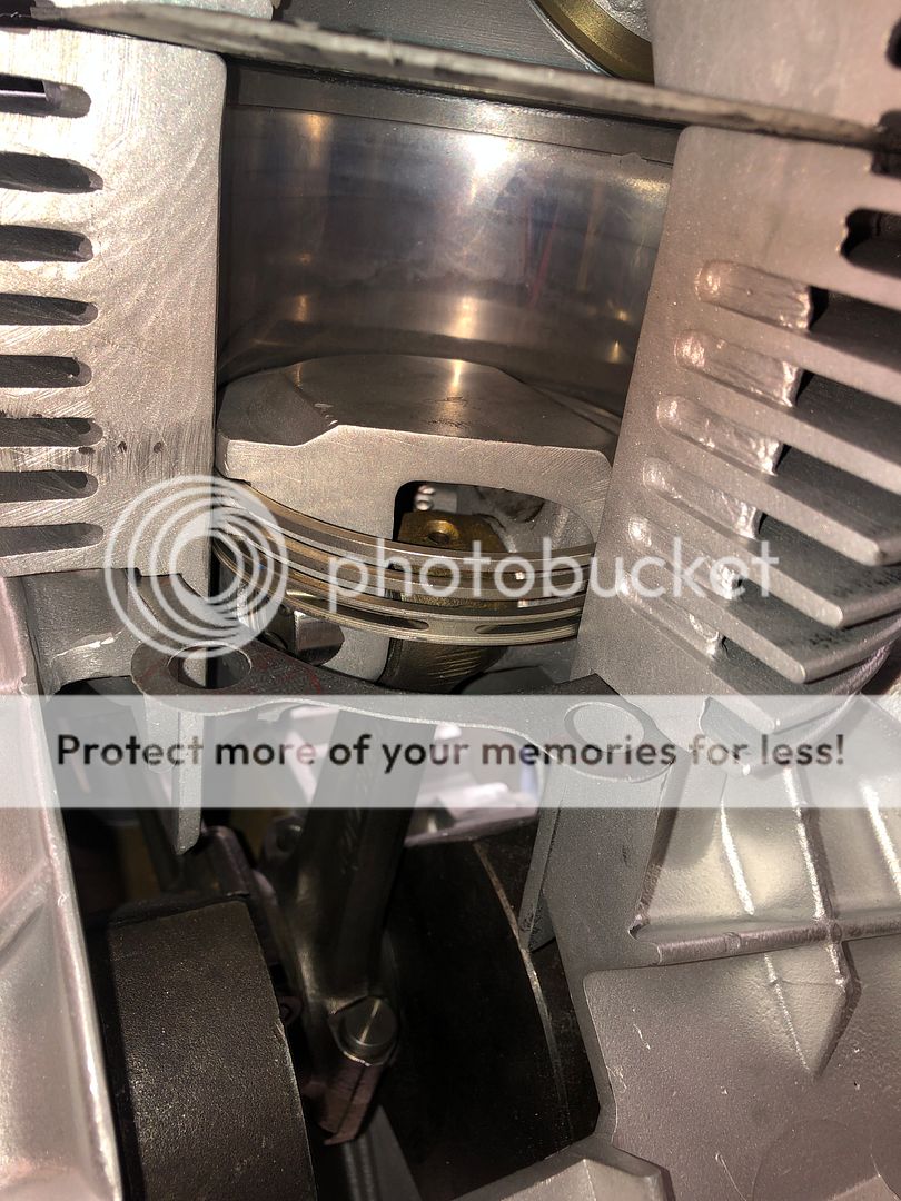

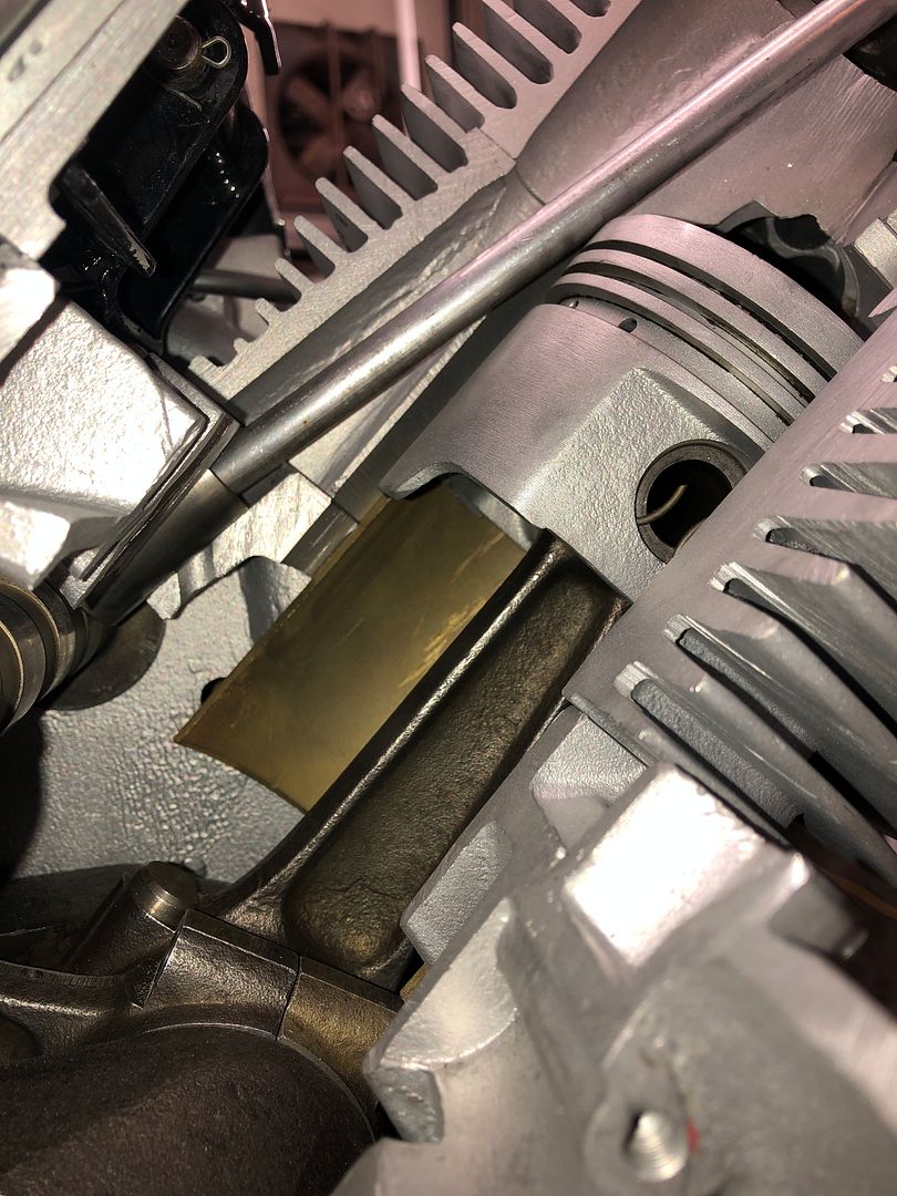

I sliced open a piston

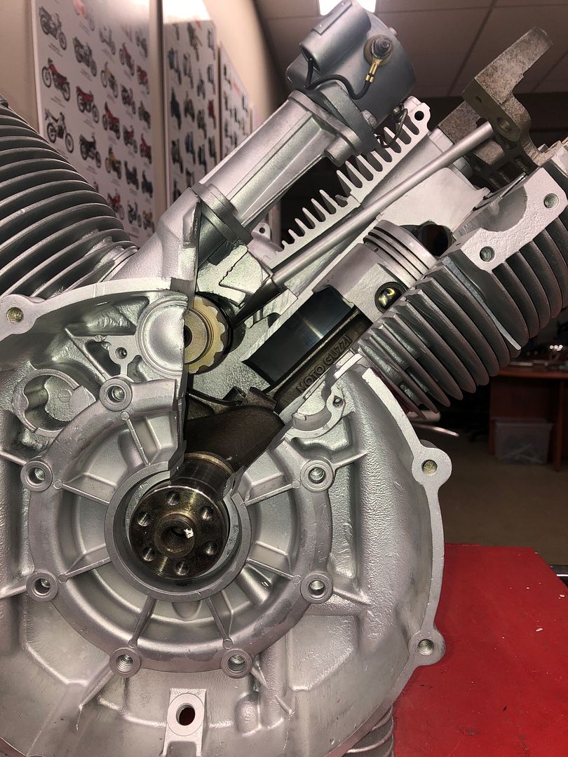

I had a Tonti crank in the motor but the pulley did not fit right, swapped in a spare Eldo crank

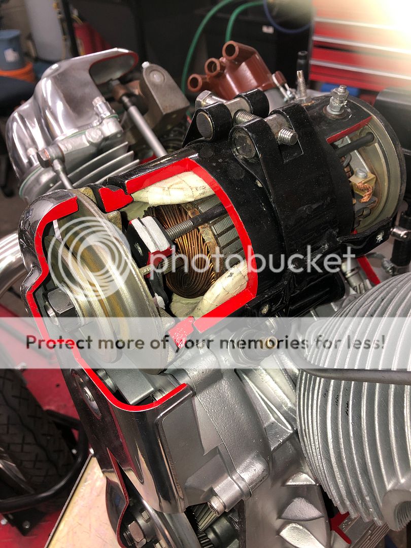

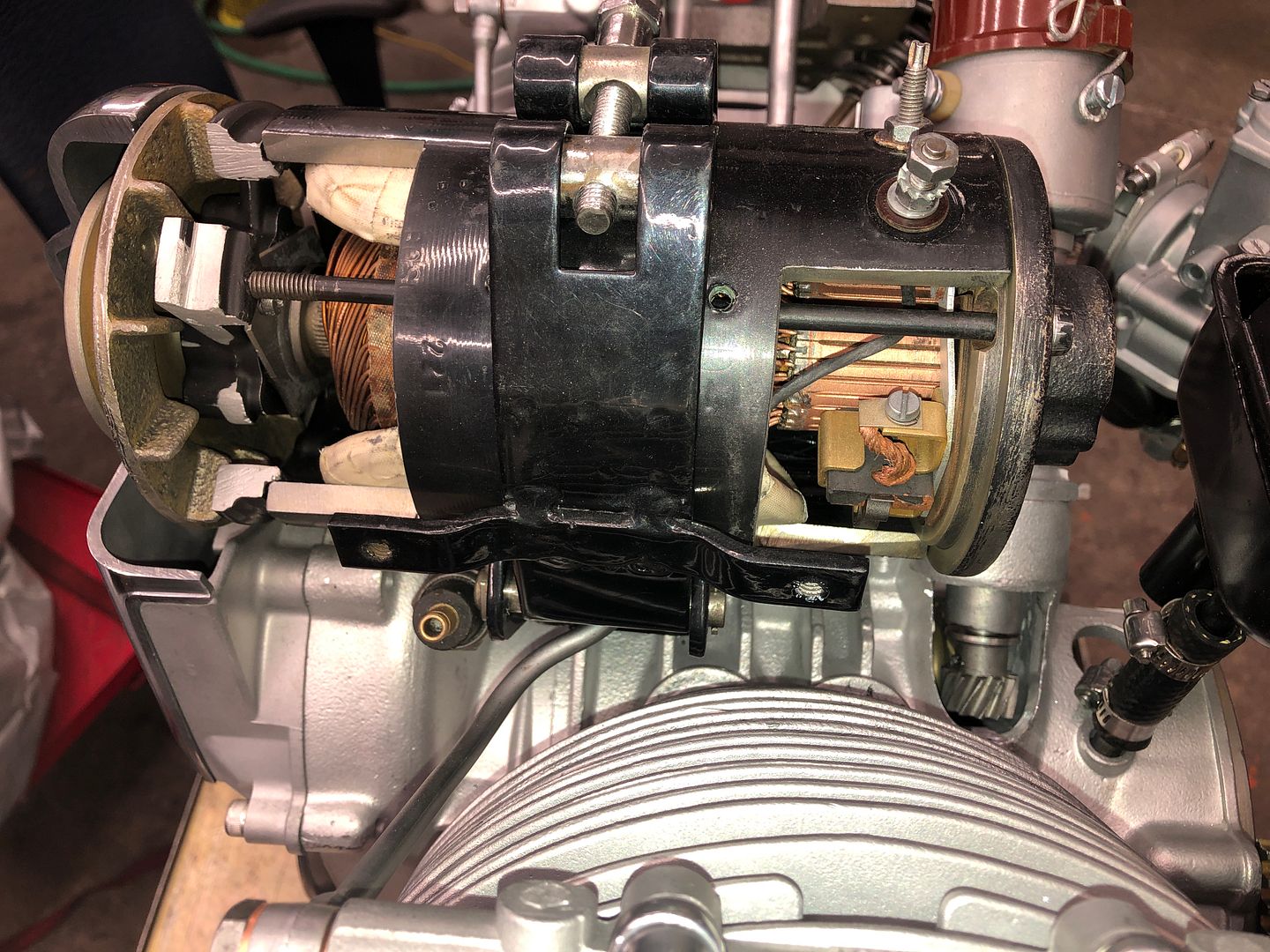

Trial fit the generator, deciding where to cut it open
I wasn't happy with the clutch cuts I made so I redid the angles

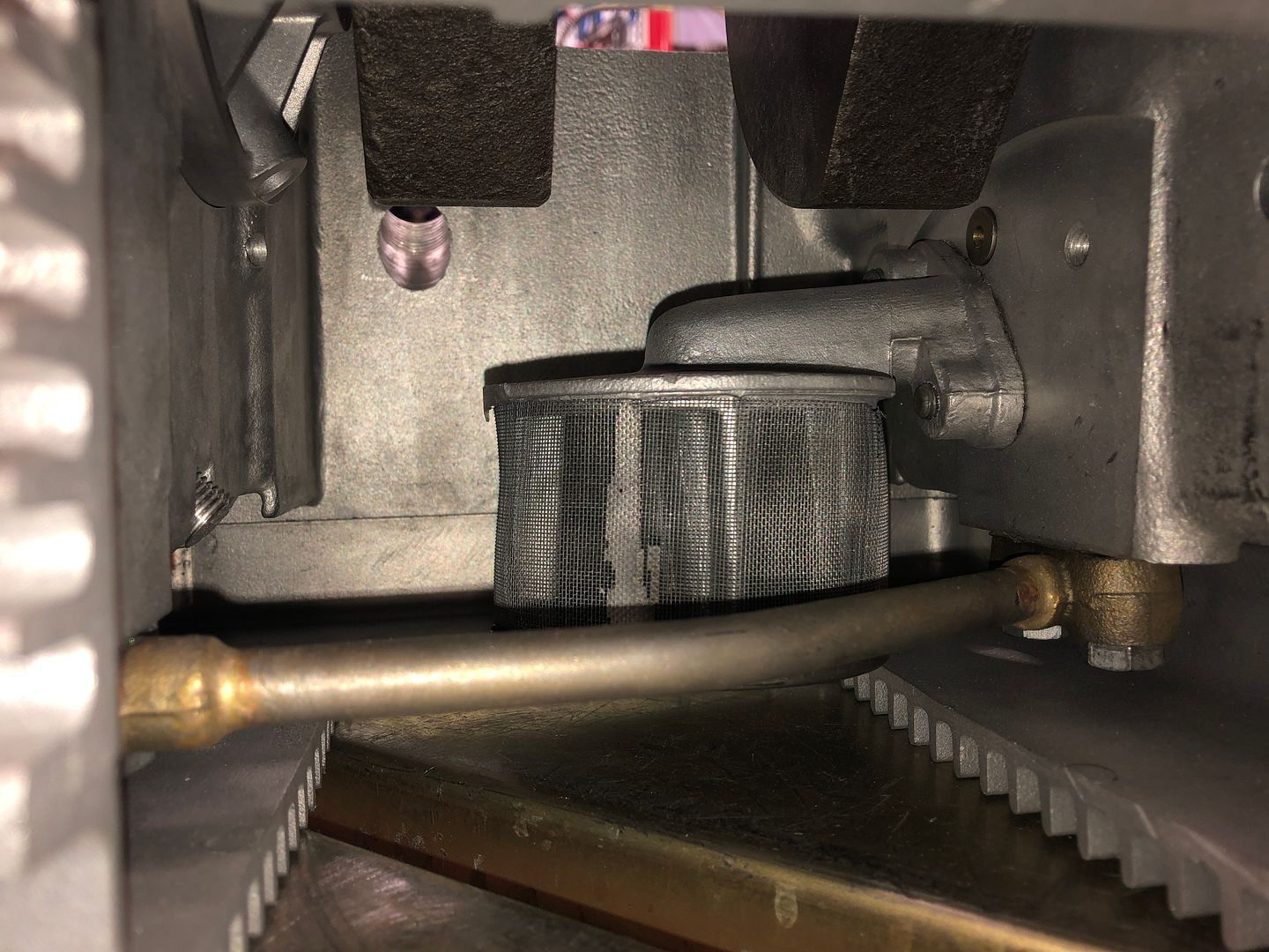

Installed the oil pickup and oil tube

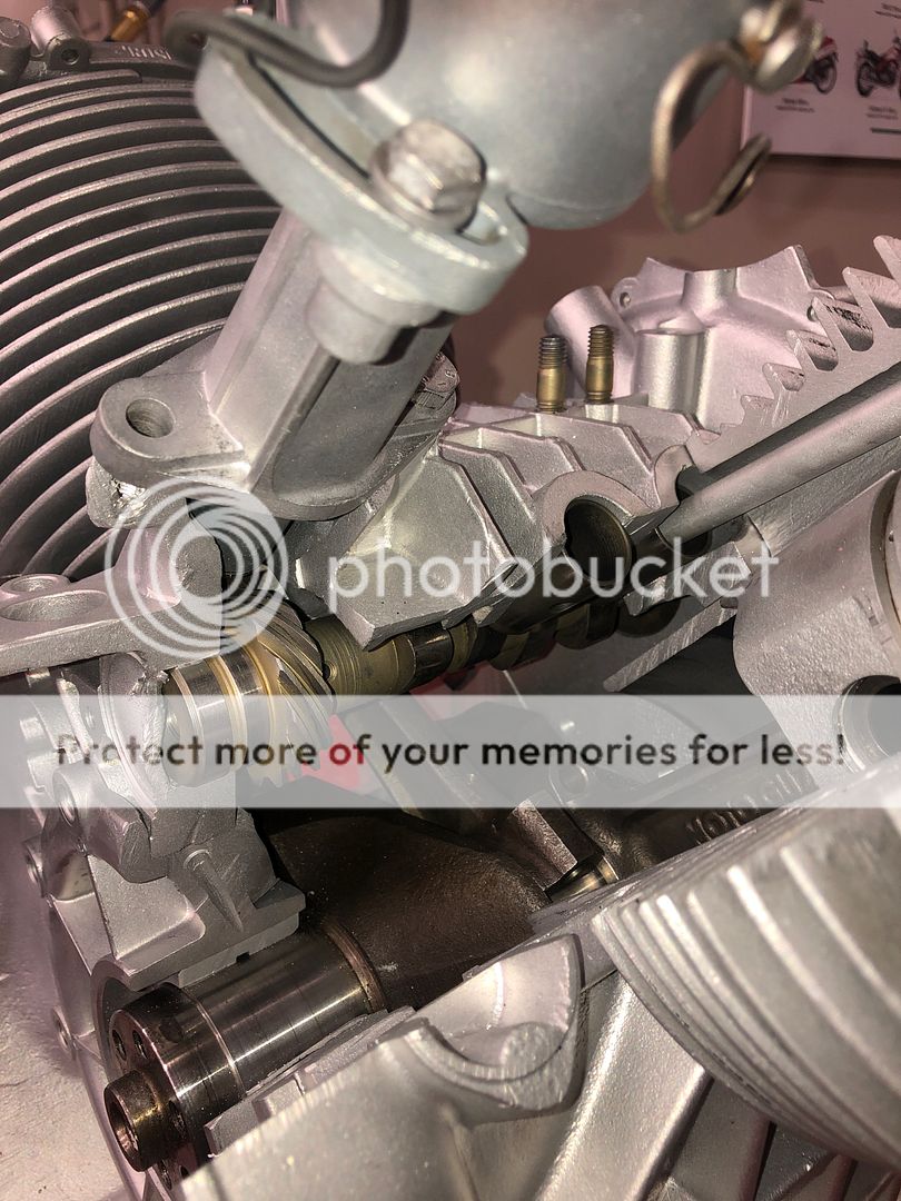

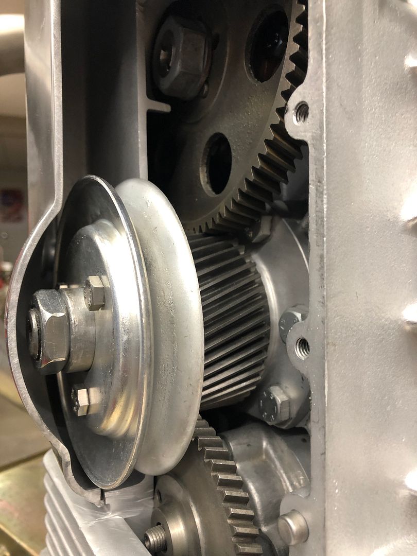

Maybe a stupid question, but what is the advantage of the helical cut timing gears?  I am amazed at the robust build of these motors after seeing this.
  • Posts: 15052
« Reply #48 on: March 31, 2019, 06:55:31 PM »
Those appear to be V700 timing gears, which have finer teeth than later ones.
Offline Rick4003
Helical gears run quietly compared to spur or straight cut gears which make a load whining noise when they are running.
Compared to the later chain drive it doesn't have as much slack as the chain got and it doesn't have a chain tensioner to fail. Downside is that they are probably more expensive to make. They also create an axial thrust due to the angle of the helical cut gears. Spur gears and chains don't produce any significant sideload on the parts.
Also have an increased load rating over straight cut, some 30% I believe.

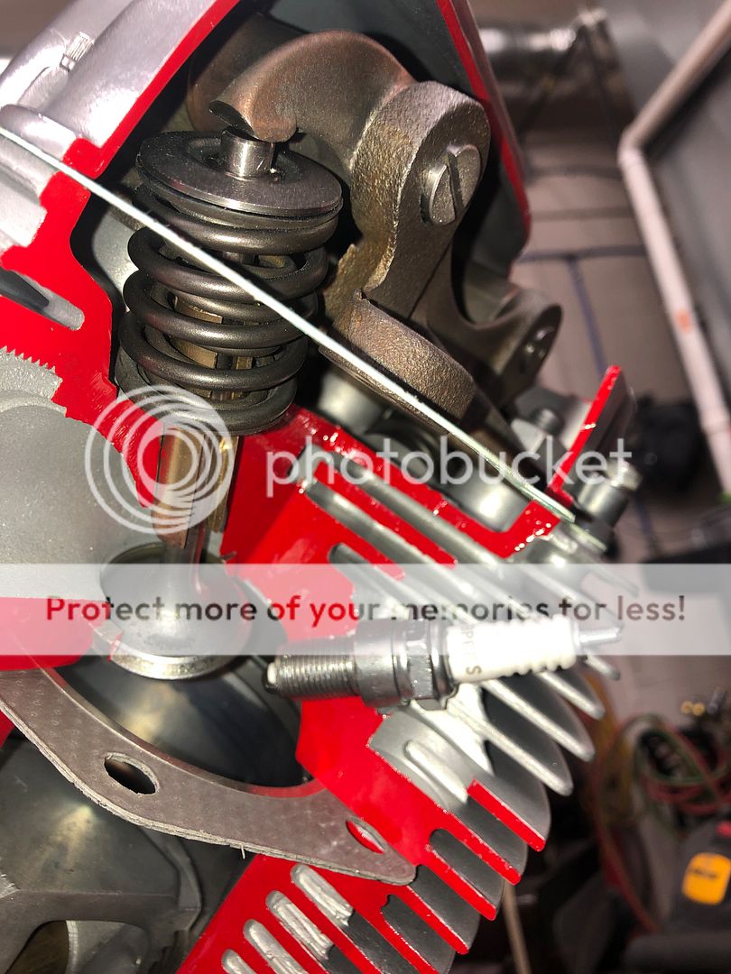

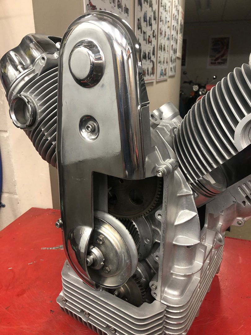

I scratched my head for a long time trying to figure out how to mount the guide to the head, I came up wit this, slit the guide down its length in the mill, drilled a hole and counter sunk it through the guide to take a M4 machine screw, flattened two side of the machine screw to fit the width of the slit
I marked the head with a centre punch and drilled and taped the head, screwed in the machine screw then filed down the head and staked the screw head to the brass guide

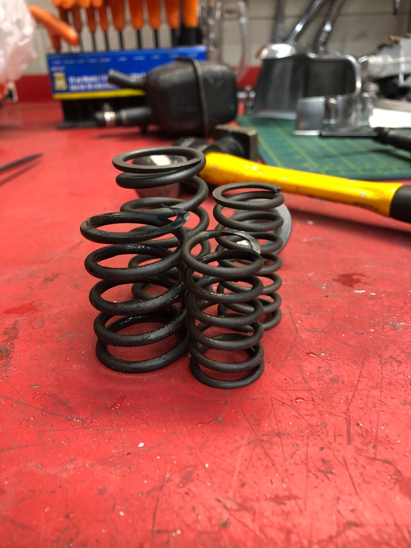

I shortened the springs to reduce the pressure on the guide
Then set the retainer collar and collets, done

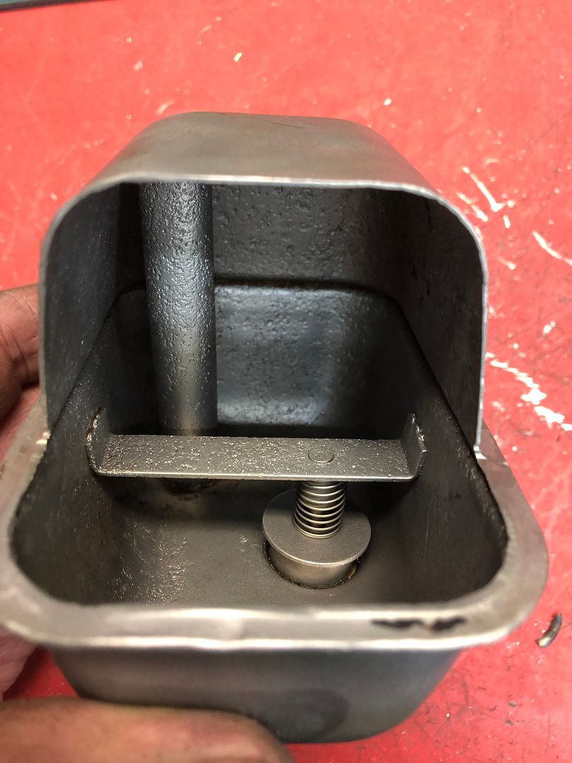

Cut open the rust breather box, blasted it and painted it

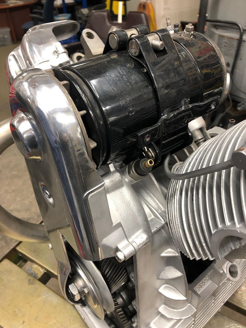

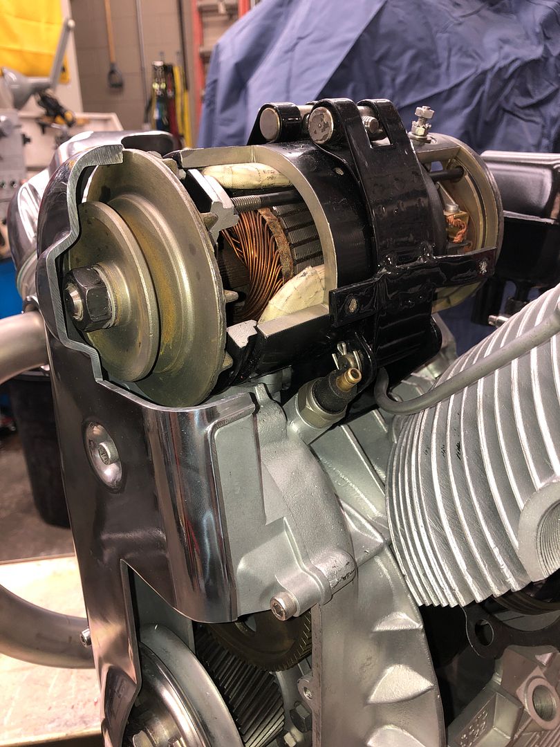

I took the generator apart and cut away the body and front cover then put it all back together
I fitted a set of rings to the cutaway piston, looks like the rings of Saturn
I fitted some gaskets to see if I should cut them flush or leave then whole?
Thinking I may leave the whole gasket, I think it helps the mind fill in the missing parts and understand the form, what do you think??
I just realized I cut the distributor so its facing the wrong way, don't use this 'build' as a how to guide :thewife:

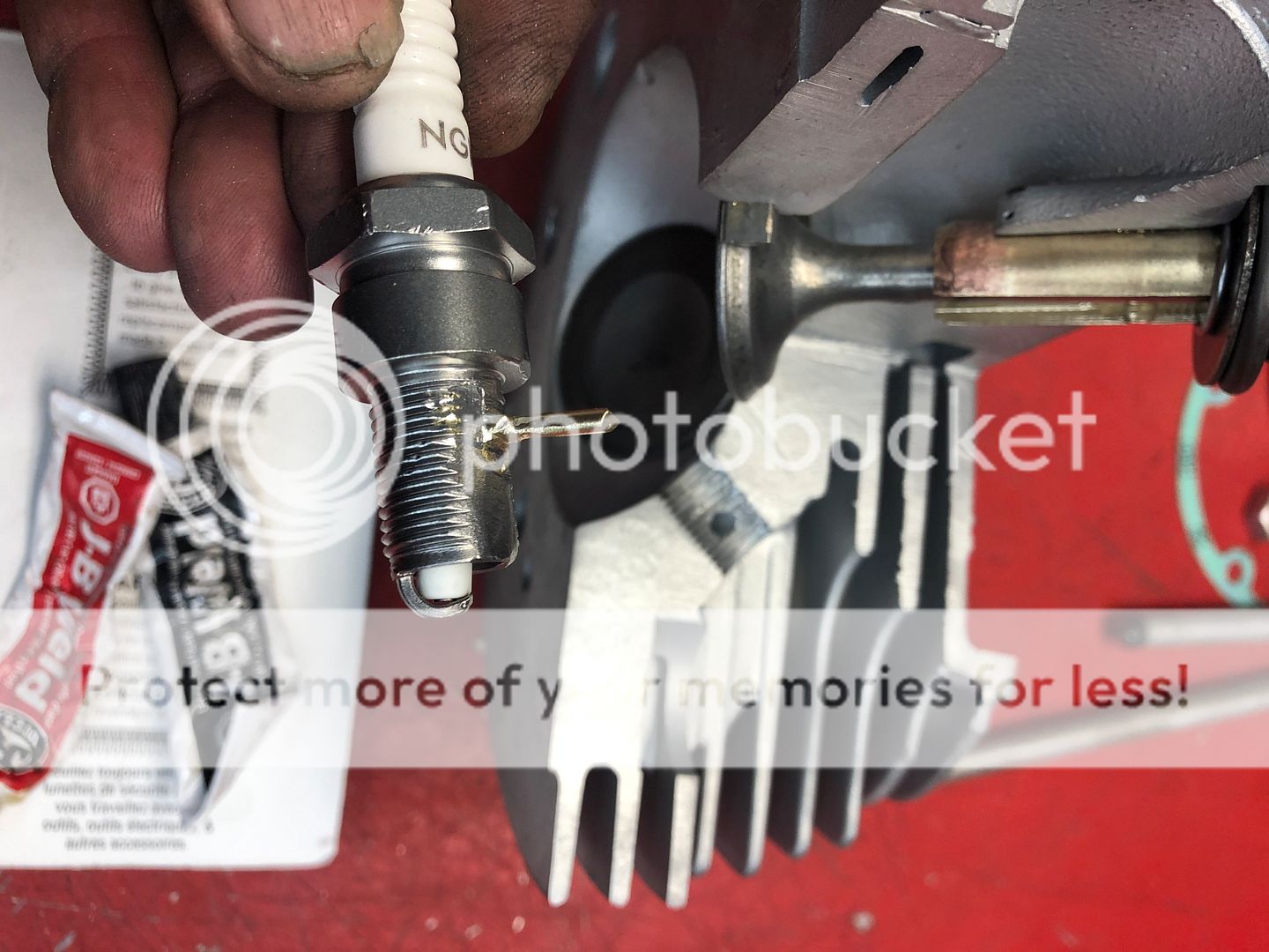

I figured out a way to pin the spark plug to the head, I drilled a hole through the side of the plug then braised a brass rod to the hole in the plug. Drilled a deep hole in the head, filled it with JB weld and tapped the plug / pin into the hole.
Its pretty solid, when the JB weld sets up it should be rigid
I bought some sign paint called 'One Shot' and started to paint out the cut faces to see how it will turn out
Now to take the whole thing apart and paint all the cut faces
