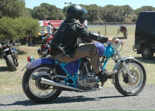

Sorry, you can never un-see this:
Re: Gone to the Dark Side - Ducati 860 GT
« Reply #126 on: May 20, 2019, 06:18:18 PM »
WHY !!!!!!
Engine donor.
