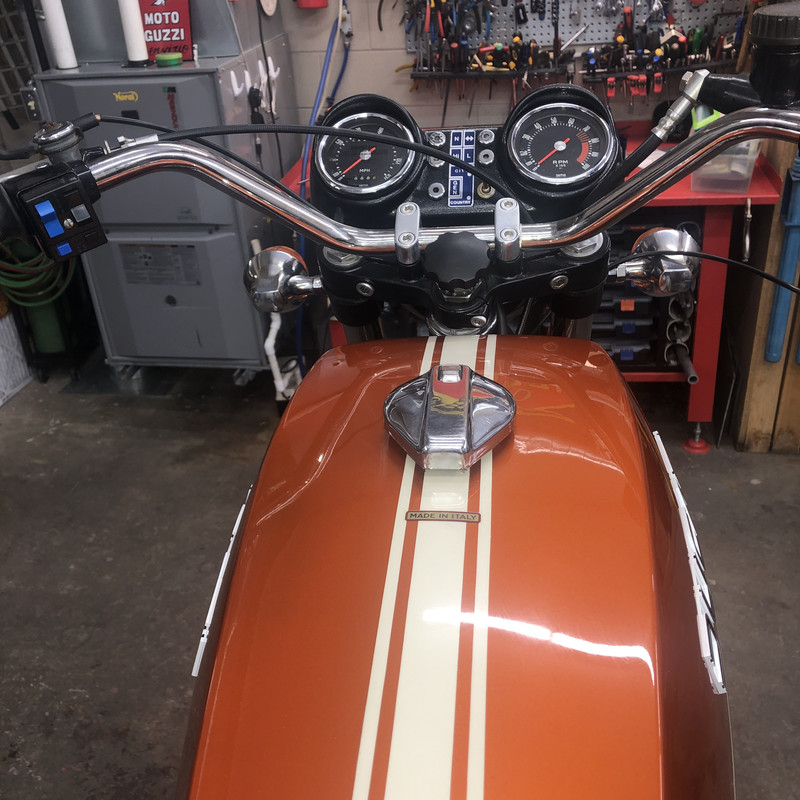

I farted around with getting the horn to work for a couple days, very frustrating. I had bought a new horn off  Ebay, just like the original... The problem is when I touched an ohm meter across one of the lugs to the body I get continuity so as soon as I mounted the horn  and turned on the ignition it went off. I tested several of the horns on other bikes and same thing. Then I dug into a junk box and found an old similar horn, and this one had no continuity between the wire lugs and the body, works perfect.
The Ducati horn button connects a ground lead completing the circuit. The hot lead is shared with the two brake light switches. Each brake light switch completes a ground when activated by pedal or lever. So the Ducati horn needs to have a ground isolated from the body.
I had no idea there were differences in the horn make-up though they look the same. :huh:
I took the stator to a rewind specialist yesterday along with two Moto Morini stators to check out, the Ducati tested fine, but the three wire harness had a broken wire inside it, simple fix making a new three wire lead and soldering it to the stator, no more blown fuses when I hooked it back up.
The good news is all of the electrical is now sorted out.

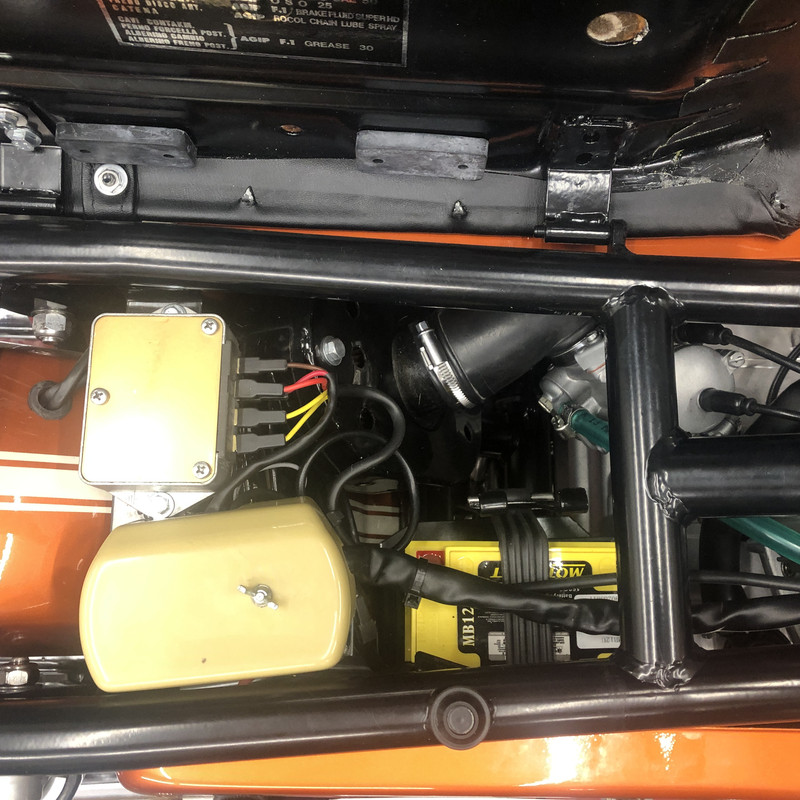

Opened up the new electronic ignition I got in the mail this week from a dealer in Europe, ... it's for a Ducati 750GT,  :thewife:  I will send it back for an exchange, not a big deal, just a little bit of an inconvenience.
Re: Gone to the Dark Side - Ducati 860 GT
« Reply #272 on: January 04, 2020, 10:54:29 PM »

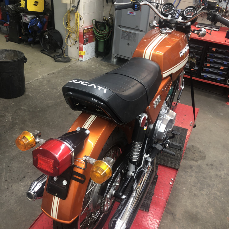

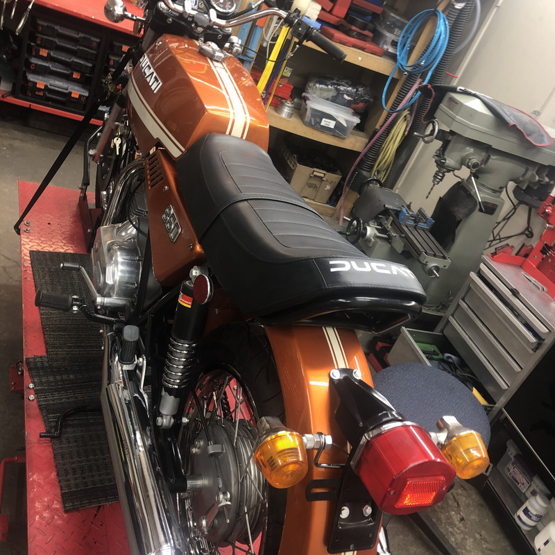

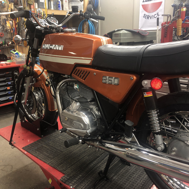

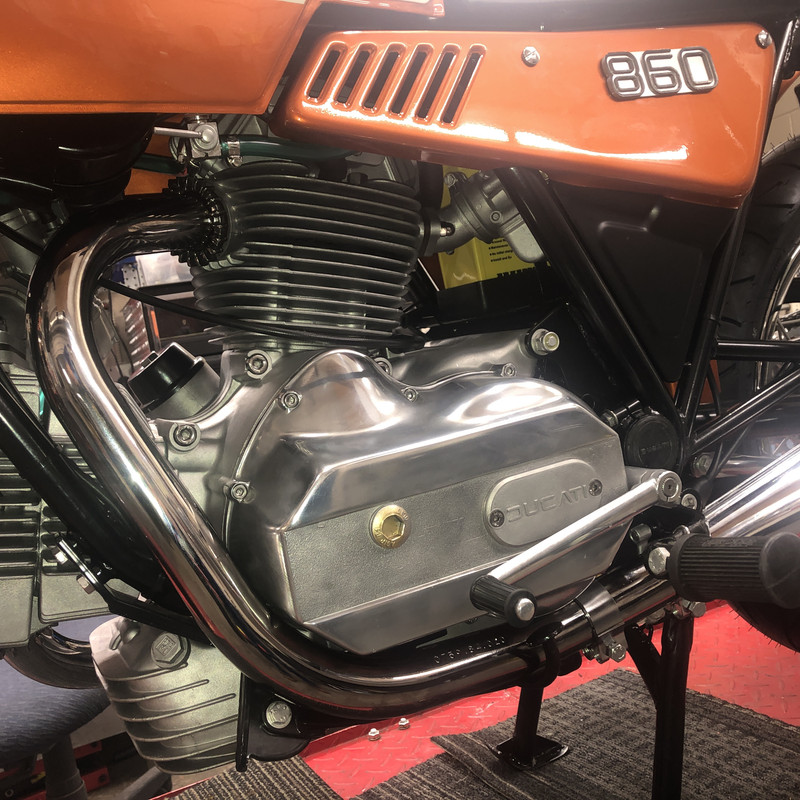

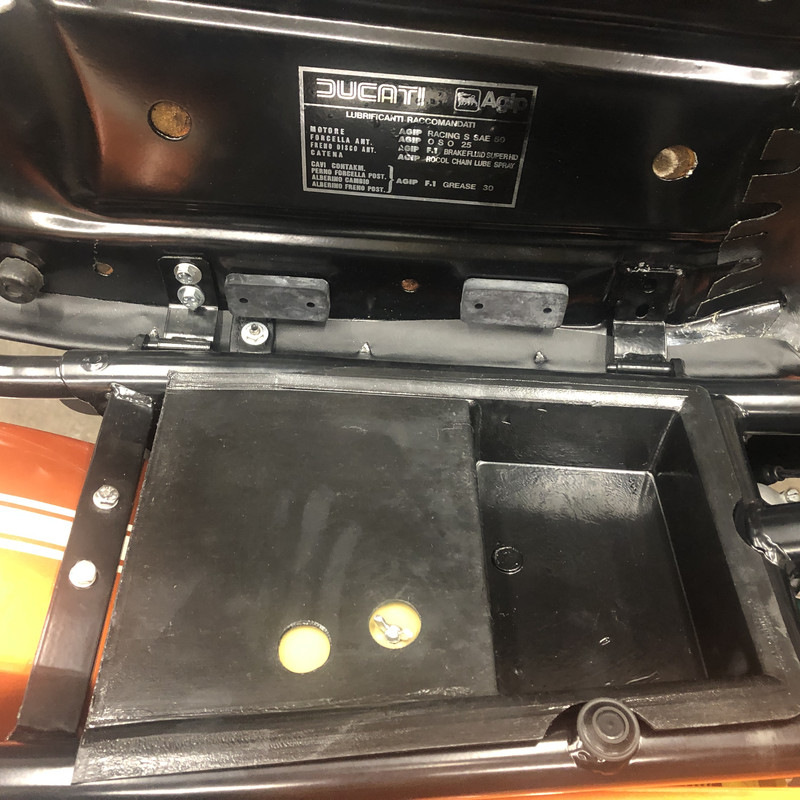

Some final detail jobs today, finished the electrical so I fit the repro fuse box cover, it is a very tight fit!
The original tool tray was all scuffed up, I cleaned it and then hit it with brake cleaner to get it real clean but the cleaner actually melted the plastic surface, I got some clean black rags and sprayed / wiped down the tray until the finish was uniform, looks 'almost' new. The fuse box will only fit one direction and the hole in the tray is to allow the fuse box lid wing nut to clear, trouble is its not in the right place, so I marked the wing nut location and drilled a new hole through the tray. If the fuse box were rotated 180 degrees the wing nut would match the original hole, leads me to believe the fuse box lid I found was not correct for this bike.
Installed the petcocks and the fuel lines, while I was back around the carbs I installed new jets, fuel valve seat and needle and new accelerator jets
Fit a used fuel cap I had, the original one stuck closed when I installed it, had to carefully pry it off

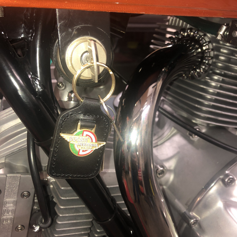

The finishing touch a new Ducati key fob Charlie sent me!
One job left is to fill the front master cylinder reservoir and bleed the brakes, then its just wipe it down and take it to the International Motorcycle Show when it comes to town in a couple weeks.
Its been fun, I will install the Sasche ignition when the correct unit comes in and then it should be road ready for an inspection in the spring.

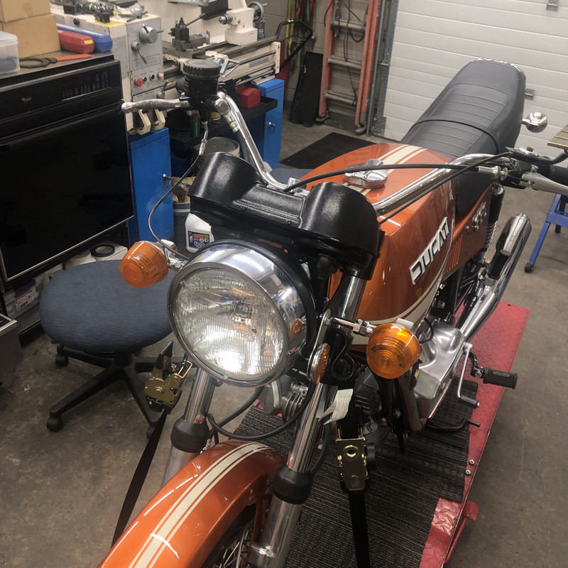

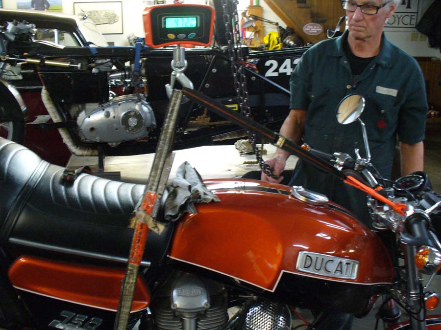

One last tidbit, I finished bleeding the brakes and fitting the last decals on the forks, then lifted the bike up from my shop overhead crane. I rigged up a digital scale to the hoist, the dry weight of the bike, no fuel in the gas tank, no oil in the crankcase but it does have a battery installed.
459.5 pounds
« Reply #277 on: January 11, 2020, 08:25:28 PM »
459.5 pounds
I wish everyone who talked about the weight of their bike had one of those scale rigs.   It would save a lot of nonsense talk, requoting of urban legends,  and argument!!
« Reply #278 on: January 11, 2020, 10:22:57 PM »
Indeed|!
Most specs on-line claim the wet weight of the 860 GT is 504 lbs. The gas tank is 5.2 gallons, I assume they mean imperial gallons ?- 7.2 lbs per imperial gallon that equates to 37 lbs, add in the 5 liters of oil and that combined with the 459.5 dry weight is pretty close to advertised wet weight  On the other hand most specs claim the dry weight of the 860 GT as 408 lbs, but I think they would subtract the battery and the fork oil as well, still no way that would reduce the true 459.5 lbs down to 408 lbs.
My 1978 Moto Morini 500 weighed in at 369.5 lbs, no fuel, no battery but a full crank case of oil, the advertised dry weight in Moto Morini literature is 368 lbs, pretty close to actual!
Over the winter I am going t weigh all of my bikes just to see how accurate the factory specs are.
Now what would be real interesting is to see what real dyno specs are compared to the published factory numbers, I bet the actual is around 15 ~ 20% less than the lofty values the factory claimed.

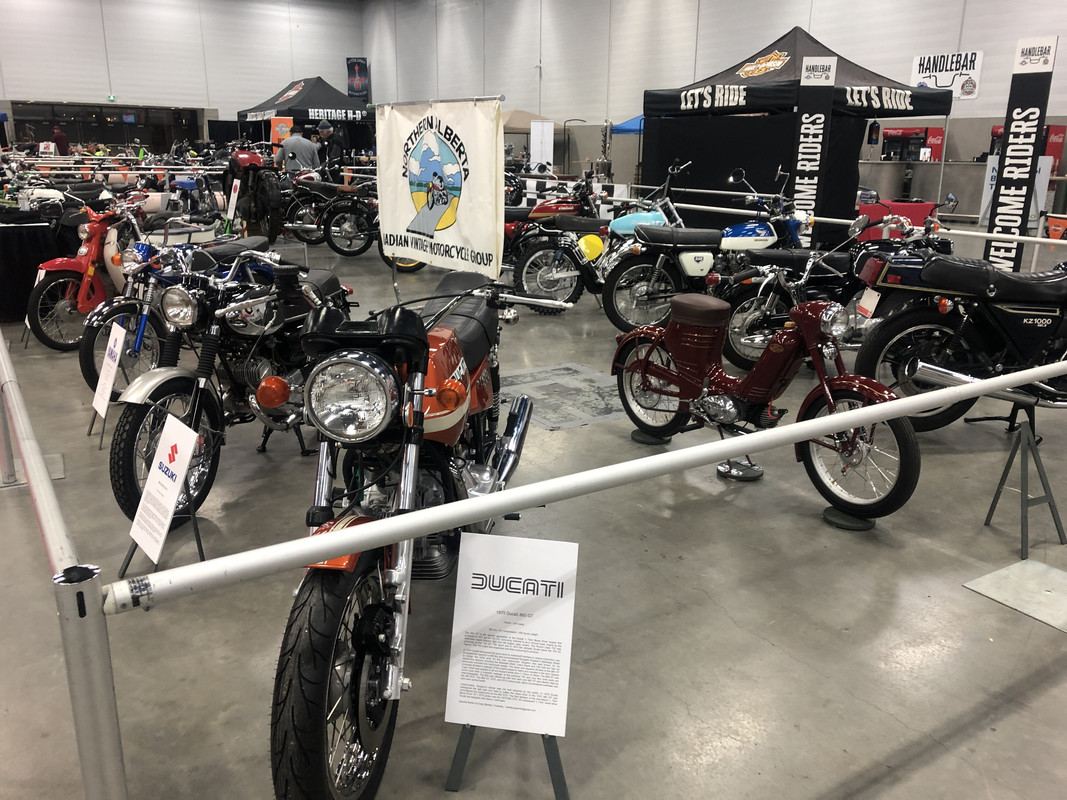

I have put the Ducati in the vintage bike show at the International Motorcycle Show as it comes through town this weekend. Coldest week of the year, not fun to move bikes when its been -35C and then add in the windchill, BRRRRRR.
We have been allotted enough floor space to display 22 motorcycles. I organize the little display and our only criteria is hte bike has not been shown at this event in the past 5 years, I am always amazed at what shows up. The beautiful little cycle next to the Ducati is a Jawa - a 1957 'Pionyr' - 50cc two stroke 3 speed.
This green bike is a 1957 DKW RT 250 VS, found on a farm in northern Alberta with original owners and shop manual, the owner was a farmer who had John Deer equipment, the bike was originally black but the farmer had some green paint on hand.... The Auto-Union 4 rings are stamped on many of the bolt heads, it runs like a charm
One of our local CVMG members family were a Honda dealer in 1964, his father owned a farm implement dealership in a small town in Manitoba, one day his dad returned from Winnipeg with a big crate in the back of his one ton pick up - HONDA stamped on the side and inside - 3 Honda Cubs. This bike is one of the original three and still owned by Sam, the original owner, 16 years of age back in 1964.
a rare 1979 Ducati Regolarita - 125cc Two Stroke - 6 speed, found with another one in a shed in southern Alberta, needed a total rebuild, next to it a 1974 KZ400 - found two blocks from the new owners home, sitting in a garage under a cover for over 30 years!
A real nice 1977 Bonneville and behind it a gem of a 1969 BSA Thunderbolt, both nut and bolt restorations

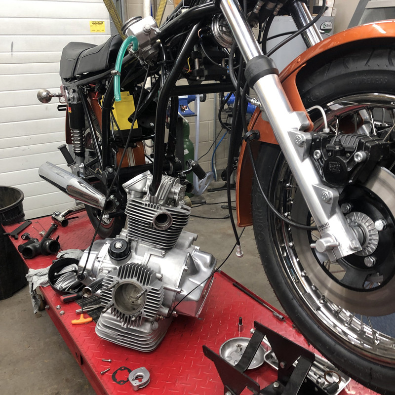

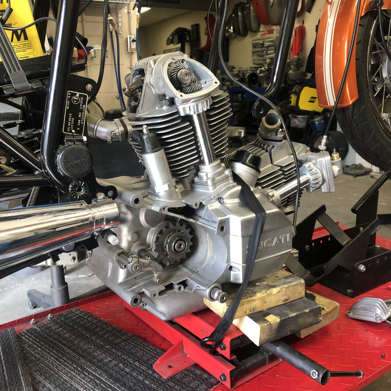

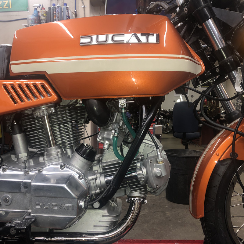

Restoring an odd bike is one thing, fettling the faults is an all together different adventure. I 'finished' the rebuild in time for the January 2020 International Motorcycle Show and have spent a lot of the past month sorting out a bunch of small issues with the Ducati in preparation for a mechanical inspection and registration to get it onto the road this spring.
After I fitted a new Sache electronic ignition the big twin fired up after tow kicks and once warmed up and the idle adjusted it ran quite well. Over the next couple days I found several annoying oil leaks from the top end, both heads had slow drips from joint surfaces in the bevel bear cluster housings. The only way to fix the leaks is to drop the motor and tear apart the heads, frustrating. At least the engine drops straight down with only having to remove three long bolts, remove the drive chain, exhaust headers, carbs and the breather hose.
I can say from experience with Moto Guzzi big twins the Guzzi is not know for oil leaks, the Ducati has a lot of joint surfaces to seal
I decided to break down the heads, lean all mating surfaces and add a thin wipe of RVT sealant between the paper gaskets and alloy.
I did manage to get the motor out, the heads re-sealed and all back in the frame in about 6 hours.
Other niggles, the charging system doesn't, Bevel Heaven now sells a universal solid state reg/rec for around $100 and I found a NOS stator / alternator for $240
One of the front calipers is weeping and so on it goes.
This seems to be par for the course in my experience with putting these old lumps back together.
How do others fair with sorting out the little things of fresh restorations ?
