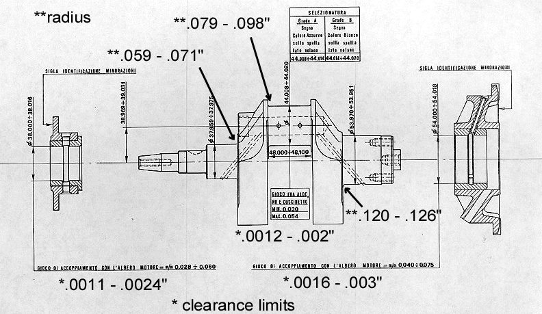

I have the crankshaft out of my El Dorado and am taking measurements to determine if a regrind is required.
Does anyone have the specifications/clearances (or can point me in the right direction) for the big end journals, and the crank journals that fit the front and rear of the crankcase?

I do use the radius specs. from the V7 Sport manual when having the crank reground.

June 18, 2019, 01:21:49 PM »
1972 Eldorado crankshaft specifications
