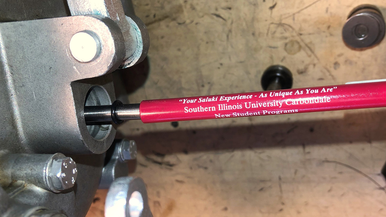

Clutch pushrod orings in.  My early 4 speed only can handle 4 of them.  5 speeds can accept 6 and Charlie mentioned later 4 speeds also.

Dave - do you fit the o rings until no more will fit in there or do I just fit 6 in my five speed?   I just bought the o rings - very pricey.  Great picture.
Only the number to the point you can feel it's limiting the travel of the plunger.   Pretty safe to say your 5 speed will take 6.  Just make sure all of them have been removed.   I bought mine at my local hardware store. Cheap

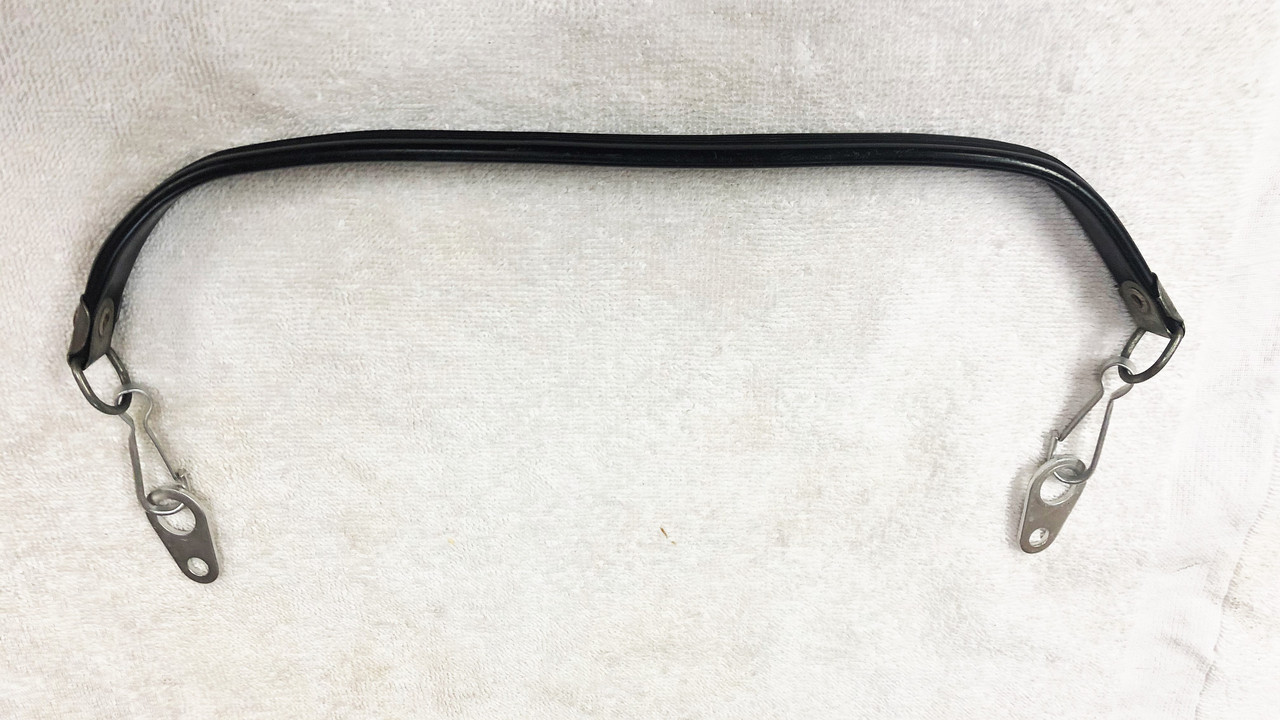

I am lucky to have some rare small bits that most V700s don't have anymore.
Both of the rarities can be seen in the factory photo.
The housing at the terminus of the speedometer cable should be a silver plastic instead of the common black.
And the detachable pillion strap.  Hard to find since it was easily detached and lost.
Because of this post, I finally figured out what the NOS teardrop with two holes shaped tabs I have are for.  :grin:
I have a few of those silver boots somewhere too.

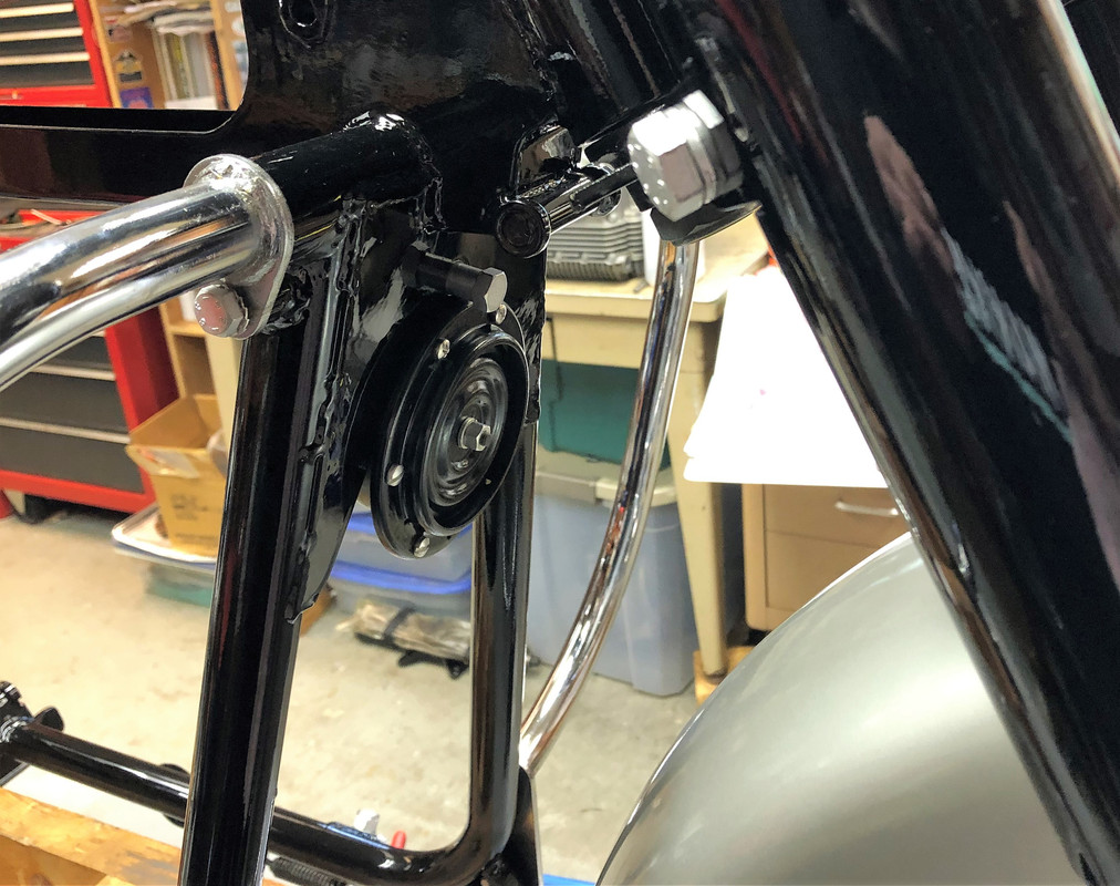

Horn back in place.

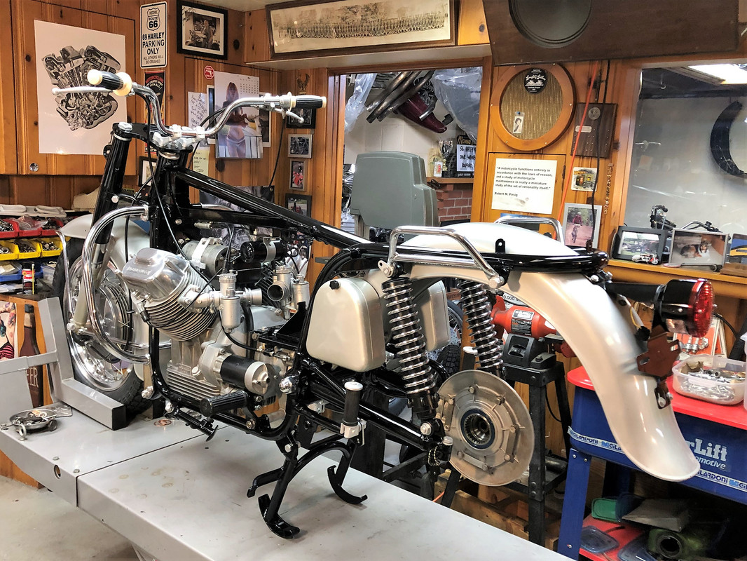

It was a productive weekend!

How do you keep such a clean shop Dave?
  • Posts: 4870
Re: 1968 V700 Rejuvination
« Reply #89 on: May 18, 2020, 07:59:53 PM »
I take the picture at the end of the day after I have cleaned up.  If you noticed,  I don't take pictures of my workbench.😎
