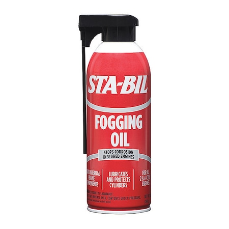

This is GREAT advice, thanks. I've not even tried turning the engine as I hadn't "read up" on this yet. I've changed all the oils, but not checked valves or turned anything. I plan to drizzle oil over the valves and down the rods, and use a clean spray bottle to squirt a bit into the cylinders (to get on full circumference of the cylinder around piston) before turning to adjust valves. I do wonder about a way to "splash" oil around inside to get to the seals, as you mentioned, that's my one big fear that as soon as I get her running, she's going to dump all the oil through dried up seals and I'll have to pull the gearbox etc.
I'd use "fogging oil" to spray the cylinders. Easy enough to pre-lube the rockers: remove one of the M6 hex head cap screws securing the rocker spindles and use a squirt can to force oil into the passages.

« Reply #16 on: October 23, 2019, 12:12:20 PM »
Ahh yes Charlie, will do that too thanks. I ordered some fogging oil, suppose it'll come in the next couple of days and I can wait. Shall get into the forks next me thinks.
