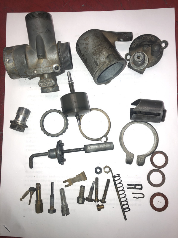

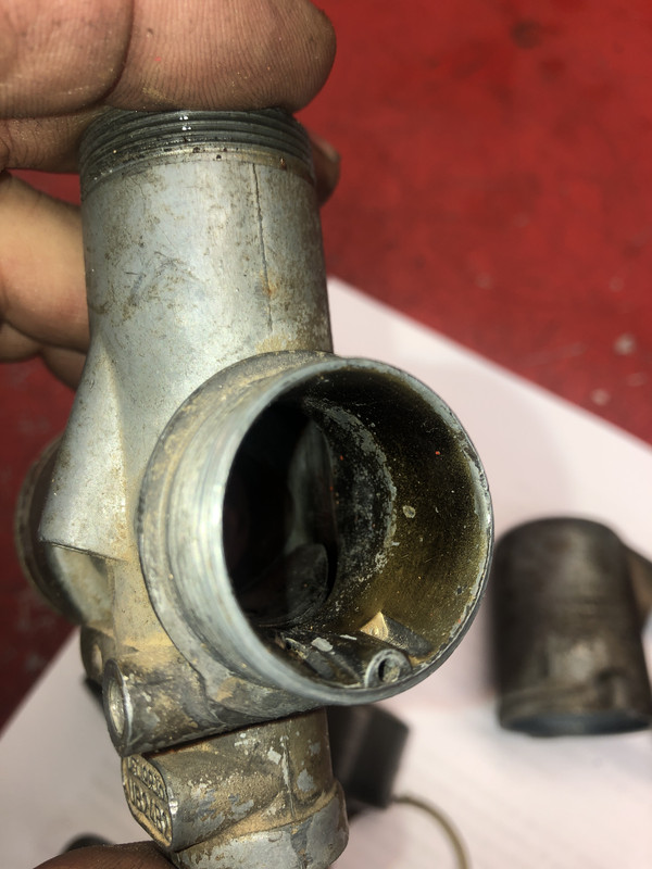

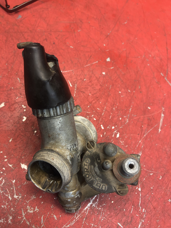

Cleaning up an old mucky carb is easy work with a vapour blaster
This old Dellorto is dirty but under the muck in good shape
To clean it all of the components need to be removed
varnish and grime
It takes very little time to clean these castings and components
The high flow of water with the glass bead in suspension strips all the oxidation and grime off.
cleaning the small bits by holding them in voce grips takes a little bit of time
Rinse with clean water and blow out all the passages
If you have an old mucky carb consider vapour blasting to get them super clean

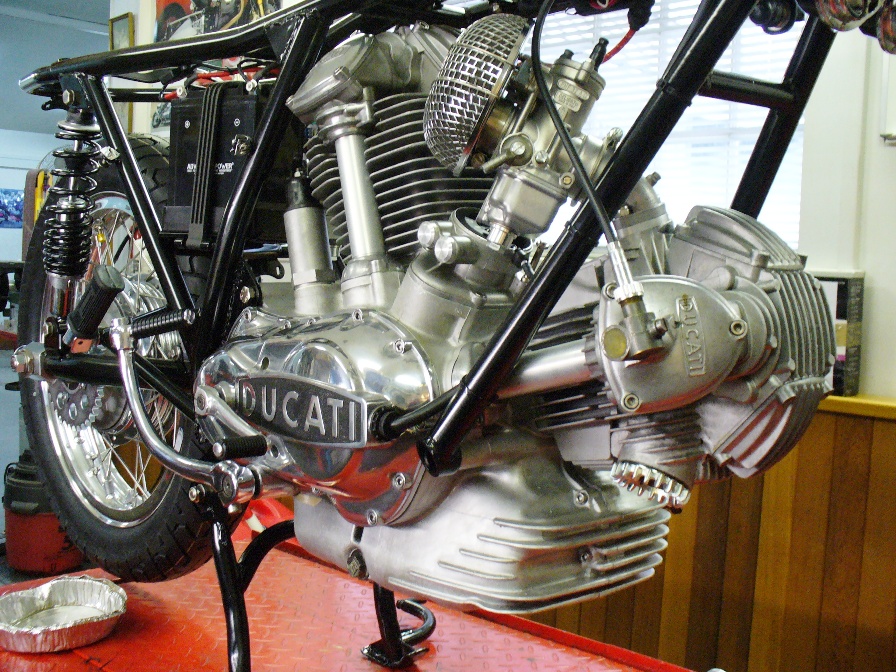

These guys did the engine cases, cylinders, heads and carbs on my Ducati 750 GT and was very pleased:
https://www.vaporblastcanada.com/

Yep. Image lifted off his site. Here's how mine turned out.
