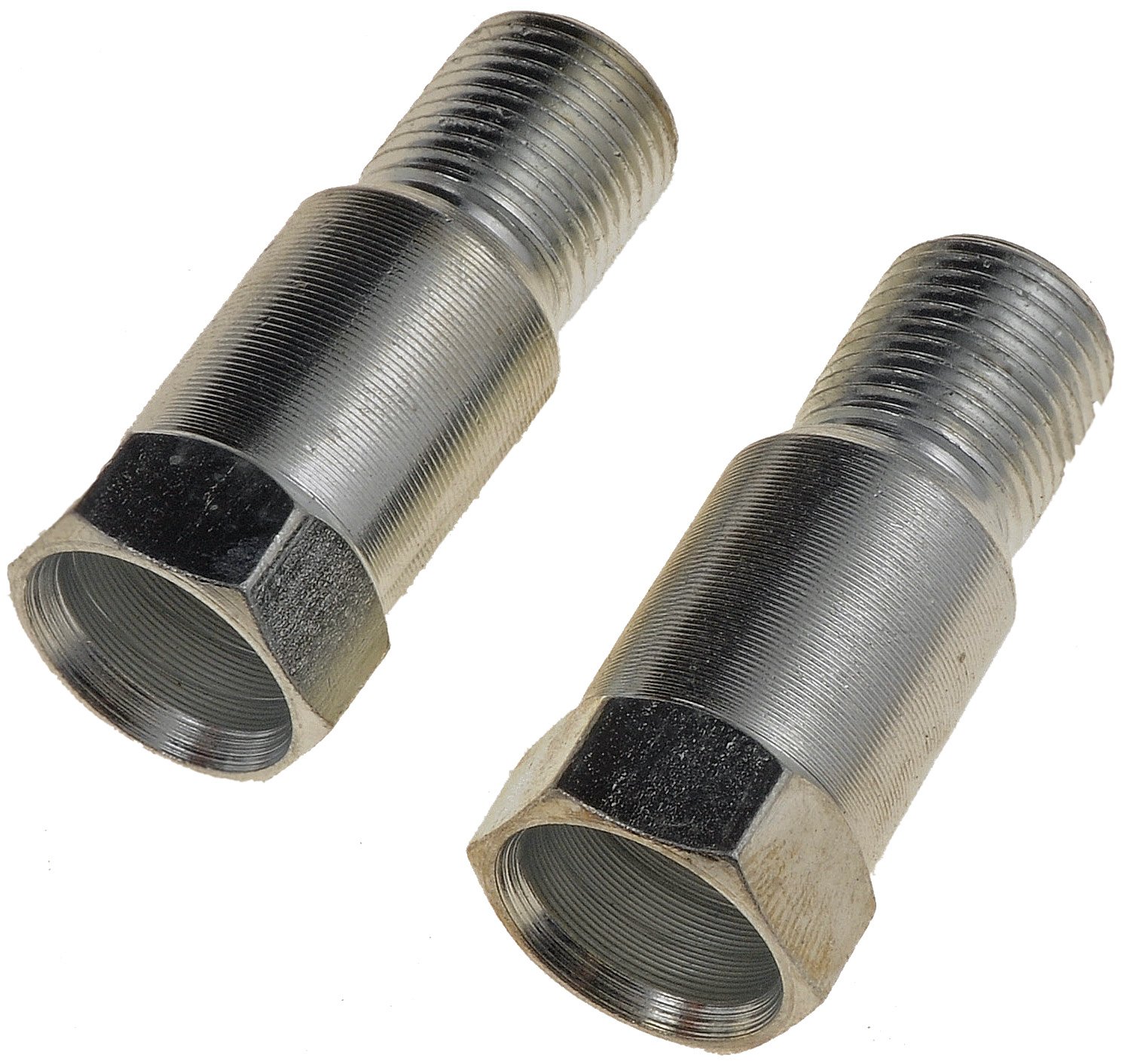

I used one of these as part of a piston stop/gauge.   A spark plug anti fouler.  Put in head, put screw inside, mounted dial indicator and placed tip of indicator on the head of screw to see when the up movement stopped.  Don't want a solid stop that will gouge the top of the piston.  I rounded the tip of the screw off and smoothed it up.

I'd forgotten how hard it is to destroy a spark plug.  :grin: At any rate, made a piston stop. My arthritic hands wouldn't open my silver solder flux jar  :rolleyes: so I got out my big hunker soldering iron and soft soldered it.
Needless to say, I was *very* careful bringing the piston up to touch it..  :smiley:  but thanks for the tip, John.
