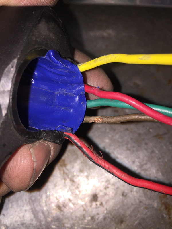

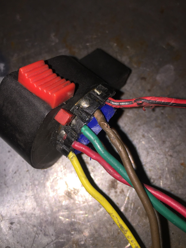

Ok, how do I open this switch up to install the new wires?  I’m sure it’s simple but the last thing that I want to do is make a mistake with this NOS switch.
  • Posts: 2166
Re: 1976 Lemans Project
« Reply #81 on: April 17, 2020, 10:00:59 PM »
As you are holding the switch in the picture just pull the left hand away from the right, its as simple as that. I would recommend using a conductive epoxy to attach the new wires to the switch rather than risk soldering.
Offline 1down5up
  • Posts: 182
  • Location: Sydney NSW Australia
« Reply #82 on: April 18, 2020, 01:44:30 AM »
What he said, can't recomend the conductive epoxy enough as the original switches are particularly fragile.
It's often sold as "de-mister" or "de-fogger" adhesive for car rear windscreen heater connections.
  • Posts: 9184
  • Location: Floriduh
« Reply #83 on: April 18, 2020, 06:24:14 AM »
Thanks guys.
 I don’t even want to touch these things, but it has to be done. Will springs fly out as it comes apart and is it difficult to get back together?
  • Posts: 2166
« Reply #84 on: April 18, 2020, 01:09:52 PM »
Pull the switch apart slowly the sprung piece should not fly away. These switches are crap but I think they belong on a bike as rare as the LeMans. Clean the individual pieces carefully and reassembly should go smoothly.
  • Posts: 9184
« Reply #85 on: April 19, 2020, 07:23:02 PM »
Thanks
  • Posts: 2166
« Reply #86 on: April 19, 2020, 09:21:49 PM »
This little ground contact is critical, the tab must ground through the clip-ons across the fork tubes to the frame. Not the best design in my opinion.
  • Posts: 2166
« Reply #87 on: April 19, 2020, 09:27:16 PM »
I had the most difficulty getting the light rocker switch tp work well.
There is a insulation sheet that insulates the contacts from the clip-ons, the swatch of isolation had torn on the switch I had and I replaced it with a section of PVC tape.
The tape has to bind to the inside of the switch but slide around the clip-on as the rocker is rotated.
Offline Motorad64
  • Posts: 150
« Reply #88 on: April 20, 2020, 12:55:40 PM »
Just took my RH switch apart but was cleaner than Canucks.  Just gently pull the inside ring apart.  Worked mine out gently with the tip of a small flat screwdriver.  The red kill switch springs and metal contact are loose-ish.
I’m dealing with LH switch issues.  Mine has this little strip of foil which I’m guessing was OEM where Canuck had to use the pvc tape.  May be going back in to investigate.
