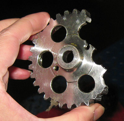

As a fatigue engineer, I look at this part and cringe.  Sometimes adding holes to save weight is just not a good direction to go if you're building something other than a race bike...
Online Tusayan
  • Posts: 1828
Re: Centauro pump gear
« Reply #5 on: March 25, 2020, 03:57:43 PM »
It’s a design apparently produced without any engineering review.  The lightening holes remove a totally inconsequential amount of weight while introducing a much higher stress.  When Joe Caruso produced his first steel replacement gear sets he made them exactly the same as OEM except for the material change.  I made some suggestions in relation to changing the hole geometry and I believe the design for the second batch of gears was updated.

Offline Wayne Orwig
  • Posts: 13993
« Reply #10 on: March 26, 2020, 03:11:29 PM »
That looks like mine did. (is that my picture?)
On mine, the teeth were so badly worn, possibly related to the oil pump shaft wear, that it would not have improved anything if the holes were not there. Once the gear tooth is gone far enough to let the tips of the teeth catch each other, something is going to explode.
See in the circled area.
