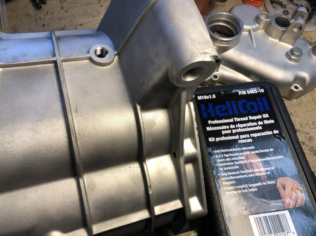

I found the transmission drain hole had stripped threads.   I sat down yesterday afternoon and ordered a M10 x 1.5 helicoil set from McMaster Carr  and received it this morning!
Les would have set this up on a 5 axis milling machine  :bow:  but I am just a hack.   :grin:
It was a bit fiddly to get it properly set up in my drill press but it was successful.

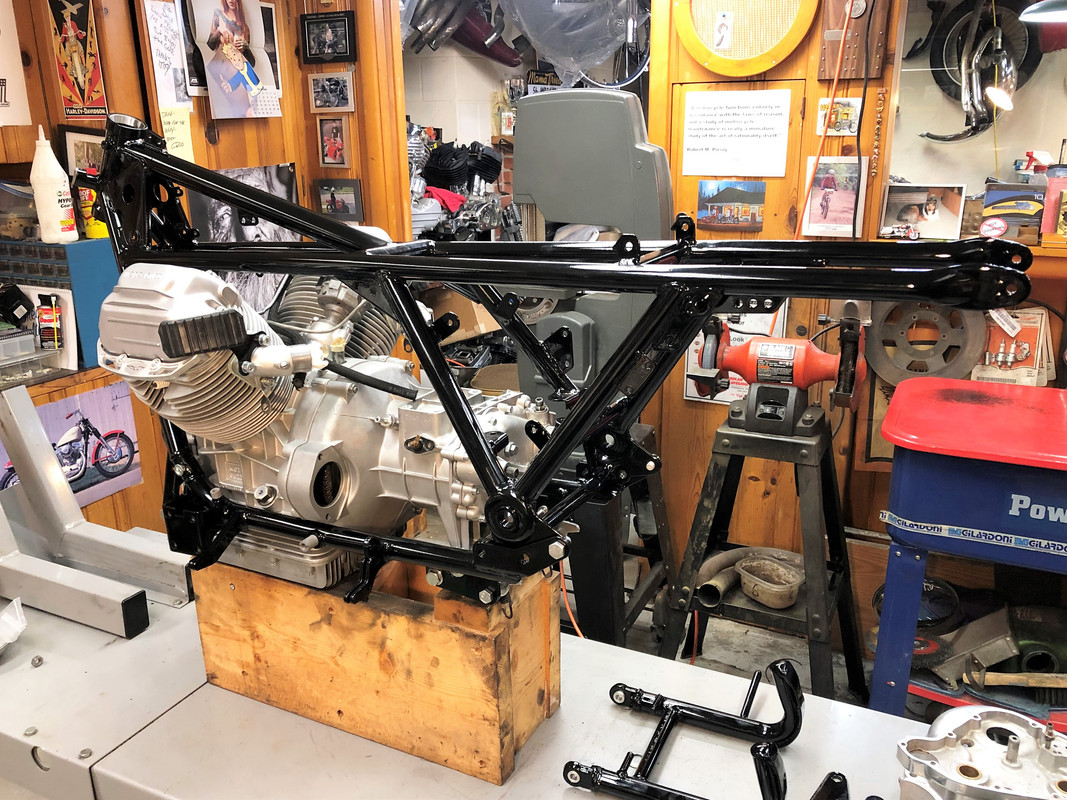

« Reply #128 on: December 20, 2020, 06:06:39 PM »
It is always great to get the frame off of the floor and onto the bike!  AHHH.
