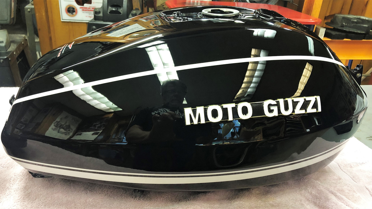

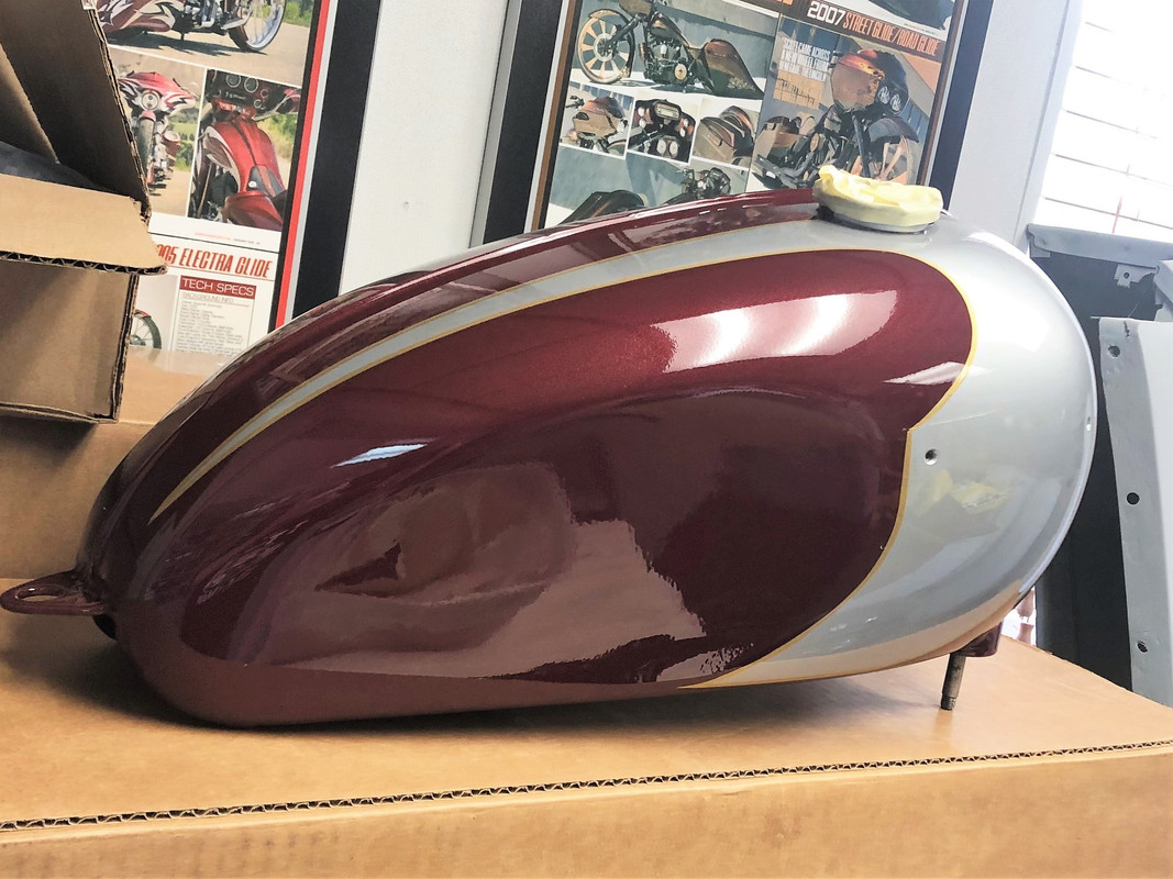

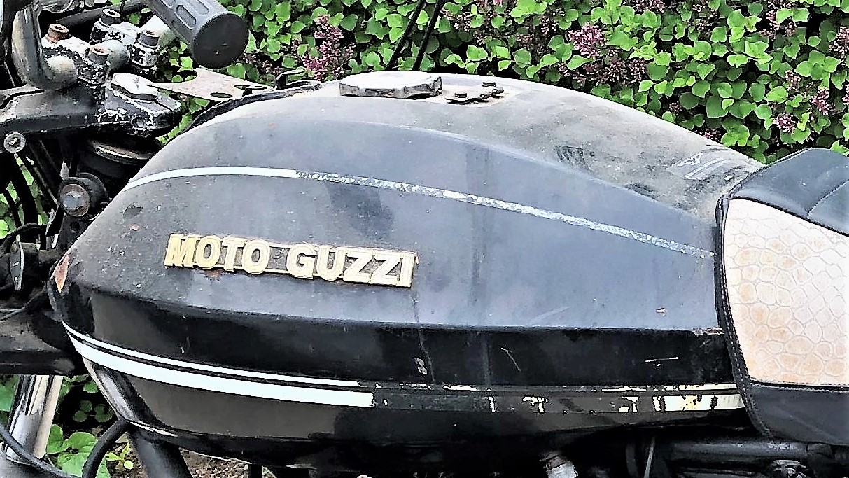

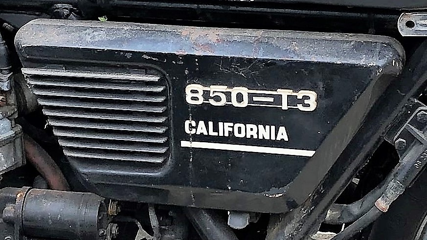

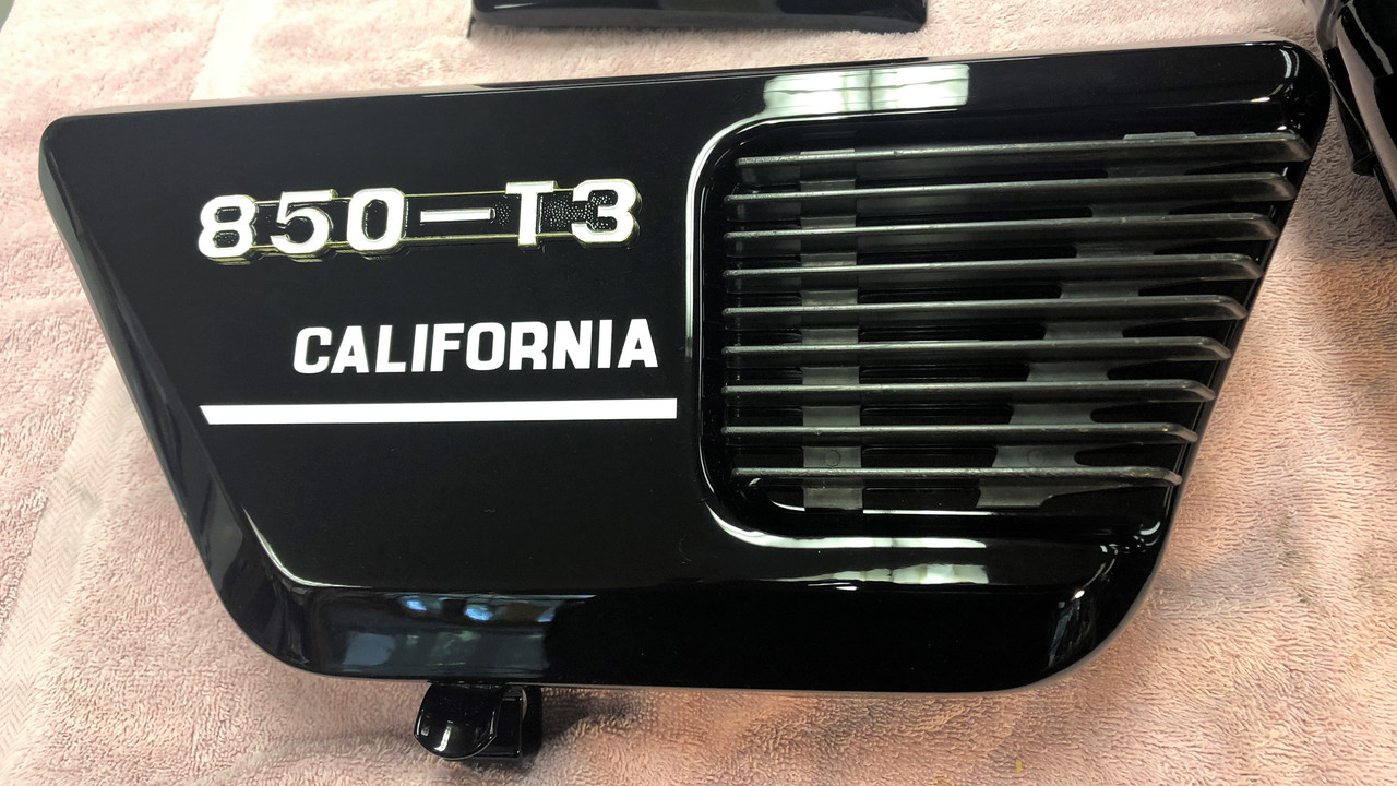

Super stoked.  I picked up the tank and side panels today.
Before
After
LesP
Re: T3 California Restoration
« Reply #32 on: August 17, 2020, 04:35:02 PM »
Fantastic  :thumb:  (1970 Bonneville ?)
  • Posts: 4871
« Reply #33 on: August 17, 2020, 05:55:21 PM »
He said 69.
  • Posts: 15237
« Reply #34 on: August 17, 2020, 08:41:43 PM »
Nice! Who did the paint?
  • Posts: 4871
« Reply #35 on: August 17, 2020, 10:33:06 PM »
My go to painter for all my bikes, Craig the owner of Paintworks in Loves Park, IL.  I am blessed to have him 5 minutes away from my house.

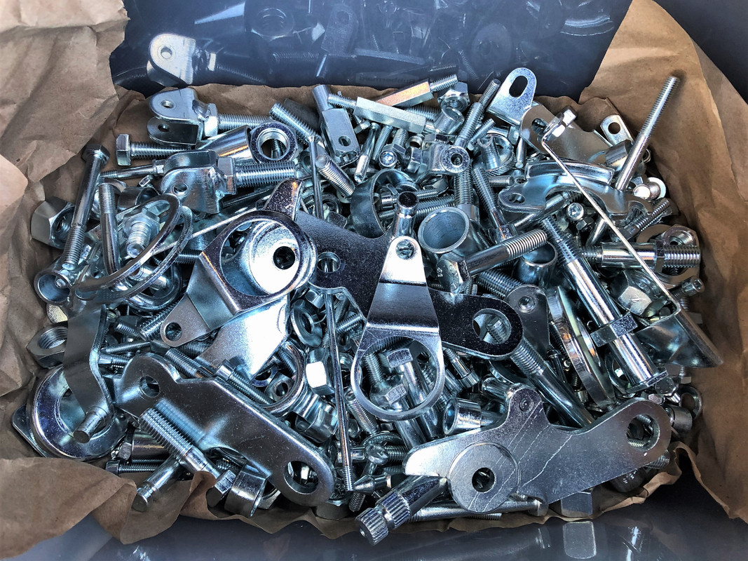

Zinc plating is back.  I combined the Lemans and the California in one batch.  It still met the $75 minimum charge.
Offline Groover
  • Posts: 2952
    • Scooteropolis
  • Location: Columbus, Ohio
« Reply #38 on: August 21, 2020, 07:20:49 AM »
All looks great, loving that pile of freshly zinc plated hardware. Some of those parts were originally chromed, right? How do they handle all that, you take them the rust and dirty hardware and they ?(sandblast)? then zinc coat them, or did you have to take it them in clean? The reason I ask is because my powder-coated charged me an extra 50 because my center stand was oily/crudded and he had to give it to another place where they dipped it to clean it first as he wouldn't run gunky stuff in his sandblaster setup - fair enough I guess..

None of the parts I sent for zinc plating were chromed.   I set those to the side.

Emblems and trim pieces on!  WOW! Are these nice!  If I do say so myself.   :grin:
Offline Groover
  • Posts: 2952
    • Scooteropolis
« Reply #41 on: August 22, 2020, 08:04:03 PM »
Agreed, great paint job!

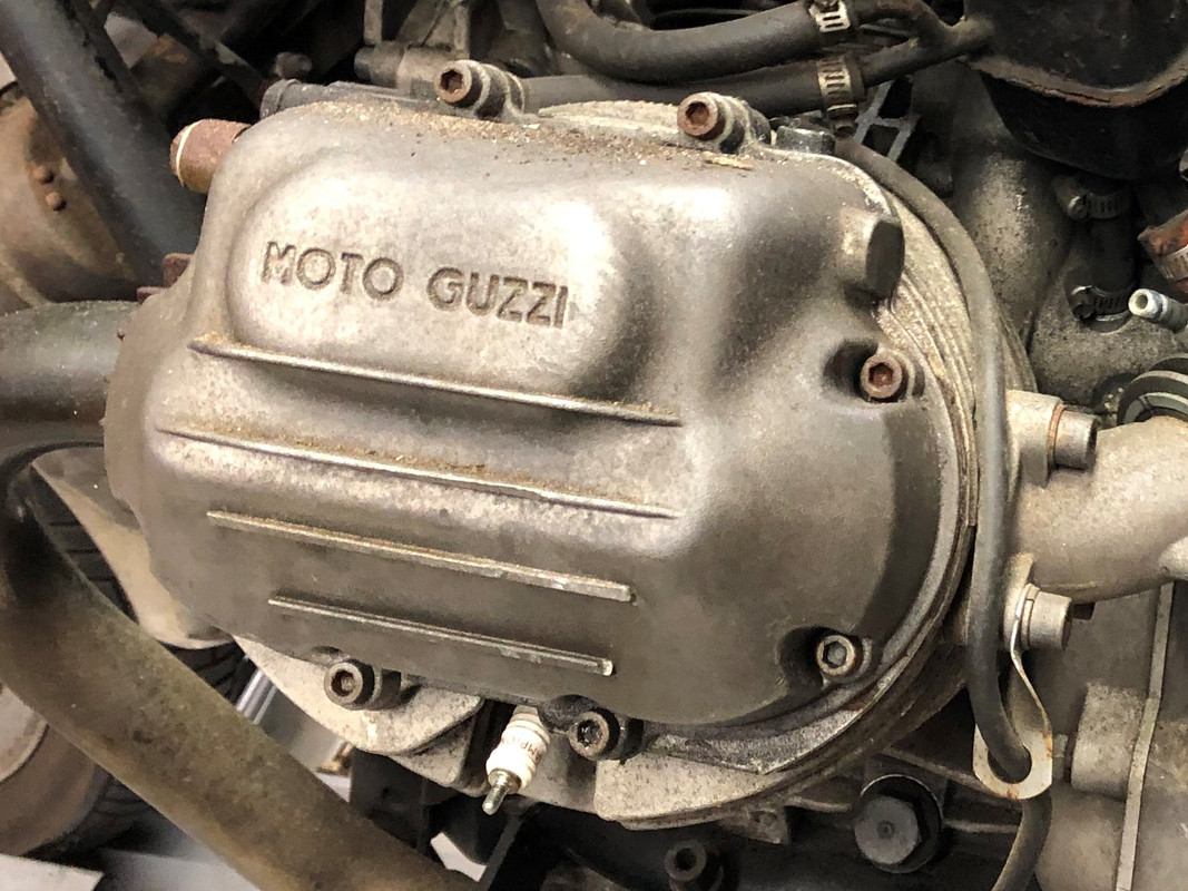

Before
After
The whole engine will have this appearance eventually.

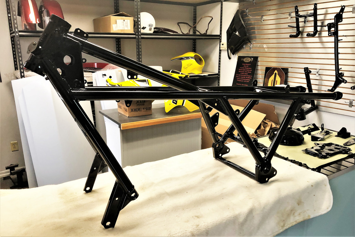

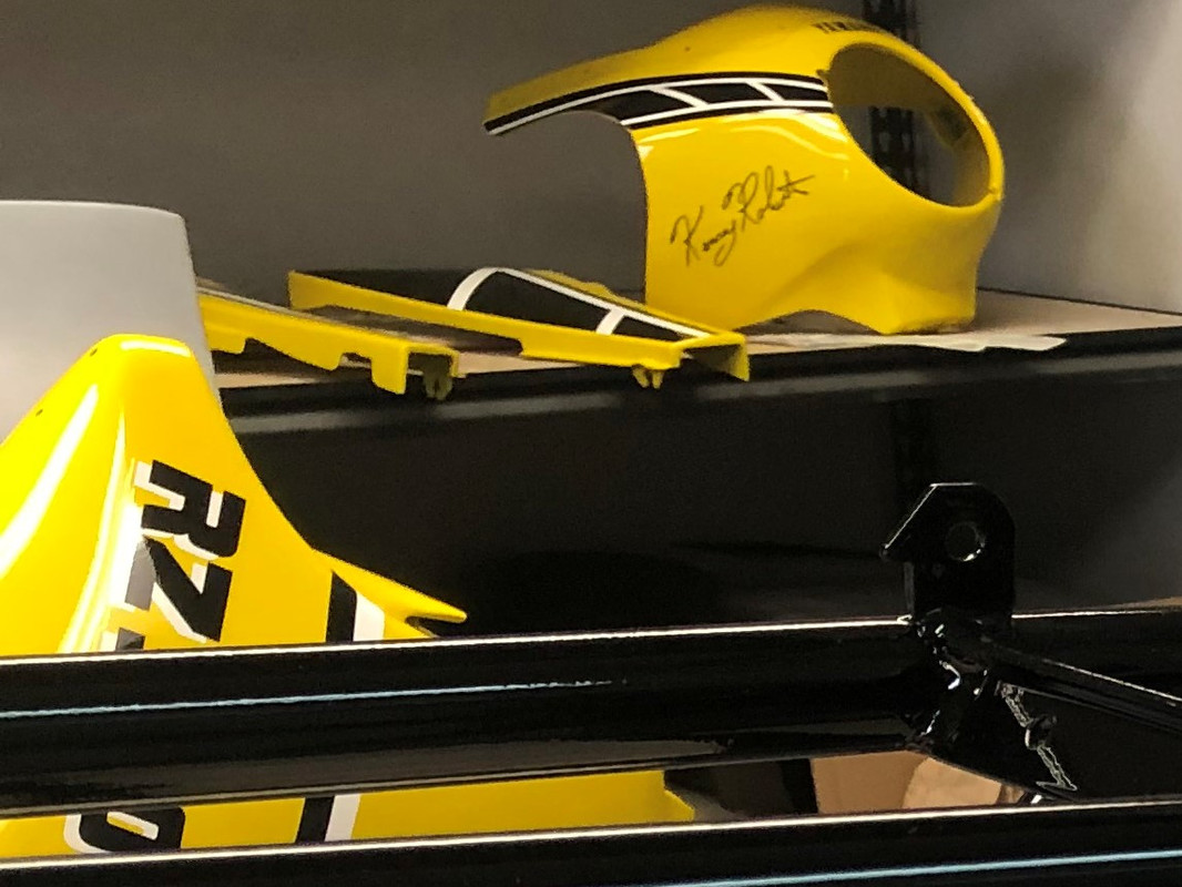

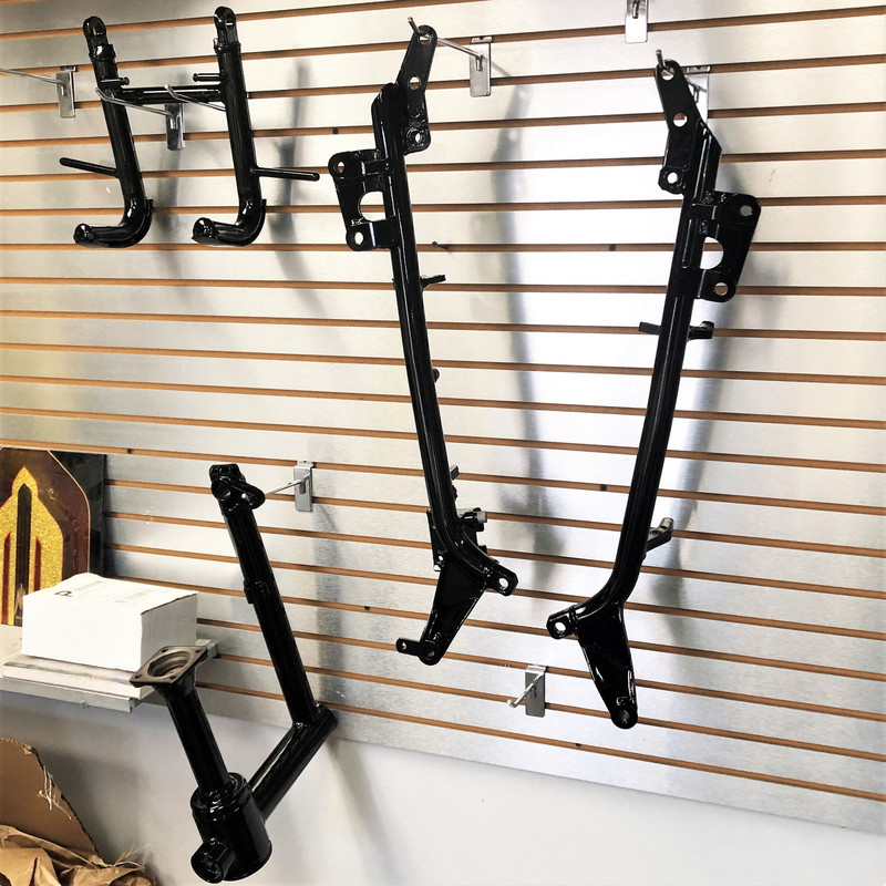

A very nice step to have complete.  I picked up the frame and other black bits today after blast and paint.  Another great job performed by Paintworks!
LesP
« Reply #49 on: September 26, 2020, 05:15:59 PM »
Fantabulous Dave.  :thumb: :thumb:
RD bits on the shelf ?
  • Posts: 4871
« Reply #50 on: September 26, 2020, 06:03:10 PM »
RZ bits.
Craig is also working on this 70 Bonneville tank.

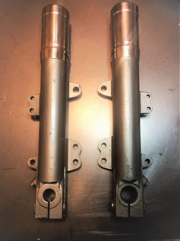

I sprung for a set of NOS fork lowers from Harpers.  The old ones are quite beat up.  These new ones have some shelf wear but will be much easier to deal with than the old.

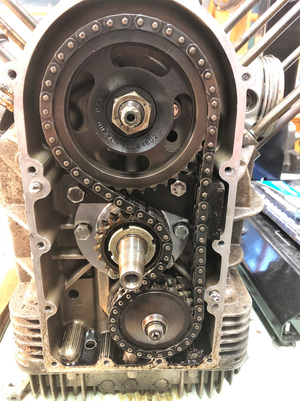

Now that the Lemans is about as far as I can go until I can ride it I am looking forward to tearing into this filthy beast to see what I have.
  • Posts: 15237
« Reply #53 on: October 24, 2020, 12:17:00 PM »
What's going on where the studs thread into the crankcase? It almost looks like Helicoils or maybe just o-rings?
  • Posts: 4871
« Reply #54 on: October 24, 2020, 01:18:36 PM »
Orings.  It seems as though whoever last assembled this went overboard with orings!!

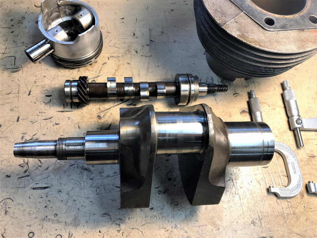

  • Posts: 4871
« Reply #55 on: October 24, 2020, 05:02:36 PM »

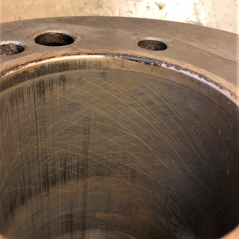

Engine teardown and inspection complete.   Pleased to report that the crank is on it's original grind and still in good shape - all dimensions within spec.  All the front/rear and shell bearings are in fine shape.  Camshaft lobes look excellent.
This engine was overhauled when it had about 100k+ miles by Moss Machine in San Francisco.  The rings and main bearings were replaced.   After conferring with Charlie it seems like these  barrels were Nigusil plated by Moto Guzzi.  1980 was the timeframe that Nigusil began.  The barrels have a slight magnetic pull.
It appears that the shop used a coarse ball hone when they gave it new rings.  The crosshatch is pretty heavy!  This also implies that the barrels and pistons have 130k miles on them.  I will replace them.
« Last Edit: October 24, 2020, 05:05:08 PM by Dave Swanson »

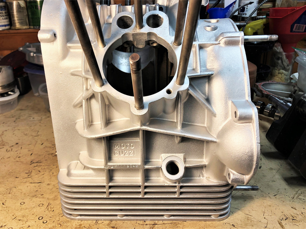

Now this looks a bit better!!
  • Posts: 15237
« Reply #59 on: October 28, 2020, 08:39:02 PM »
Nice!
