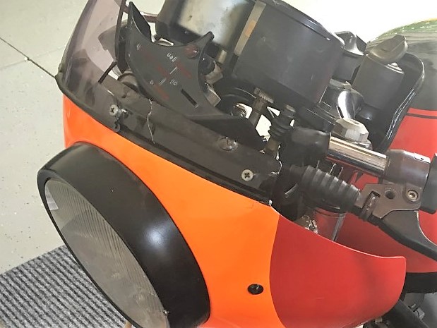

I purchased a nice Lemans last fall.  It is a good solid unit.  It had some cosmetic issues.  The primary issue was damage to the fairing and instruments from having another bike knocked over into it.  The bike has a fairly interesting history that I will get into as the thread progresses.
The bike had been gone through by Joe Eish a number of years ago and ridden very little afterwards.  In fact the owner never transferred the Lemans into his name.  When I bought the bike it still had the prior owner's Arizona license plate with a 2004 sticker.  The prior (prior) owner from Arizona was Alan Trachtman.
Without any documents from the Eish regarding the work performed I guessed that the bike had a pretty thorough going over.
The engine cases had been cleaned up.

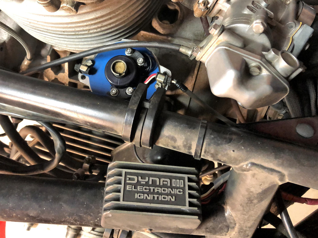

And a Dyna III ignition had been installed.

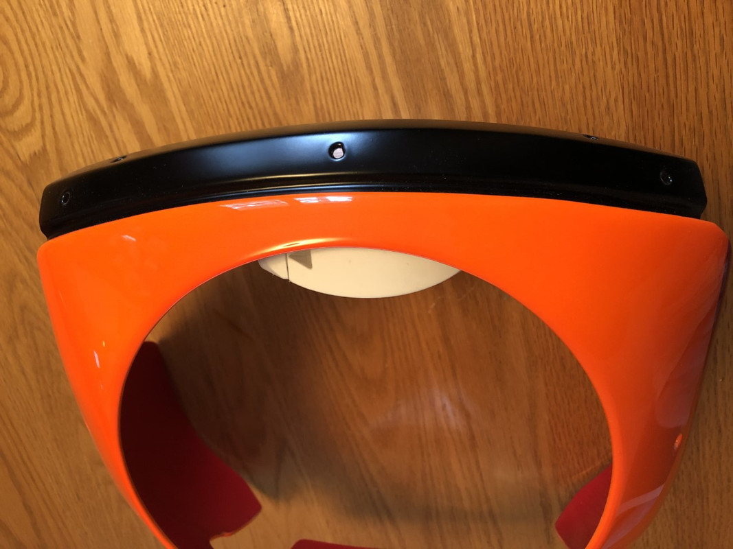

I had the fairing repaired and repainted.
Before
After
And had Palo Alto Speedometer Service restore the clocks.
Before
After

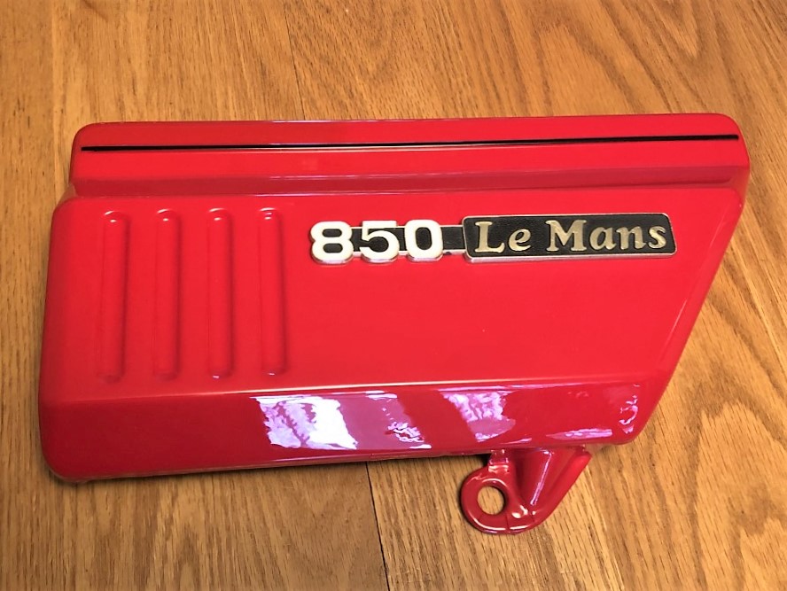

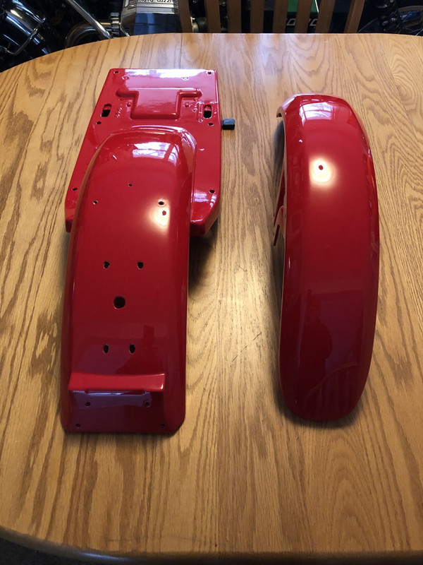

I also had flaws in the paint fixed.  This was not controversial because it had been resprayed at one time and it wasn't a top notch job.  If it had retained it's original paint I would have left it alone.

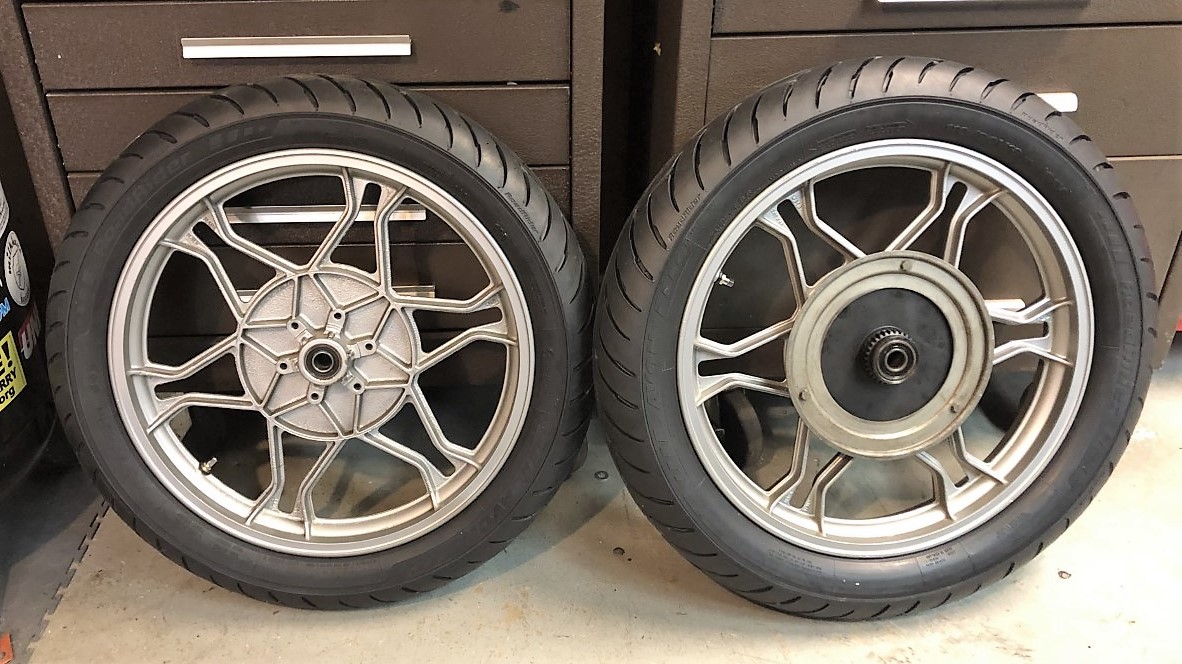

The wheels are in great shape.  Big relief.   New rubber and converted to tubless.   The early Lemans all had tubes for some reason.
This was my first experience using RuGlide for a tire lubricant.  I can highly recommend it.  And it is the perfect time of year to leave the tires in the sun for a few hours to warm them up.  The tires went on easier than any other.

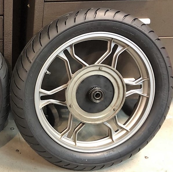

The rear wheel has a new plate with drive spline.  I sprung for new cush rubbers to go with it.
