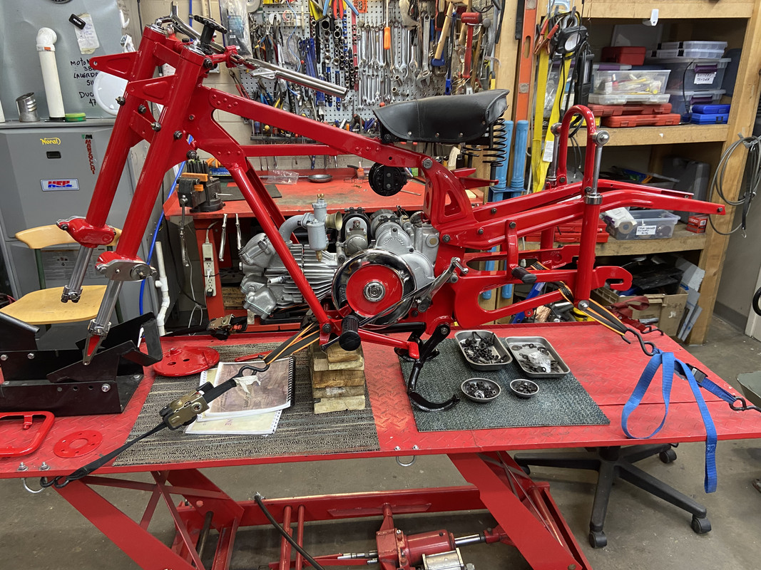

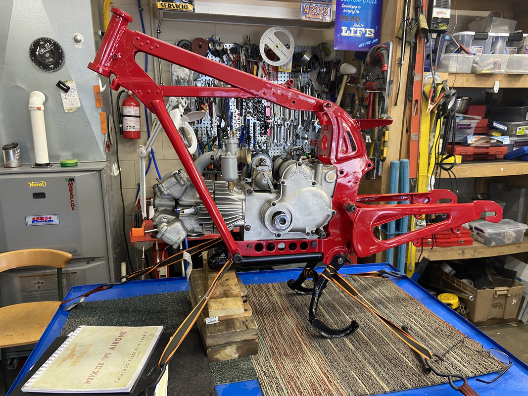

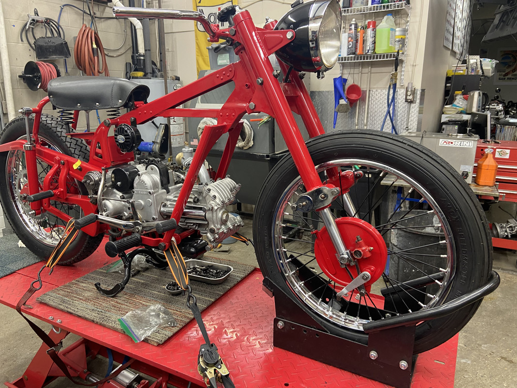

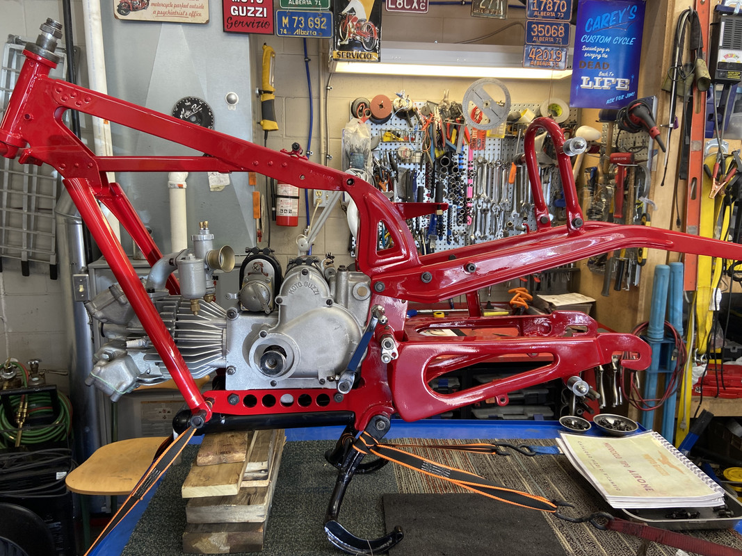

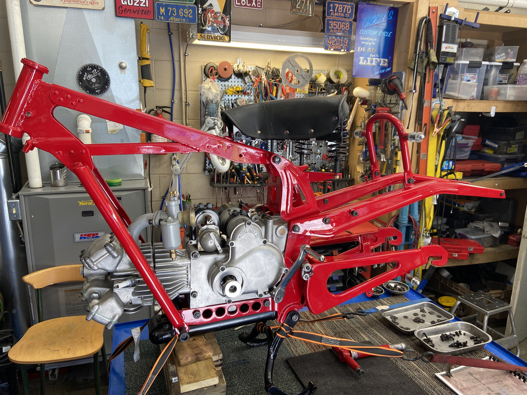

I got some of the frame pieces back from my painter, enough parts to get started with the reassembly. These frame realted parts are painted in single stage enamel.
The fenders, gas and oil tank, tool boxes and leg shields will be painted base clear with the hand painted pinstripes and decals applied prior to the clear coat.
I cut cork rebound dampers and used two part epoxy to glue them to the swing arm.
Lots of threads to chase and openings to be cleaned out for bolts to pass through
Center stand mounted then the spring box went on, the long bolts passing from the back of the swing arm pivot and through the frame, installed the inner and outer springs and the spring retainers and lock nuts

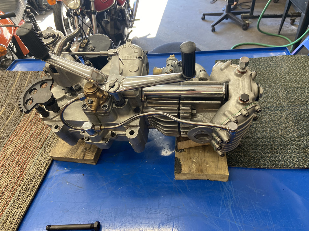

Then I laid the motor on its side and blocked it up and then laid the rear frame / swing arm on its side and slid the frame section over the motor mount points, passed some dowels through and stood the frame / motor up

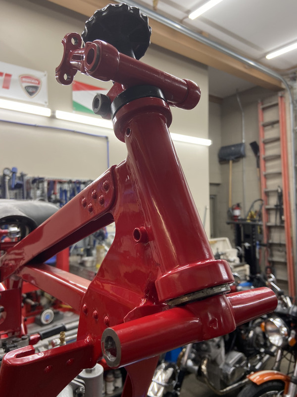

Next I installed the front frame section, waiting on the brake pedal and spacer for the main lower bolt that passes through the lower frame and spring box tabs, this will hold it for now
Just the begining of many things to assemble

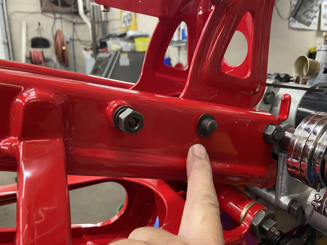

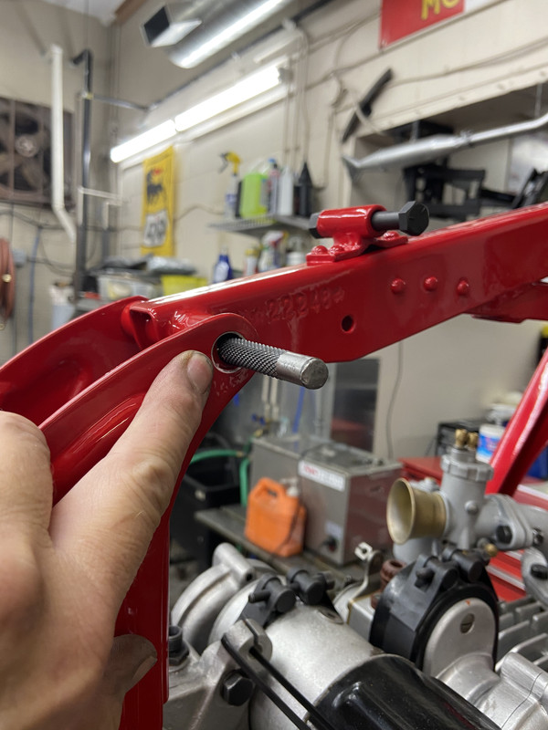

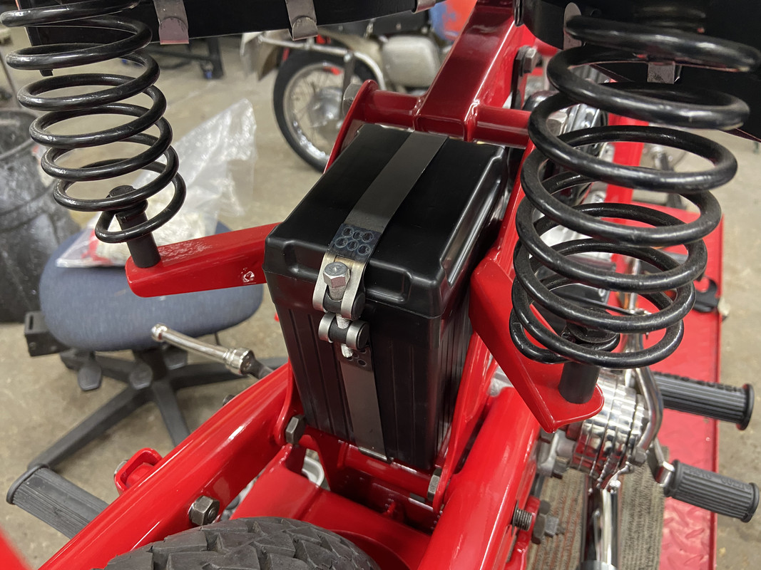

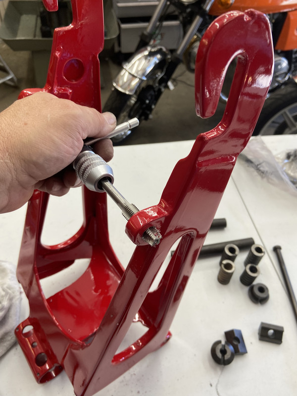

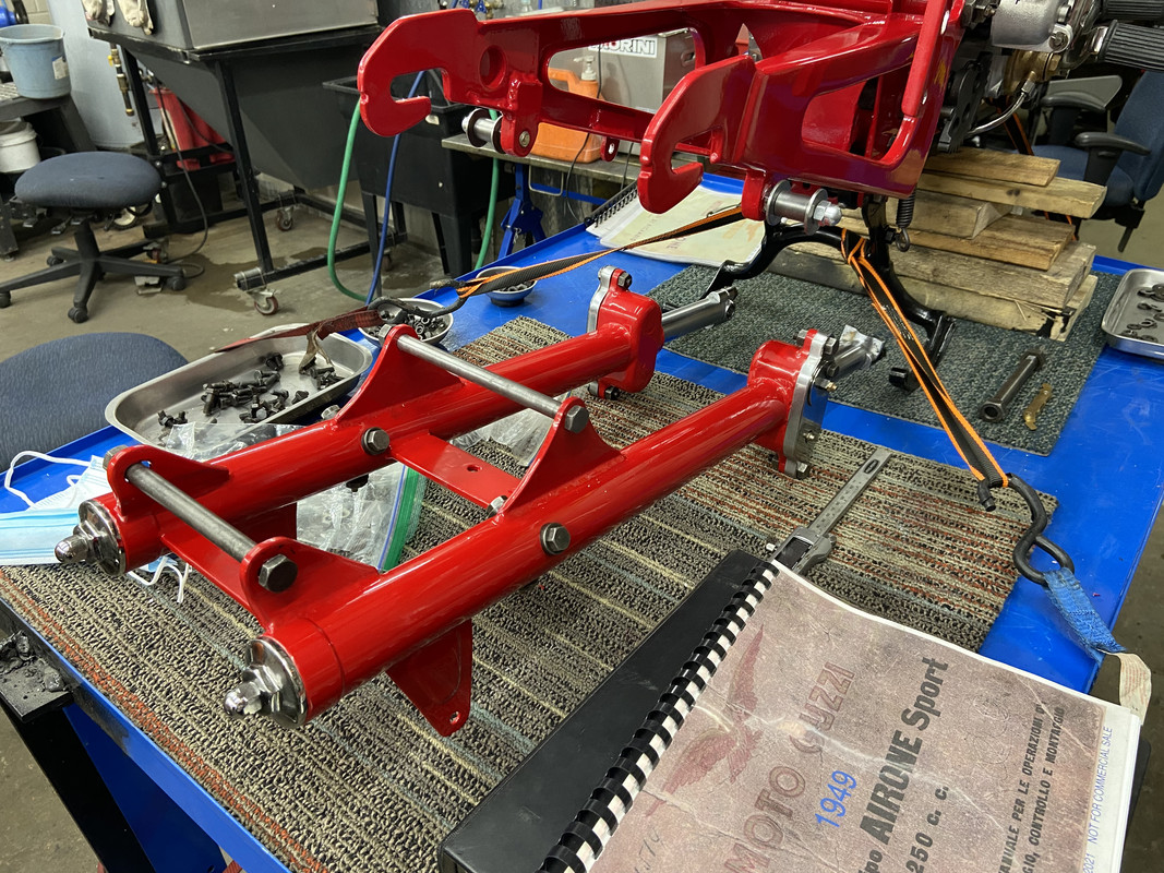

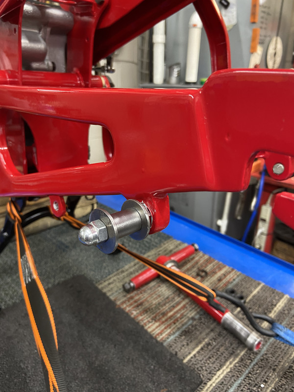

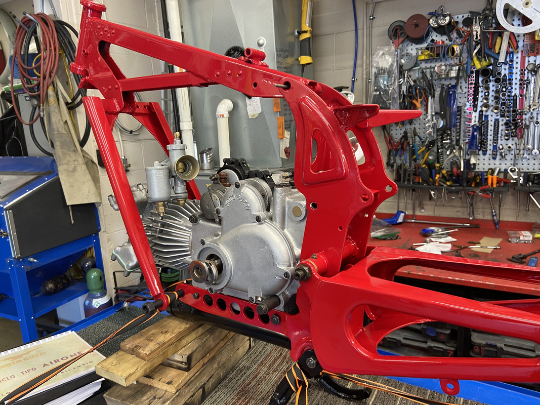

I got the rear frame rails on today and the shock mounts, had to hone out the new shock bushings to fit over the rechromed shock mount studs, fiddley work to get a nice snug fit.
Once again the shop troll had made off with some original parts, I carefuly dissasembled, tagged and bagged every part and took plenty of photos but after emptying every parts box and bag I can not find two of the M11 X 1.25 nuts that secure the rear frame blades nor the 12mm stud and nuts that secure the top of the frame pieces together, very frustrating, no doubt they will turn up in a year or two!
I made a new stud from stainless bar and threaded the ends to take M12 X 1.5 nuts I had
Anyone have a source for these missing M11 x 1.25 nuts, I hate to place an order with Retro for two nuts!

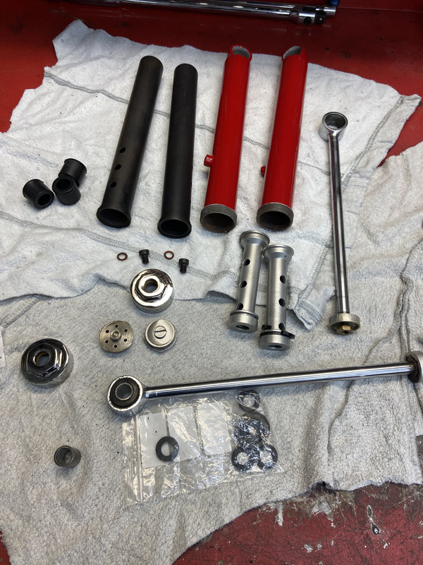

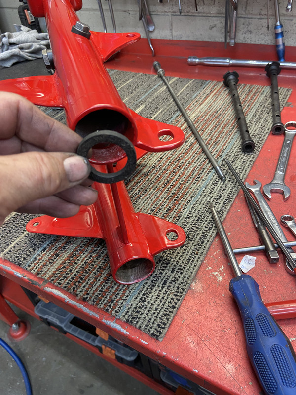

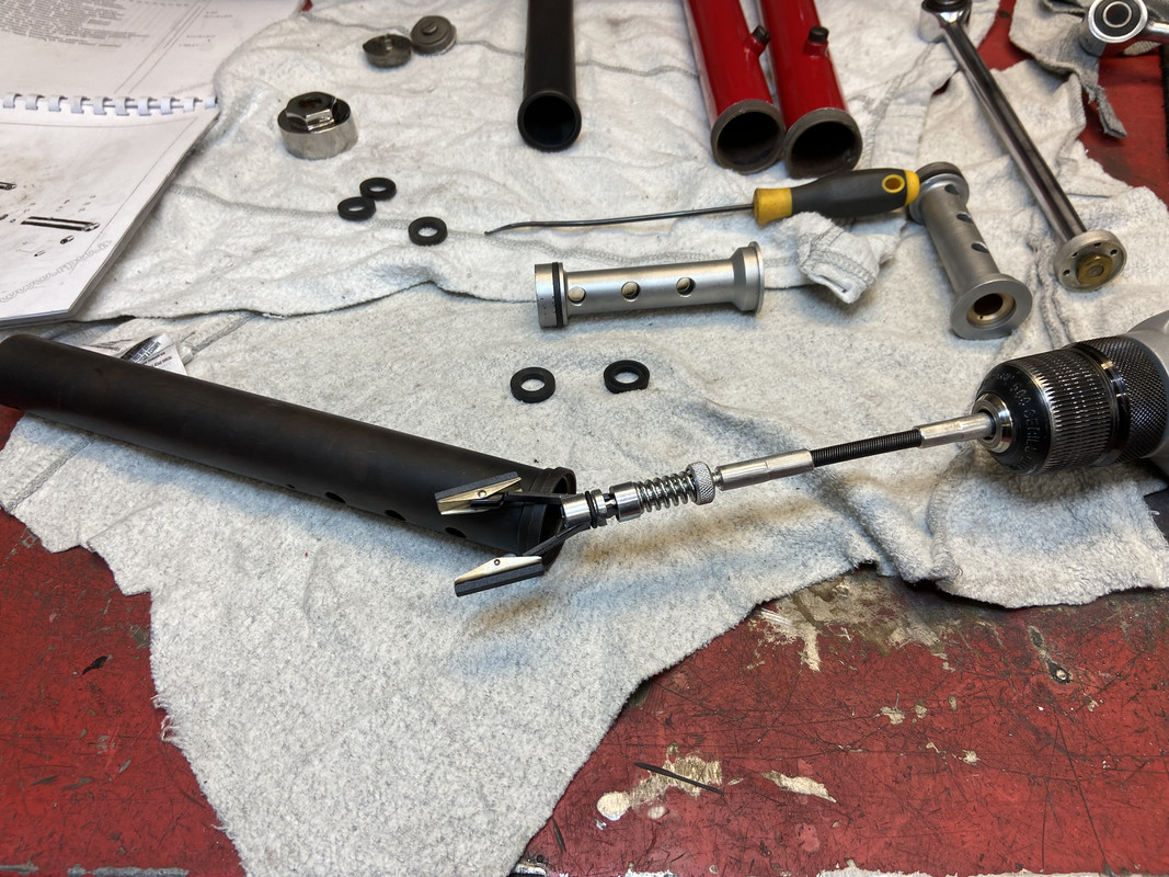

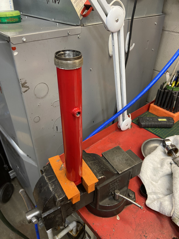

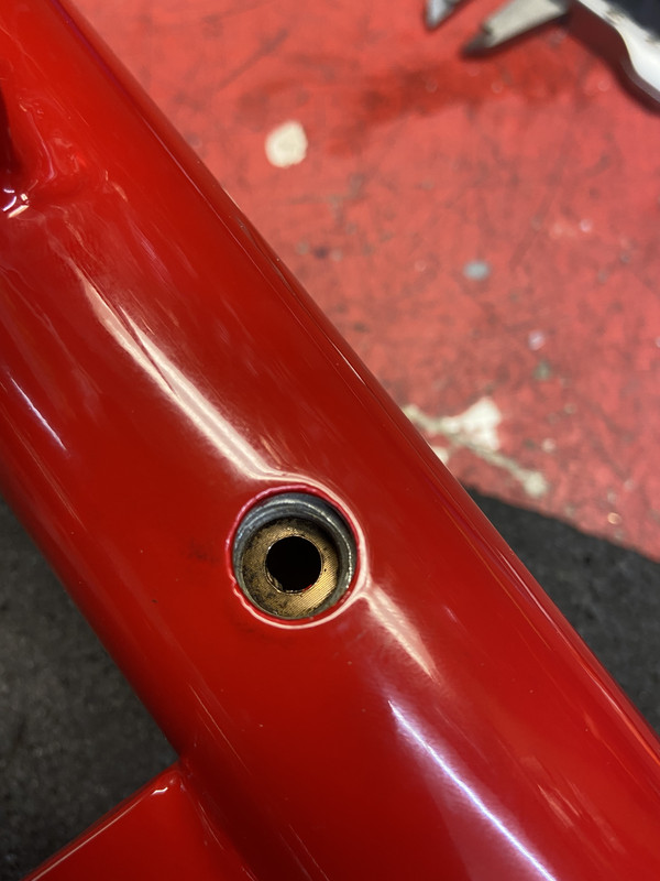

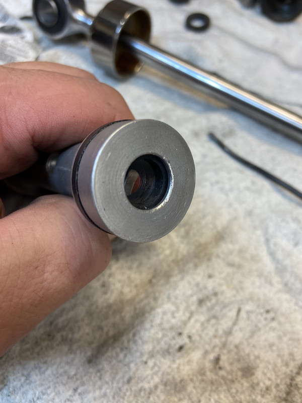

I emptied a bin of front fork parts today. I took many pictures during dissasembly but still scratched my head figuring out the reassembly sequence, the manual text is ok and parts diagram is quite clear but the sequence is critical.

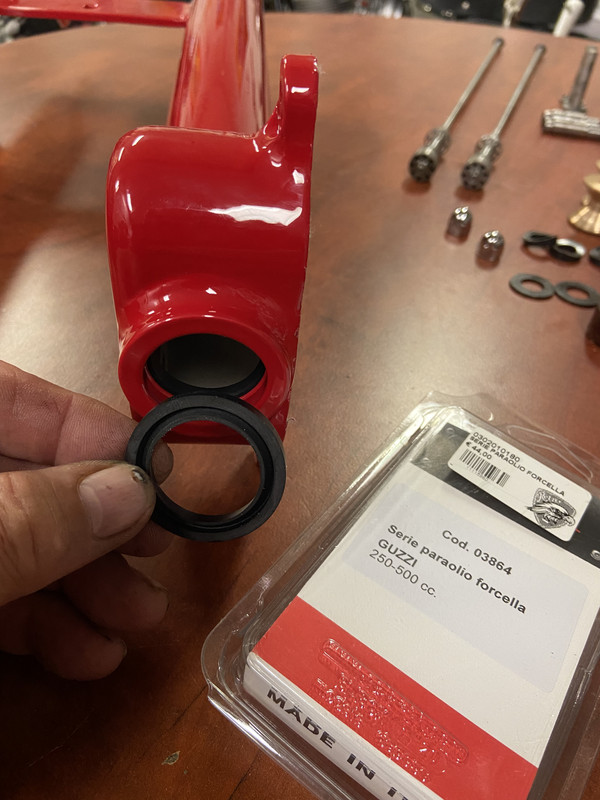

I started with a new rubber seal kit from Retro; two rubber cup seals for the bottom of each fixed fork leg and two rubber seals for the plunger rod guide tubes.
The Guzzi fork design is quite brilliant and very robust, the forks are shared between the 250 and 500cc bacon slicer bikes with the hydraulic front end. The forks are of the upside dwon design, the lower fork tube slides up and down guided by an upper fixed bronze bush in a steel retainer body and fastened to the fixed upper tube with three machine screws, one of which is hollow and takes a grease zert. The lower section of the moving tube runs between bronze guides, one a roller and the other a concave cup, the roller is adjustable by rotating a cam shaped axle. The moving fork lower tubes are hollow and they contain a damper rod with hydraulic valve, the fork tubes are partially filled with fork oil. The damper rod runs in a hollow tube that threads into the top of the sliding lower hollow tube and is limited in movement by the upper bush.
The lower seals

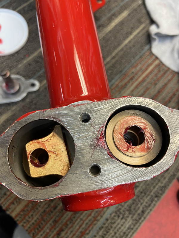

The lower bronze guides, I replaced these with new sets as the olr ones had worn flat spots,

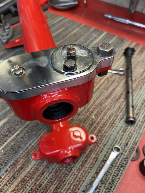

The roller and cup are secured with axles that are cenetred in the removable alloy plate, the roller has an ecentric axle, each axle is hollow and has a grease zert
A  steel plate sits on top of the eccentric axle, then a chrome cover plate followed by a chrome outer coverwasher for the eccentric and a lock screw to set the eccentric once the roller cup is set to the lower fork tube

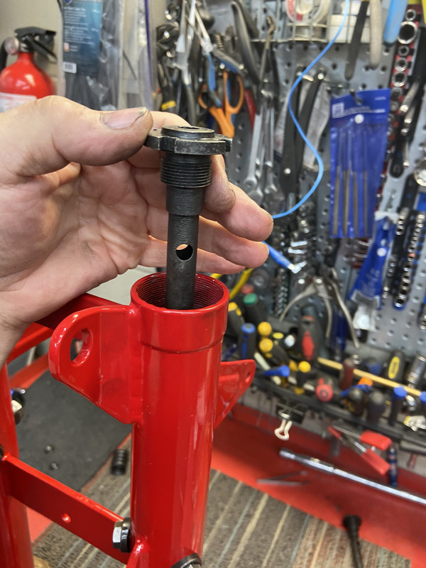

Then the lower fork tubes are stood up and the fork damper rod inserted, the manual says to fill the tubes to 260mm from the bottom of the fork tube.
The fork tubes is inserted from below, there is a left and right lower leg, then from the top the spring bottom stop is dropped down (champher down) followed by the spring and then a hard plastic spacer

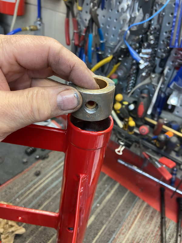

Next the upper fork bronze bush goes in, the bush needs to be pushed down with a steel bar and aligned with the holes in the fixed fork leg, then the three concave washers and screws are insatlled
Once the bush is secured the fork damper guide drops in from above and it is threaded into the top of the lower moveable fork tube. The damper guide has a four sloted face top that takes a special socket, its the same one used on a Guzzi Loop Frame front crankshaft timing gear, I cut the socket in half and welded a section of matching diameter tube to make a very deep socket to tighten the damper holder

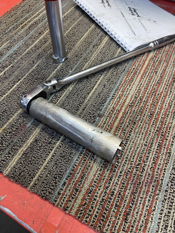

The home made deep socket
Hold the lower leg in a soft jaw vice and tighten the damper rod holder, now the fork lower tube is secured.
I just have to clean the internal threads on the top of the fixed tubes then I can insert the short rebound springs, thread in the caps and finish with the dome nuts over the tips of the damper rods sticking out the caps.

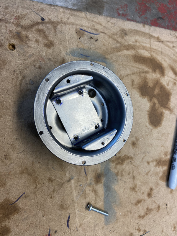

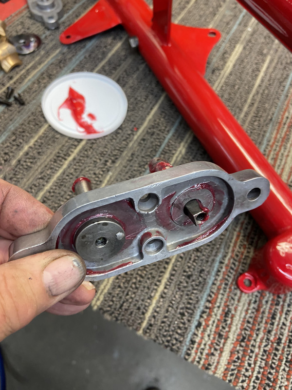

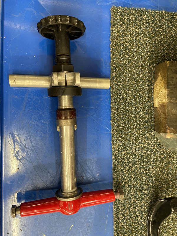

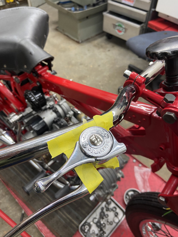

Another Guzzi design feature that is new to me, the steering damper
Turning the bakelite knob pulls a rod through the fork stem, at the bottom of the rod a sloted dowel carries a flat steel blade that engages two rings, one steel and the second one a hard plastic, the hard plastic ring presses up against the upper bearing cone creating friction
a nice piece of engineering, no idea of how effective the design was / is?

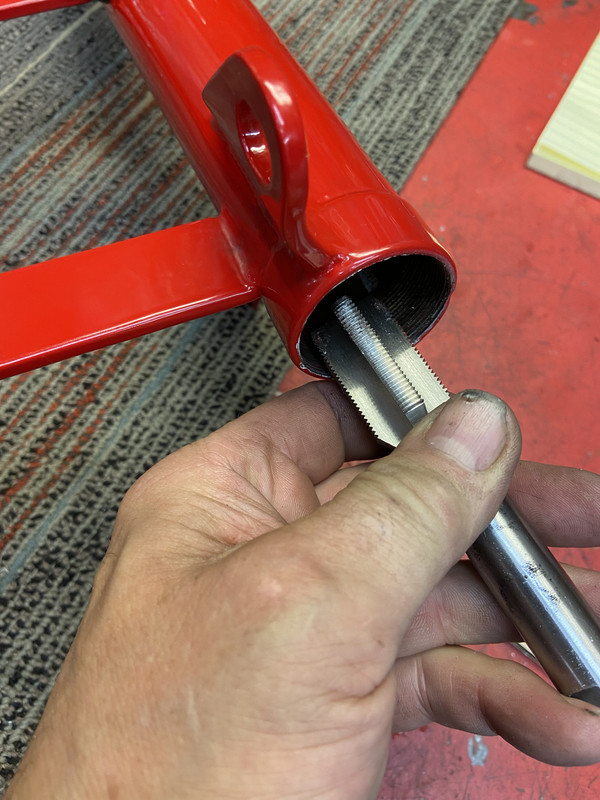

to clean out the fork inner cap threads  used a large tap with a 1.25 pitch,

I couldn't find a source for 11mm nuts that hold the battery box into the GTV frame. Valenti shows them, but got case screws instead.  We went back and forth, but the 11mm bolts and nuts never showed up.  Eventually I reamed the holes for 12mm bolts.
McMaster Carr shows m11x1 and m11x1.5 taps, but not x1.25.
https://www.mcmaster.com/metric-taps/system-of-measurement~metric/thread-size~m11/
I might have a couple of m11x1.25 nuts, but not sure the treads are any good.

Thanks Shaun, I have sent an email to Retro asking for the 11mm nuts and I ordered some 11mm taps and dies off EBay from China. Hopefully Retro can help

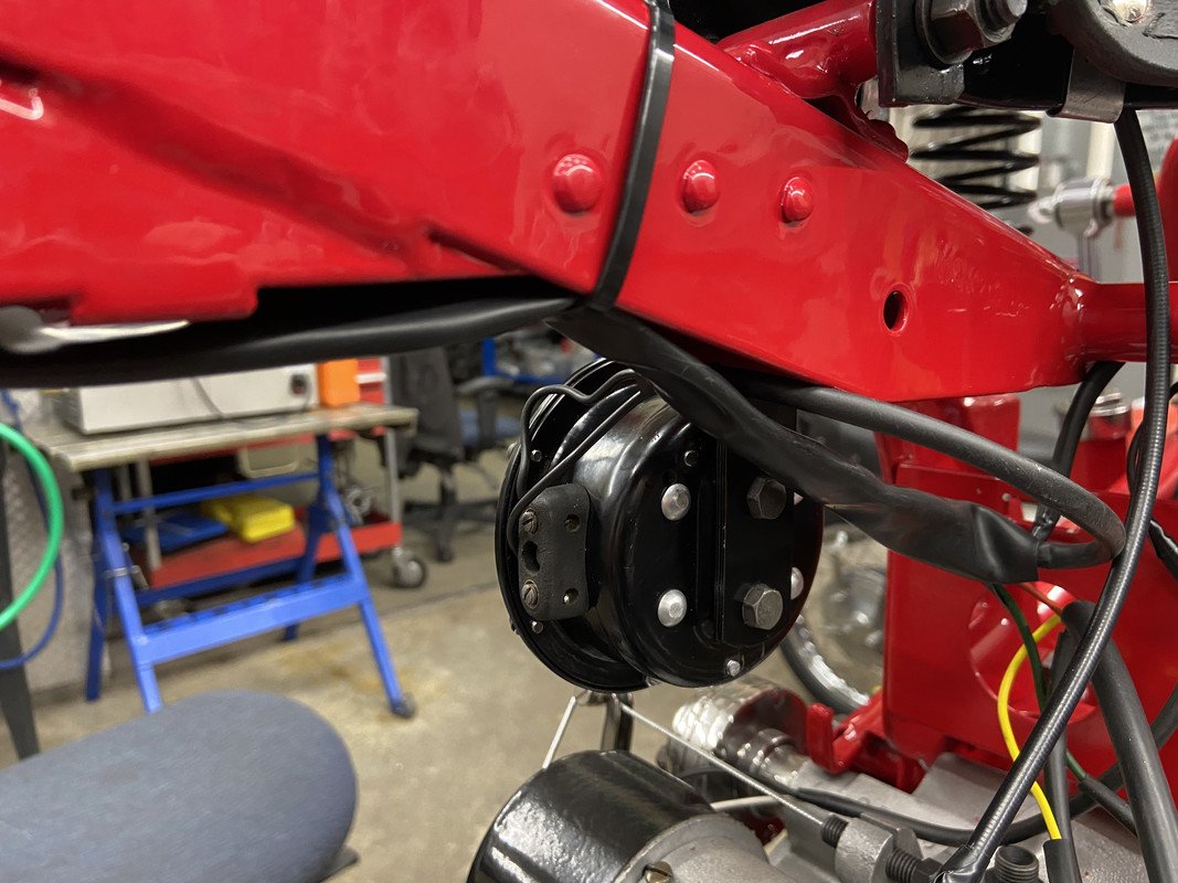

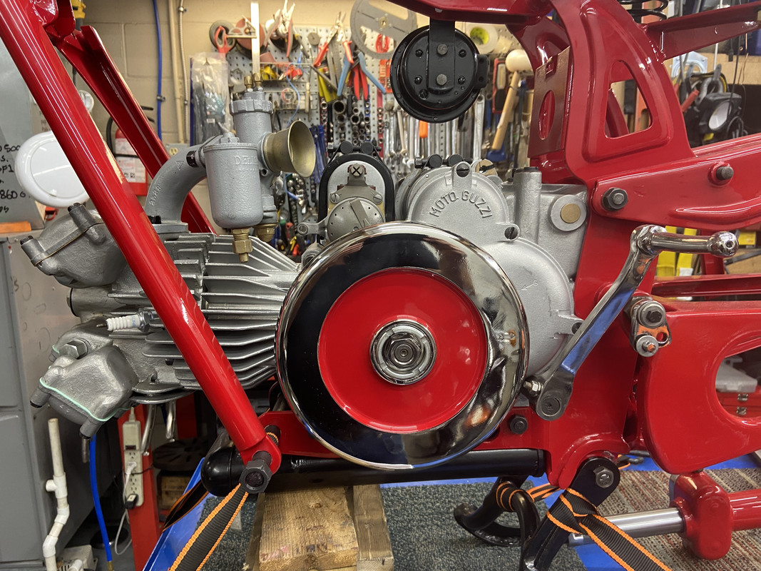

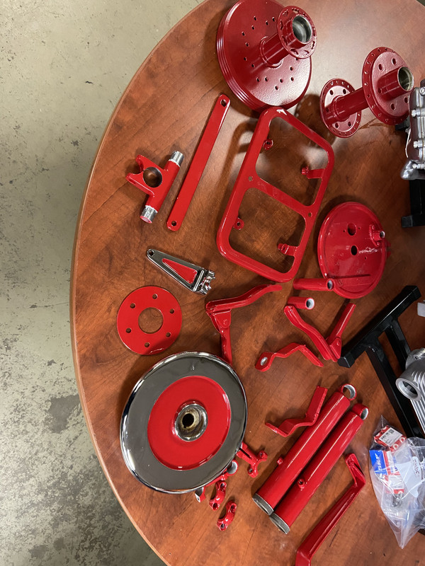

My painter called yesterday, the rest of the single stage enamel parts are ready, picked them up this morning, lots to continue with now, should get the fenders, tanks and tool boxes done by Christmas
I got just one piece back on but it is a big one in more ways than one, the 'bacon slicer' flywheel

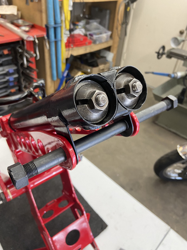

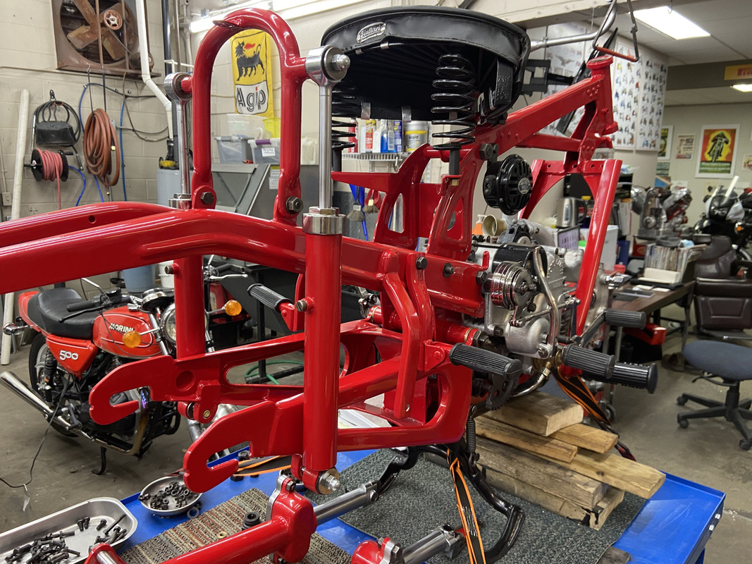

I assembled the rear dampers today, new seals, rubber bushings and bushing inserts from Retro
It takes a lot of fiddling to get the seals into these recess
Honed out the inner tubes
Then stood the lower body up, inserted the inner tube and filled with 30W until oil poured out the level hole, then inserted the damping rod, pushed down the rod until oil stopped flowing out and buttoned it all up
I had the caps and mounting spindles re chromed

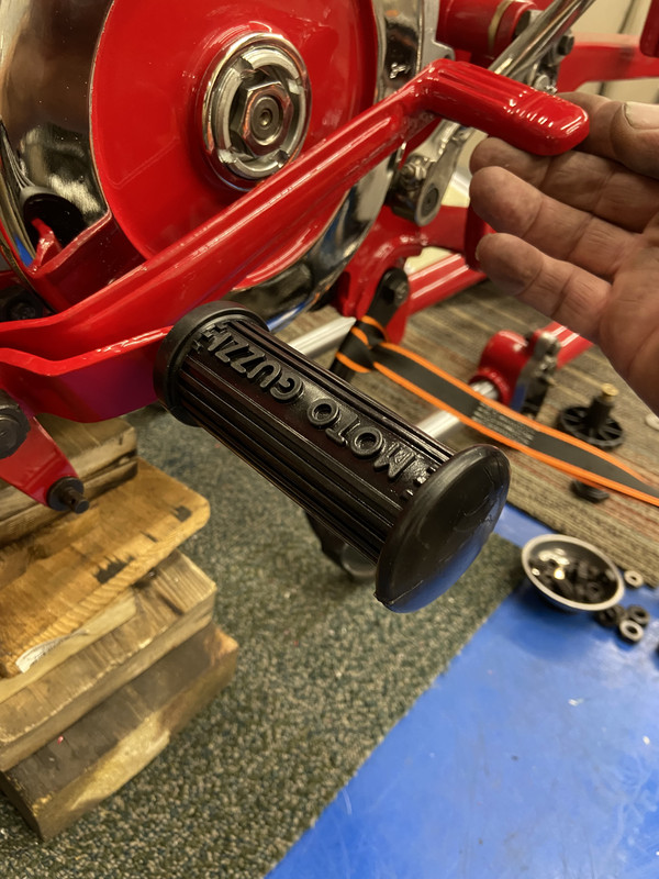

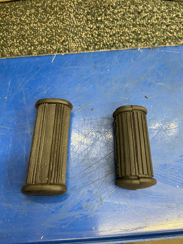

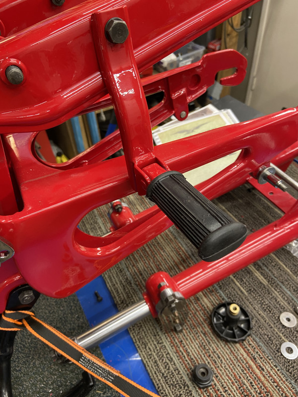

Got the front frame spacers, foot peg brackets and rear brake pedal installed, repro rubbers from Retro
The repro rear peg rubbers don't fit the Astorino so I reinstalled the original rubbers, the repros are far too short, original on the left
And that's it for today, have to pick up some more bearing grease to get the front steering together.

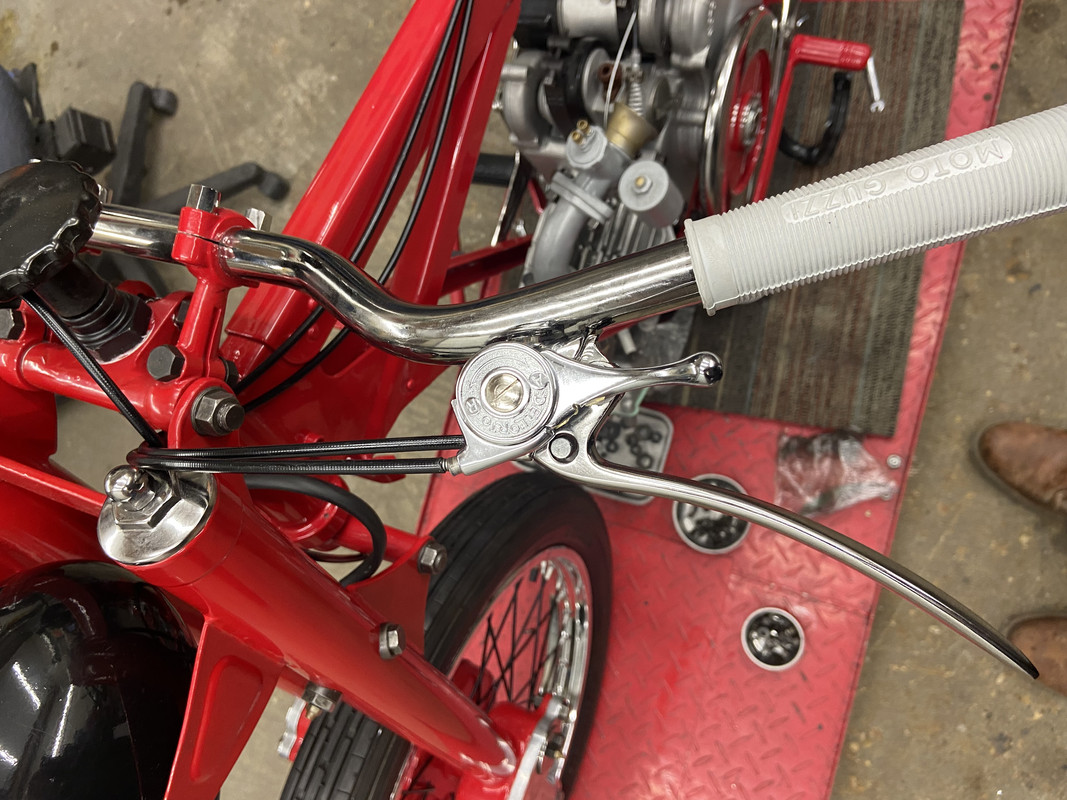

I picked up a tub of grease, greased up the cones and installed the 1/4" diamter ball bearings,
Then it was an easy job to hang the forks and install the handlebars

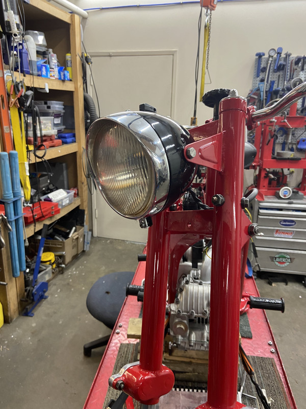

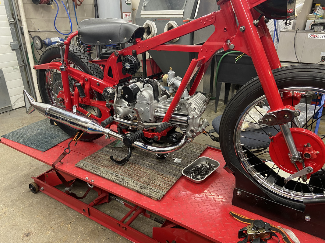

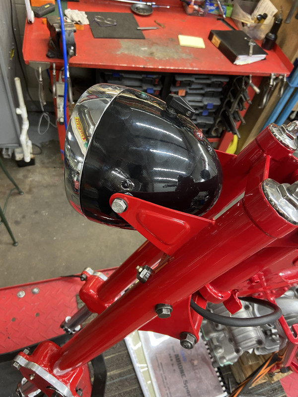

I got the headlight back on today, not much more than that, its a warm sunny day and time to go for a ride
Re: 1948 Airone - restoration
« Reply #168 on: November 30, 2021, 06:18:48 PM »
I finaly got some more parts back form the painter to continue with the Airone build, front and rear wheel hubs painted.
The rest of the sheet metal parts are getting close to final prime, my painter ground out all the high temp filler I had in the rear fender for powder primer and welded in new steel sections, I was reminded, firmly, to not help him out with my POS atempts at body work in the future.  :thewife:

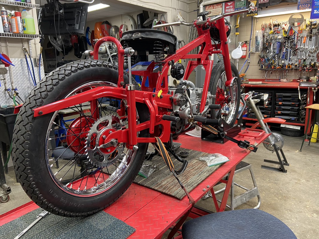

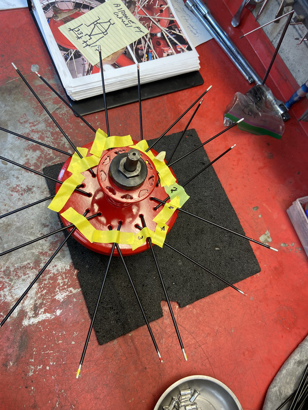

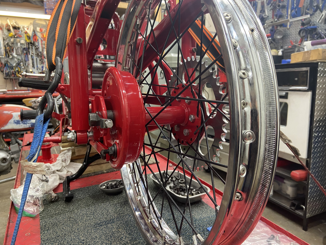

New beaings in the rear hub, replaced the felt grease seal, getting the rim spoked turned out to be a real pain in the butt, I have been lacing wheels this week for other projects and none gave me any trouble.
The Airone rear wheel is center aligned, no offset but of the 40 spokes ten are 4mm shorter and I had marked the location and orientation of the shorter spokes, stll upon lacing I must have placed the short spokes incorrectly as I had to strip the wheel a couple times and relace it to get it finished.
As the axle mut be installed with the hub prior to driving in the bearings I can not use a truing stand, fitting the brakes shoes was alos a bit of a pain, the brake drum pins that support the shoes were a bit bent, starightening them after paint was tedious, lots of adjustment to shoe ends and pivots before the shoes moved smoothly

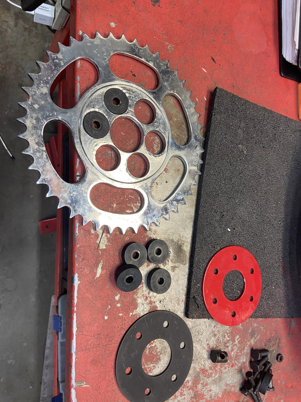

The sprocket has six rubber cush discs and there are two plates, one on each side of the sprocket that compress the rubbers, Getting the rubbers to only spread to one side of the sprocket took some time to figure out, otherwise the sprocket will not clamp down true to the hub
Brake drum and sprocket bolted to hub, I set the wheel in the frame
I will use the frame to true the rim
I am not looking forward to lacing the front wheel, it has a big offset from centerof the hub.

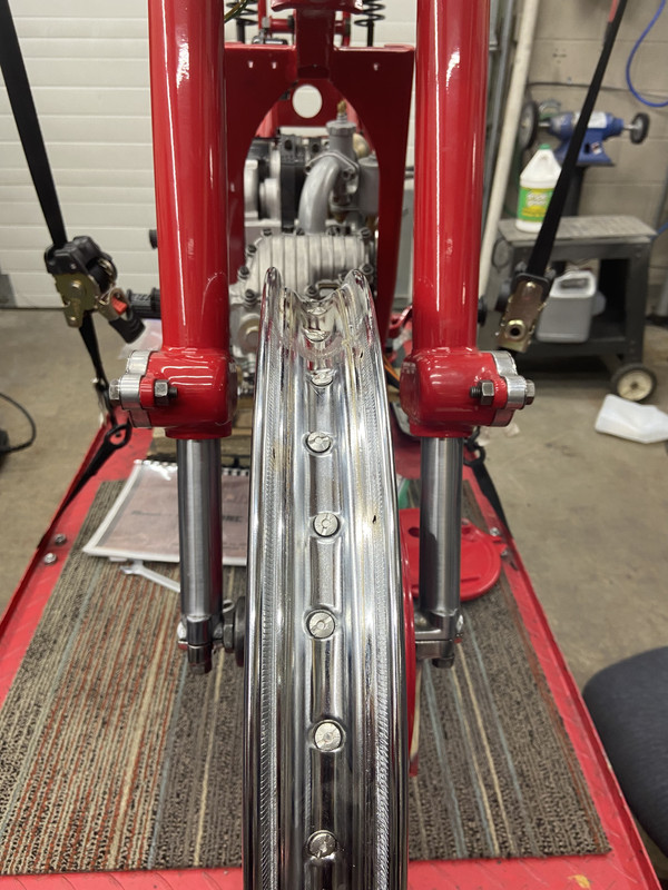

« Reply #170 on: December 03, 2021, 10:15:42 PM »

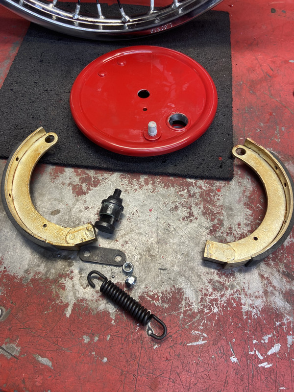

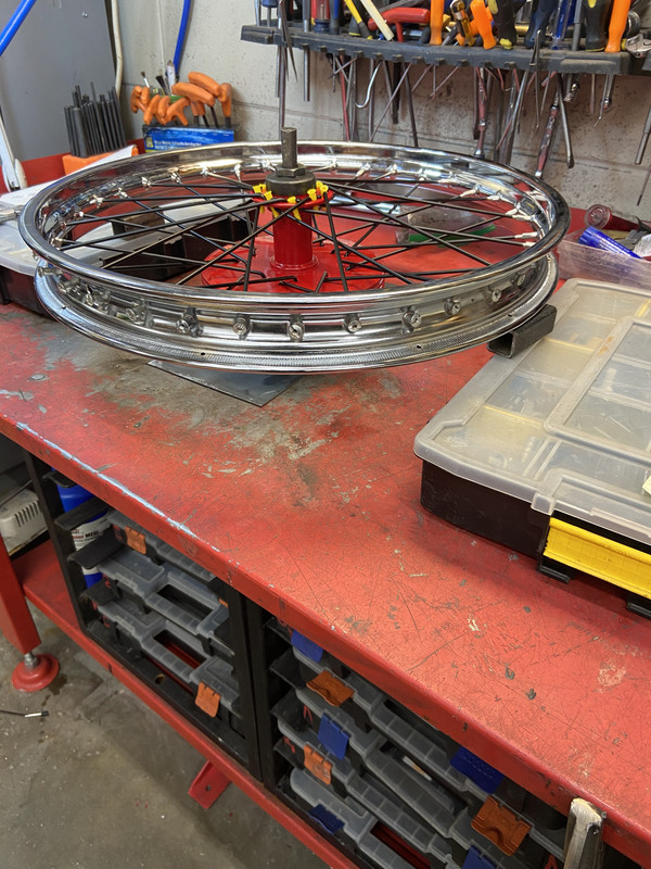

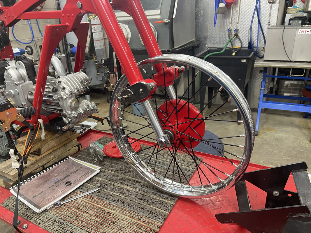

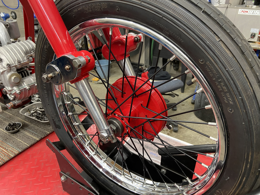

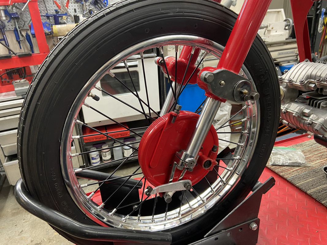

Rear rim sent off with an Avon tire to be mounted, I just don't trust my ability to mount a tubed tire without pinching and nicking the tube, had to many frustrating failures to bother anymore.

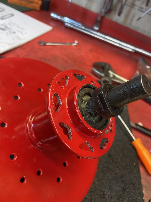

Assembling the front hub, both of the tappered roller bearings were worn out, these are the same as used in loop frame bikes, races pressed in and bearings greased
The felt seals were worn out, I found new felt sheet at Home Hardware in the furniture pad section, one side has adhesive but that will work fine with the glue faced side facing out, cut new felt seals with an exacto blade
felt seal is sandwiched between a sprung washer and a cupped washer
After pressing the seal assembly against the tappered roller a snap ring retains the bearing / seal onto each side of the hub, a threaded retainer is spun in on each side, a lot like a bicycle axle

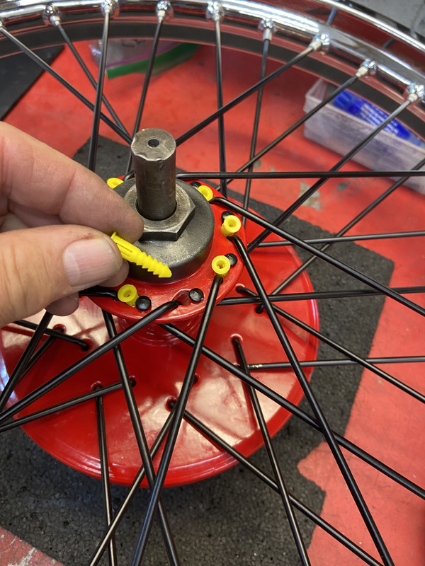

shorter spokes (two different lengths) on the brake hub side
and all equal length spokes on the other side, I used plastic drywall plugs to temporarly hold the spoke heads in position while I spun on the spoke nipples
I had recorded the offset dimensions way back when I disassembled the wheel and propped up the rim with plastic boxes and steel scrap to match the offset position of the rim to the hub
Once the nipples were equally snugged up the rim was actually close to being true
Minimal up/down and side/side adjustments were required using a dial gauge to get to +/- 10 thou
Another rim off to get a tire mounted on Saturday, I always feel a major milestone in the rebuild has been met when the bike is rolling on its tires

« Reply #172 on: December 06, 2021, 06:06:50 PM »

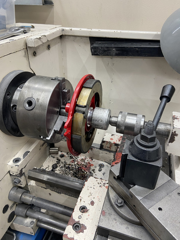

I had a brain fart moment yesterday, I am translating the Airone Owners Manual and going through the original Italian booklet I realized I have the front wheel on backwards, so I pulled the fork tubes out and swapped them around so I can get the front brake plate on the right hand side
While I had the wheel off I felt the brake shoes are jut too tight, I made a mandrel for the lathe and using a sanding belt turned inside out trimmed off a wee bit of the new linings.

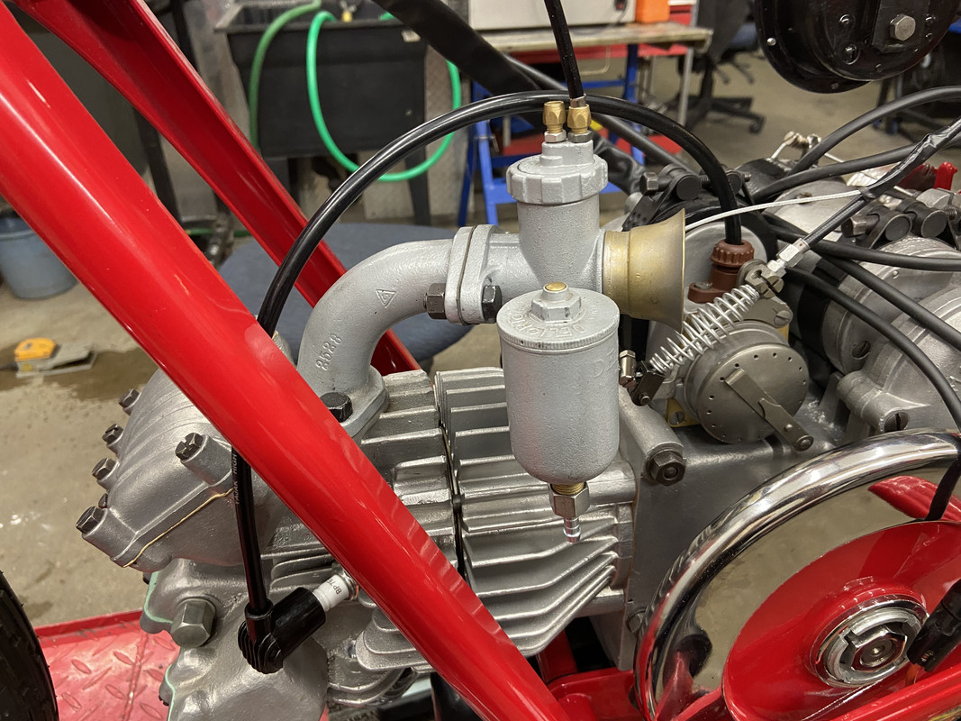

repro battery box and retaining clamps
repro choke and manual advance levers, I had the handlebars and original levers replated, repro white handlebar grips
and a repro header and muffler

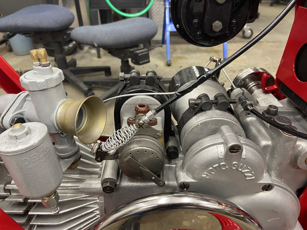

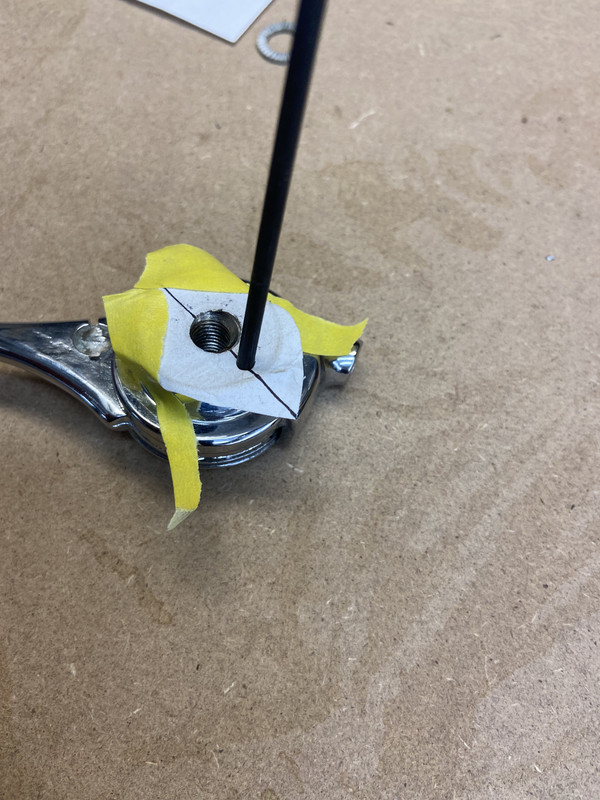

The magneto advance lever and the choke lever are reproductions and they come with an alignment pin in addition to the mounting bolt that passes through the handlebar welded on lever perches. The original levers did not have alignment pin and when pulling the levers the base can rotate. So I have to drill 3mm holes in the handlebar perches in the correct location to secure the lever assemblies.
To get the new holes in the right location I made a paper pattern of the underside of the new lever assemblies, punched out the large mounting hole and the 3mm pin hole, then taped the paper to the underside of the lever assembly
Then I mounted the lever assembly, aligned it to where I think it should face and then lifted the tape of the lever body and taped the paper to the handlebars
Then unbolt the lever body leaving the paper pattern on the perch, punch a drill center for the new 3mm hole
The pins were too tall, I ground off about 8mm and the pin sits just above the perch by 3mm
Now place the lever body over the pin and boly it secure from underneath, a lot of messing about to drill two 3mm holes!
The disappointing part is the solder cylinder ends for the clutch and brake levers are really to small, I will probably replace them. The ends for the choke and advance levers are not correct, I can file them to sort of work but again not the best, and the cables are of a larger diameter so they realy don't slide into the lever body cut outs or through the lever openings without file work.
I did get the advance cable and clutch cable to work, the front brake cable solder end twists in the lever when I pull the brake so it has to be redone. The advance and clutch ends use the screw on barrell ends typical of bikes of this era, I had a couple different sizes in my parts box so at least I got two cables done.
The throttle and choke cables do not have ends on them for the lever and throttle, I think I will need to get custom cables made for these.

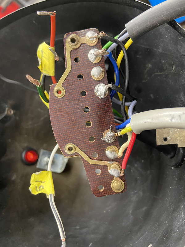

Been working on the electrical for a couple days, some things from 1948 are brilliant, I wish they still fitted spark plug caps of this quality today, the cap has a removable bayonet type threaded spike that pierces the high tension lead when screwed in tight, on the other end a brass disc is soldered to the bare tension lead, when screwed into the magneto the disc make solid contact with a brass mate
all solderd up and fitted
Reconnecting all the wires to the amin light swithc (Aprilia) in the headlicght bucket I get intermittent shorts and illumination
replaced all the wires, even the light switch to terminal block searching for a short,
eventually found it in the worn switch, try as I might to fix it the old switch mechanism is badly worn and the 'key' which is turned 45 degrees L or R from center for park and running lights does not positivley lock and I get a short, nothing or a flicker. Some of the terminal wires have been repalced before and the sequence does not match  the wiring diagram in the manual, looks like previous owner had issues with the lighting and tried a bodge to get the ligths to stay on
looks like previous owner had taken the switch apart in the past and the tabs that secure parts of it are bent and causing the issues, I may be able to fix it a bit, the switch on the handlebar is a std. CEV that os for high / low and horn.
I hate electrical, sorting out old bodges is not fun

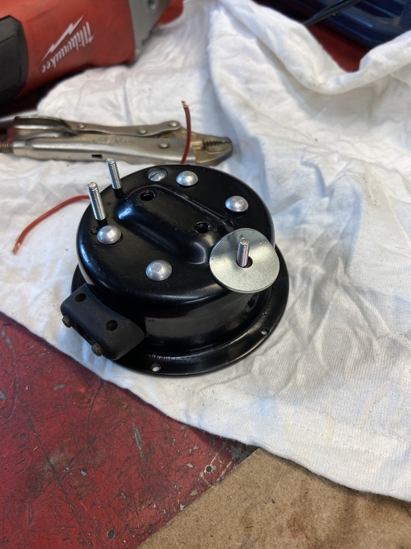

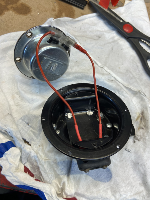

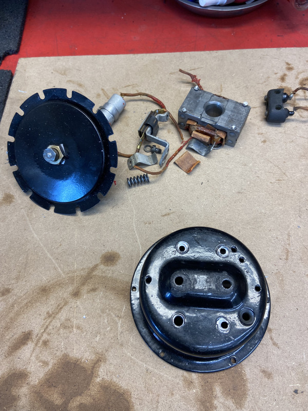

I had previously opened up the original horn, cleaned and tested it and gave it a coat of paint. On the bike and with the switch hooked up it worked (poorly) for a few minutes until the 'smoke came out'. I opened up the horn and it looks like the solenoid windings had shorted out, damn!
I removed the guts, drilled out the magnet riverts (4) and had a bare shell
and then remembered I had bought a couple 6V horns off Ebay (India) advertized as being a Vespa replacement, they cost about $15 a pop. The horn looks like it would drop right into the Magneti Marelli horn shell, and like it as meant to be the new 6V horn fits perfectly.
I cleaned off the paint from the original shell parts and made a new bracket to hold the horn insert from 16 gauge stainless sheet, some folds in the bench vise and drilled some holes
Then I powder coated semi gloss black the original shell parts and the new bracket, I used new aluminum dome head rivets to mount the new bracket to the shell using the original horn magnet mount points
I wound in some metric machine screws to fill the holes in the back of the case where original screw mounts were fitted then cut off the ends of the protruding studs
The original exterior bakelite wire terminal was reused, I connected wires from the horn insert to the bakelite base inside the horn
Two self taping screws retain the horn insert to the new bracket, then the origianl outer louvered cap was bolted back on

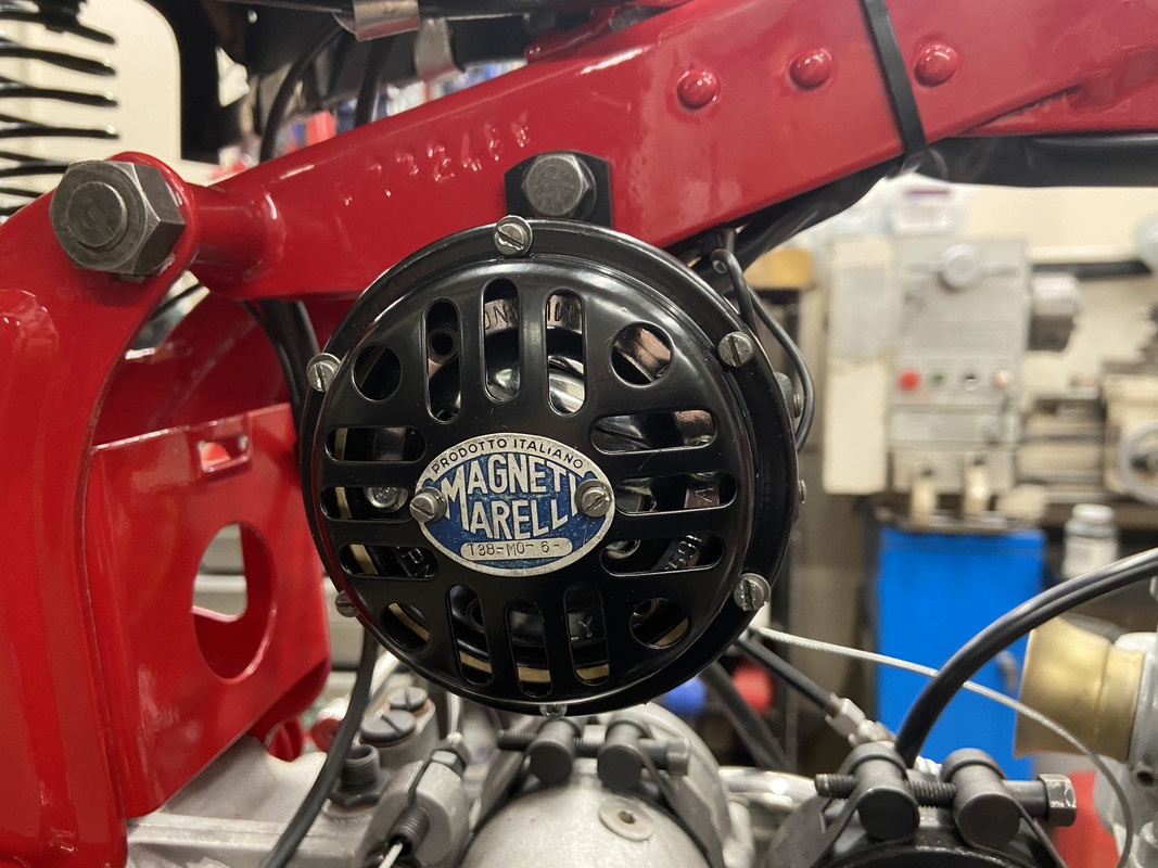

and from the back side it looks pretty much like a new stock Magneti Marelli horn
It took an afternoon but for under $20 I have a fully functioning 6V horn with a nice annoying sound and it looks stock, pretty happy with how this turned out
