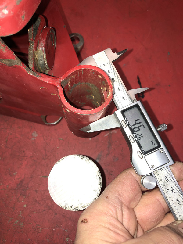

Re: 1949 Airone - restoration
« Reply #63 on: December 15, 2020, 03:45:26 PM »

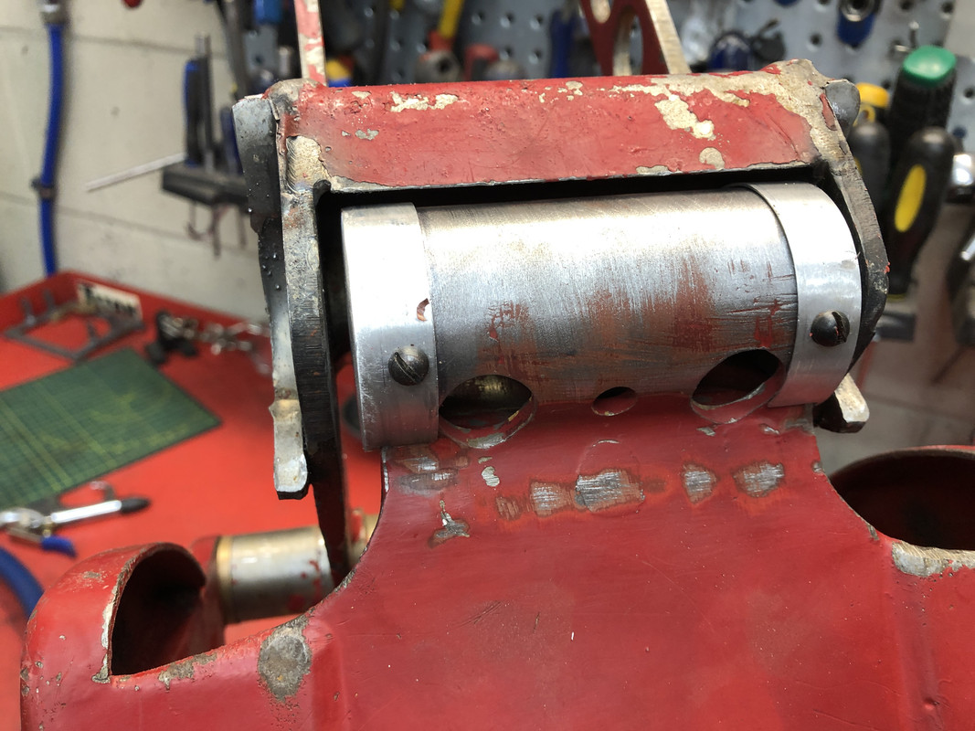

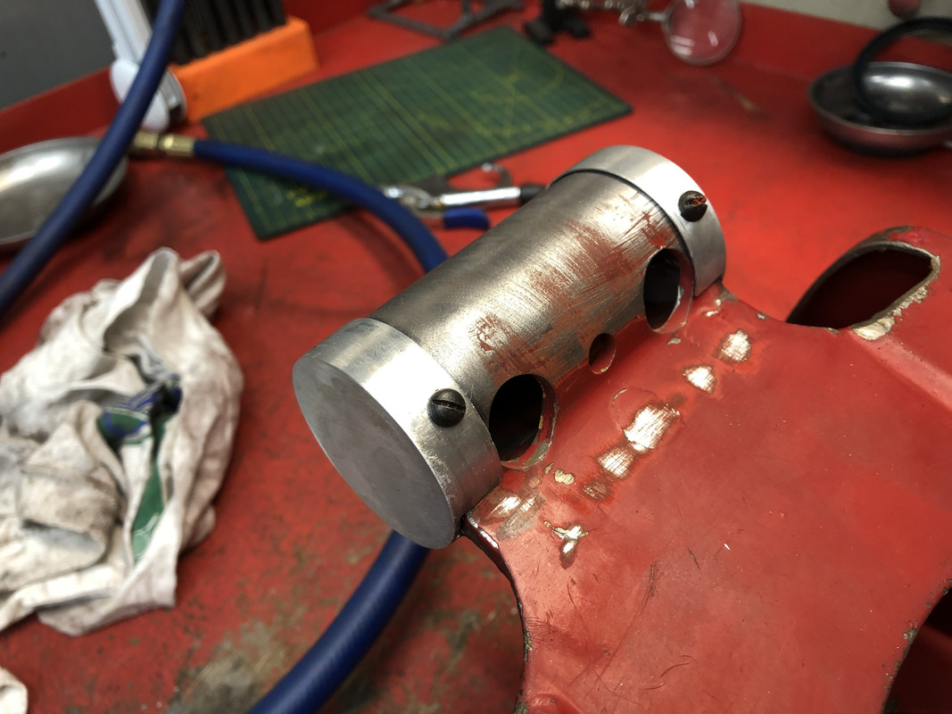

The swing arm lower joint that contains the link to the spring box has a pair of sheet metal caps on each side, one of mine had a hole rusted through and attempts to weld it up with brass rod just resulted in what was left of the sheet metal disintegrating. I don't think these pieces are reproduced, at least I have not found a source so I turned up a pair from 2" diameter aluminum rod. A couple of measurements,
a big pile of swarf
and two suitable facsimiles of the original sheet metal caps
This is the extent of my capabilities on a lathe, I can make round things a smaller diameter, cut off round things, but after that I am steering blind, if there was a community college course on running a manual lathe I would sign up tomorrow.
but they will do the job, plenty of clearance to moving parts, the aluminum was cut down to appx. .7mm wall thickness, once painted black most people will never know they are not stock

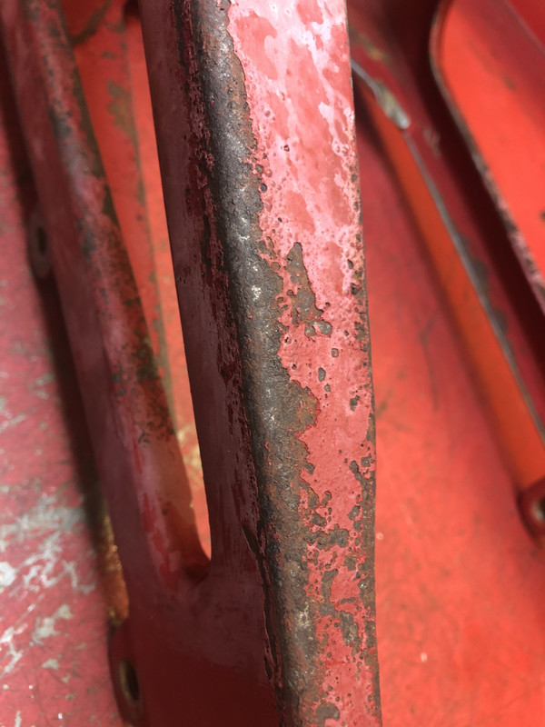

Spent a couple hours this morning sanding the rust pitting out of the pressed steel swing arm
Under the red paint and rust, er…  'patina' was a layer of grey filler primer, it was really well bonded and very thick (The Moto Guzzi service manual refers to the finish as nitro-cellulose oven baked to 90 ~ 100C for three hours), once stripped off, the side faces of the pressing were full of shallow crease marks formed by the press. I don't want to use a filler so again I went at the steel with a random orbital sander. This is a nice heavy pressing and relatively mild steel which responds well to flat sanding. I ended up using 15 sheets of 80 grit and 13 of 240 grit to get the exposed faces smooth.
A couple hours later and it was done. Before it goes off to the powder coater it will be gone over with a fine sandblast to get all the paint off the nooks and out of the crannies.
Reminds me of being a kid and being put to work in the shop by my autobody mechanic father, sanding and sanding his cars for paint, I think I prepped at least twenty cars, that taught me patience and pride in working with ones hands.
On to the front frame section and front forks next.

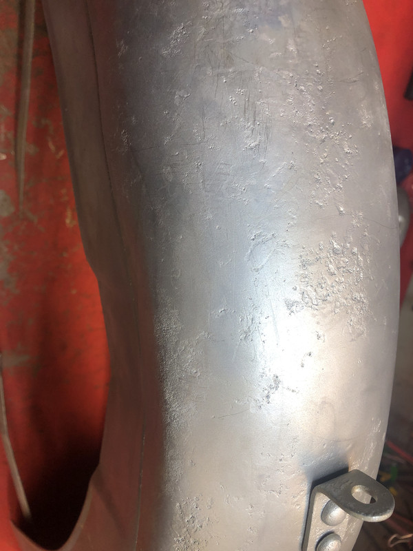

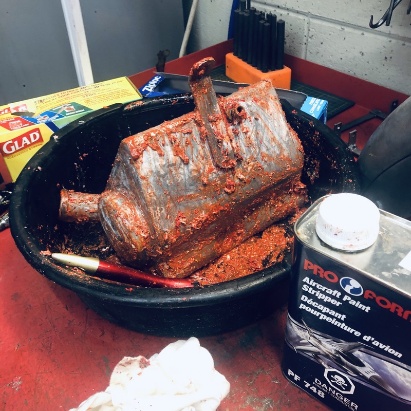

I have stripped the paint and prepared all the frame components, down to the fenders, tool boxes and oil tank.
The fenders have suffered from a lot of surface rust,
What lies beneath (sounds like a horror movie title), after a coat of spray on aircraft paint stripper and a hand scraper to remove the thick paint layers
After a sand blast there are plenty of deep rust pits under that mess to fill and paint
I bought a Beugler Pinstripe roller to try my hand at painted pin stripes on the fenders, tank, tool boxes and oil tank, plenty of videos on You Tube demonstrating the kit

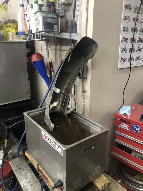

I stripped the last of the painted parts today, tool boxes and oil tank, I used an automotive paint stripper, they sure don't make a good paint stripper like they used to, progress huh? After stripping in to the sand blast cabinet for a couple minutes to get any revenant of paint and loose rust off.
The fenders and tool boxes are made from several pieces of formed sheet metal and rust collects in the folded metal seams and between the inside of the fenders and the fender support brackets. 'Evaporust' in the ultrasonic tank heated to 45C does wonders in getting the hidden rust to flow out of the ends of the seams and from under the riveted brackets. You can see the particles of rust slowly flowing out of their hiding places and collecting in a puddle of sludge in low spots. It takes about an hour to clean a section then shift the fender a bit more to immerse it and continue.
After the Evaporust has done its thing the bare pock marked metal is exposed, ready for refinishing.
Glad to have this messy and time consuming part of the project behind me!
Offline SED
  • Posts: 1629
« Reply #78 on: December 27, 2020, 11:30:49 AM »
Wow, that sonicator really does the job!  Who makes yours and what size is it?  I've always used phosphoric acid, but might have to try evaporust.
From the looks of it Canadian paint stripper still works.  Methylene chloride (carcinogenic neurotoxin responsible for work related fatalities) has been removed from US paint strippers and all they do now is soften the surface.  The absolute failure of the stripper is why I made the hot tank and it is much cleaner and easier.
BTW - pressure check your oil tank for leaks.  If it is like the GTV tank, some of it is soldered and the solder joints may fail.  Even my new oil tank had a weep where the oil supply fitting was soldered in.
« Reply #79 on: December 27, 2020, 11:45:59 AM »
I bought this tank off EBay, shipped out of Richmond BC, suburb of Vancouver, it cost about $500 CDN and it’s 30 litre capacity. It has a 90 minute max timer and a separate heat control that heats to 50C. I can’t get phosphoric acid here anymore, it was such a great rust remover. Evaporust works well but it’s slow, the ultrasonic tank with the heat turned up significantly speeds up the rust removal. I thought 30 litres would be large enough for anything I needed but once I see what it can do it could always be larger!
One or two Dishwasher soap packets dropped into the ultrasonic cleaner work great for grease removal and the grease mops up off the top of the tank solution with a piece of paper towel.
I noticed the solder joints on the oil tank, good advice to pressure test it, will do that before I get it painted.

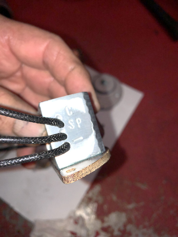

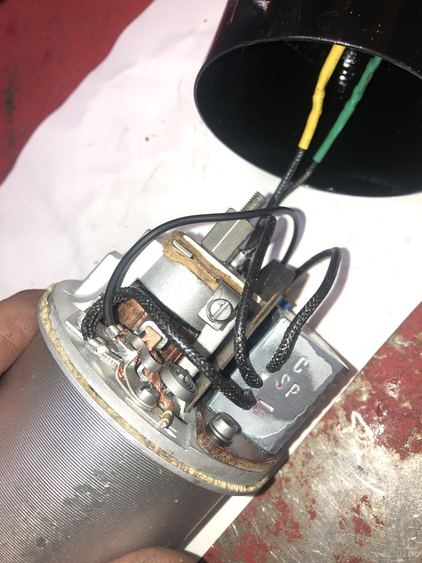

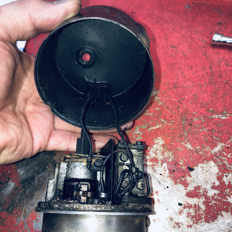

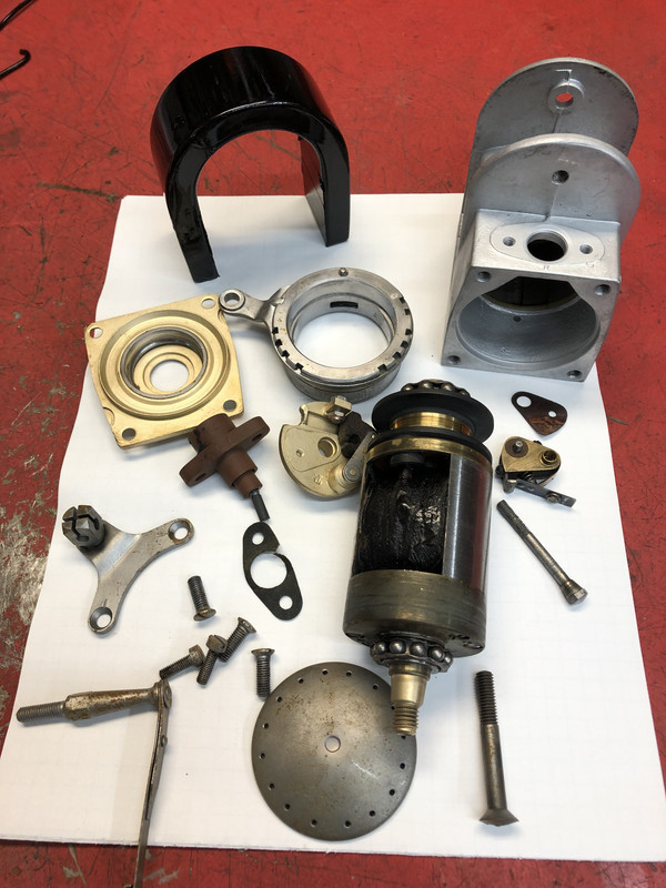

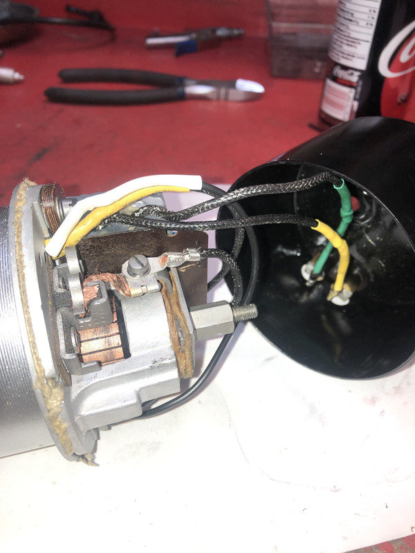

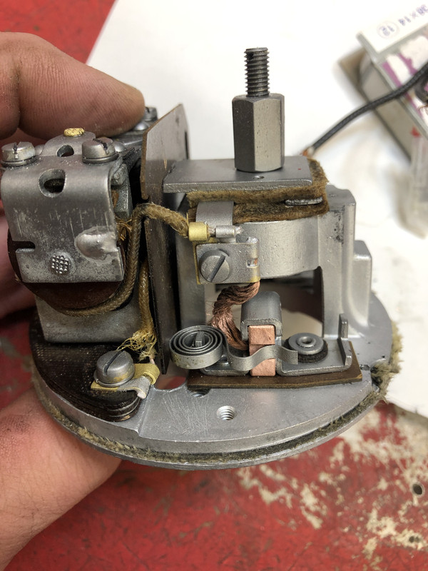

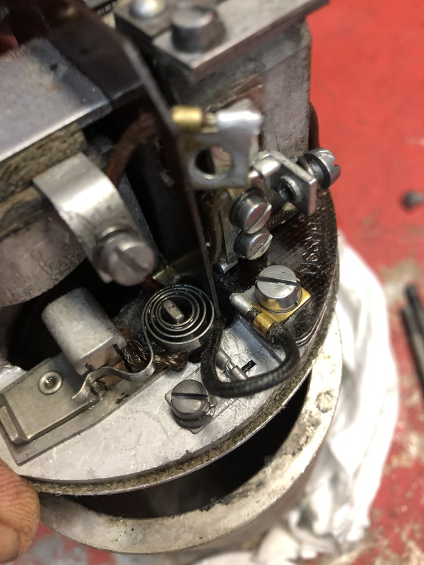

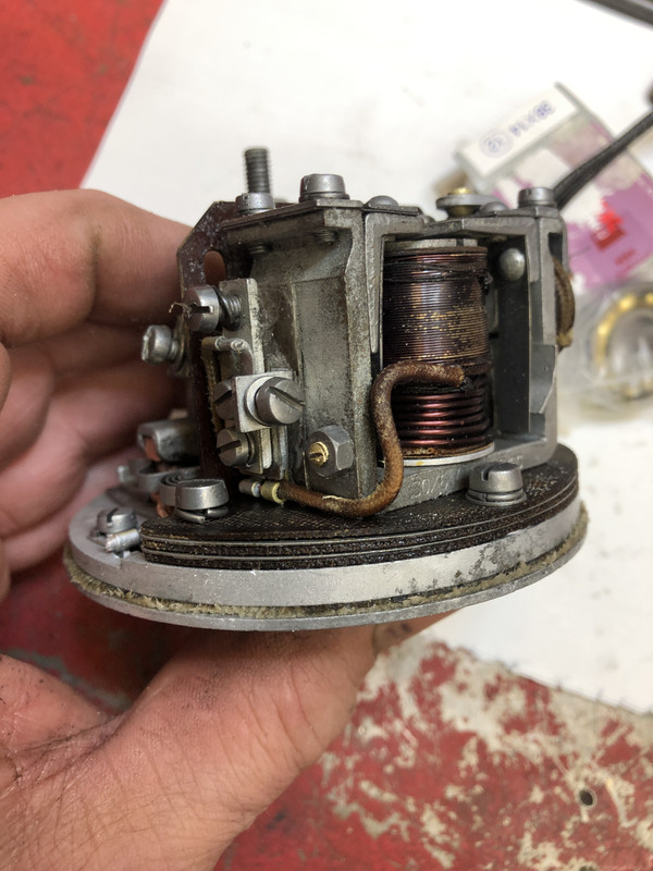

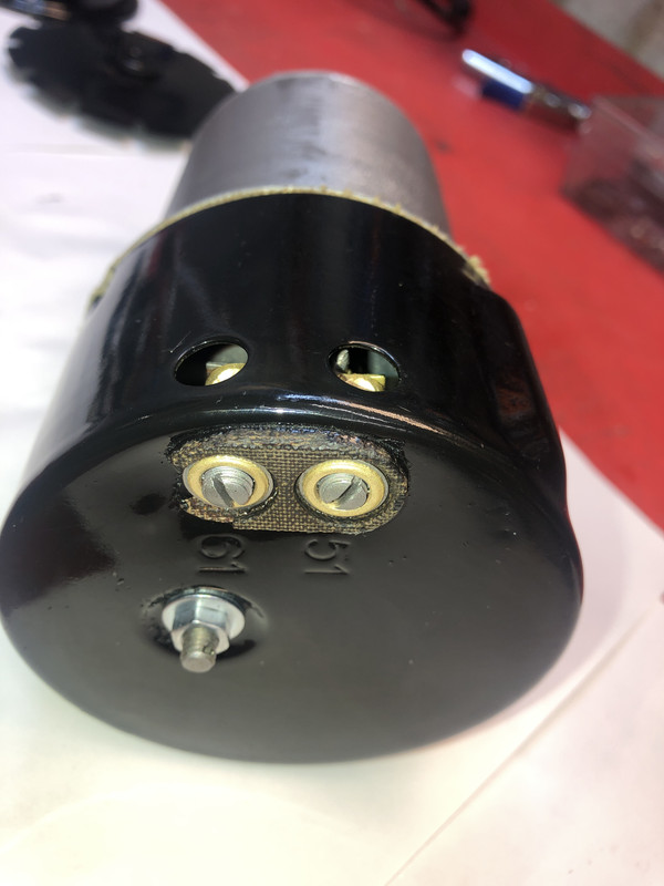

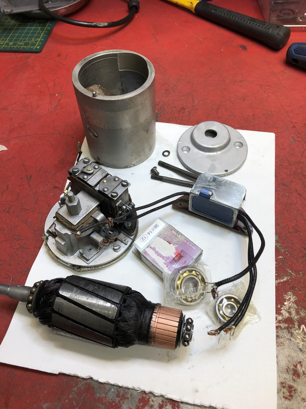

When I first got my 1949 Airone I asked Valenti to send me the engine parts I should replace as a rule, he sent me engine case bearings, seals and gaskets, Magneto coil, points and bearings and Dynamo bearings and solid state reg/rec.
Stripped and cleaned, gave the magnet a fresh coat of paint. While holding the armature and rotating the output shaft it gave me a real good jolt, the bike ran before I stripped it down so I think these replacements may not have been required right away but may as well overhaul it.
will replace the bearings and coil
stripped the dynamo, will replace the bearings
There were on wiring instructions for the solid state reg/rec. five wires, 51, 61, C, SP and negative
51 and 61 go to the terminals on the cap, C, SP and negative are uncertain, Am I correct to assume that C and SP are the two wires from the filed coil that is anchored to the zinc plated tube body? and if so which is C and which is SP?
Negative I am guessing is the ground lug on the body of the brush plate = reg/rec plate.
can anyone confirm how to connect this solid state reg/rec unit?
Offline SED
  • Posts: 1629
« Reply #83 on: December 28, 2020, 09:08:26 PM »
Wow - your cleaning process works great!
SP goes to the armature, it is not a field wire.
Campo = field.  One of the field wires (C-) is grounded to the dynamo body next to the grounded brush.  The other field wire goes to the regulator, this is C+.  Connect it to C+ (C) on the solid state reg.  I've seen a reference that the field wires are black and dark brown to indicate positive and negative (don't know which but could maybe find the reference for you), but an electrical engineer said polarity shouldn't matter and it's worked on the 2 I've done.
SP - spazzola = brush. The SP wire attaches to the insulated brush.  Check to make sure the U-shaped bridge that crosses over the bearing housing (insulated brush and SP wires screw to it) is not grounded - it's just trapped under the cover screw.
For the picture below:  Red circle is positive field, connect C to it.  Black circle is negative field.   Black arrow is grounded brush.  Red arrow is insulated U-shaped bridge.  If insulated brush is connected to other side, then SP can be connected here.
The field, armature and reg all share a ground through the body of the dynamo.  Make sure you have good battery connections - if you lose the ground the dynamo over charges blows the bulbs and cooks the solid state reg and it smells like burnt fish for a week!   :shocked:
« Reply #84 on: December 28, 2020, 09:31:09 PM »
Thanks so much Shawn! Great explanation and very helpful!

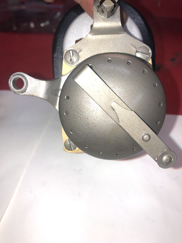

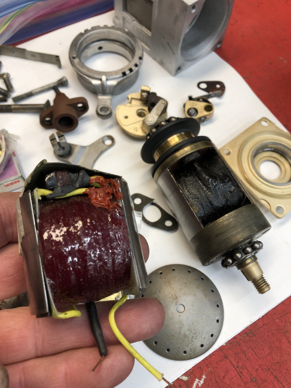

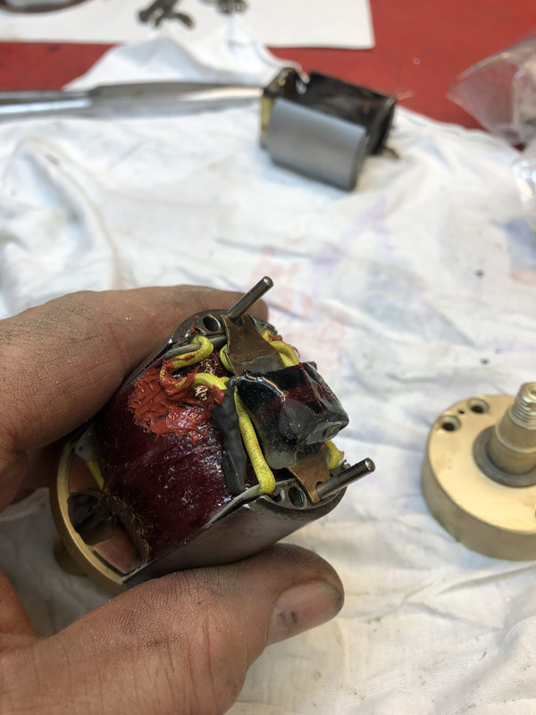

I put the whole dynamo in the ultrasonic cleaner in Evaporust for 30 minutes to free the rusted case bolts, Vapor blaster cleaned up the rest in a couple minutes. Any tips for pulling those tiny bearings off the dynamo and magneto? I don’t think I have a bearing puller that small, maybe I can make up a tiny puller.
Valenti sent me the new rotating coil for the magneto, is there a condenser hiding inside there?
Thanks again!
Jim
Offline SED
  • Posts: 1629
« Reply #85 on: December 28, 2020, 09:33:48 PM »
Your mag parts look beautiful!  Make sure you replace the capacitor.  Keep track of the polarity of the wires and housing as you take it apart.
This is a late BL with a canned capacitor (earlier versions were just a stack of conductors and insulators in the same housing).  Note that one end is insulated and the other not.  The close distance between the insulated terminals and the brass end cap is the safety gap.  You want to maintain that gap - too little and it will limit the high voltage output, too much and it can overload your windings if the plug lead is not grounded.  If you have the older style I can post pictures on how to maintain the safety gap.
Here are the replacement caps soldered together and encapsulated in epoxy.  I didn't set the epoxy into the endcap because they may need to be removed in the future.  Once the epoxy puck was made I glued that in with some rtv so it wouldn't wiggle and work the capacitor leads.
Here is the link and info on the recommended capacitors:
http://www.britbike.com/forums/ubbthreads.php/topics/455839/3
Recommendation for a Replacement Capacitor
Since not everyone may want to read the details of the tests described below, I'll go straight to the conclusion. The capacitors I recommend as replacements for use in Lucas, BTH, and other rotating armature magnetos are a pair Vishay 0.082 uF "AC and Pulse Double Metallized Polypropylene Film Capacitors," manufacturer's number BFC238320823. These capacitors have pulsed current and voltage ratings of 1400 V/us and 630 VDC with a maximum operating temperature of 105 oC. These specifications comfortably exceed those needed to survive for years in the hostile electrical environment of a magneto. They are available from Digi-Key for $1.35 each ($2.70 for the pair required to be soldered in parallel) under part number BC1883-ND.

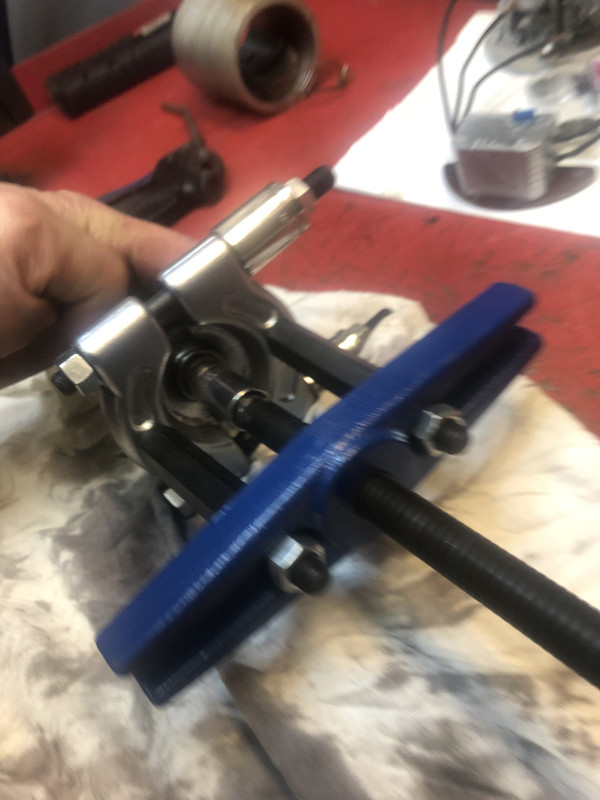

I used my smallest puller to pull inner race off the shaft.  Had to modify the pusher.  Outer races I may have had to use an inside puller from harbor freight - about $60 USD.  Don't remember for sure.  Keep track of the packing behind the race for end play.
« Reply #88 on: December 29, 2020, 05:51:54 PM »
Looks like the new armature Valent sent is complete with the condensers, just had to swap the alignment pins over from the old unit
I did manage to get my smallest bearing puller on to the old bearings to pull them off the magneto and dynamo
The blind bearing races came out of the castings after bringing them up to 300F in the oven then a quick rap on the bench and out they fell with the packings
Cleaned out the bearing recess, reheated the castings and put the races in the fridge, then they along with the cleaned packing the races fell into place
After reassembling the magneto there was too much slop in the armature, pulled it apart and added a thicker shim, much better
the steel parts, screws, points cap and points sprung retainer were blasted, polished and coated with satin powder
The satin powder looks more like aged steel because I heat the oven a bit warmer than normal, up to 400F and cure the powder for an extra 5 minutes, I like the aged look of the clear steel as opposed to a normal clear finish
Dynamo came together easy enough after Shawn explained the wiring, I just opted to spray paint the body silver rather than send it out for zinc plating, clear powder coated the fasteners, bearings went in as per the magneto
Dynamo is done, hope it all works

 BTW, how are you addressing the pitting? I ask because i have a set of Ambo Headlight ears that I cleaned with Evaporust, and they look similar to that fender.
