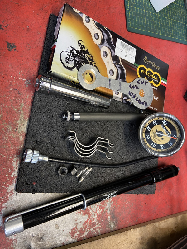

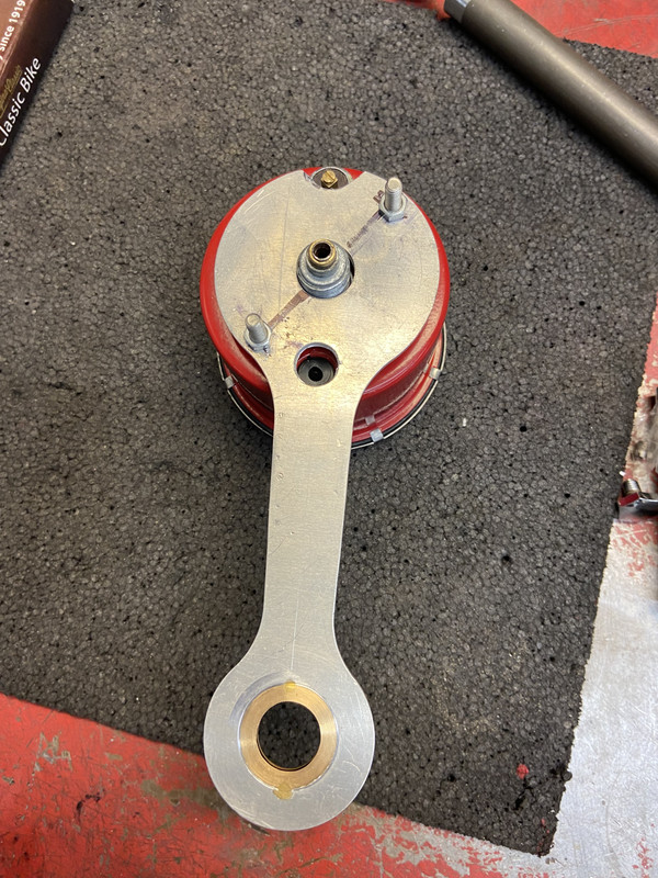

A parts order arrived from 'Retro" in Italy, hopefully the last parts order for the Airone.
A reproduction tire pump, final drive chain, a reproduction speedometer, speedo mount and telescopic cable kit, a couple nuts and bulbs

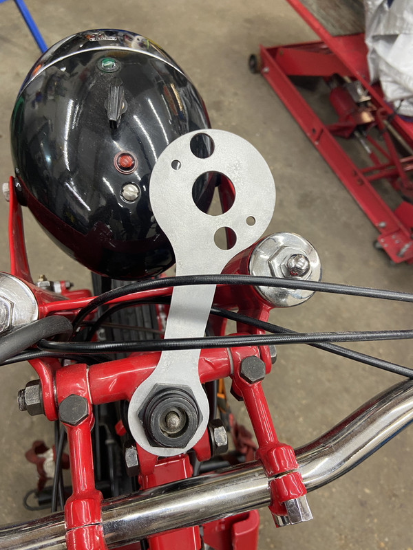

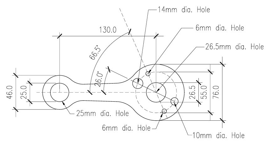

The mount needs to be drilled for the speedo lugs, bulb and the hole for the steering stem needed to be enlarged from 18mm to 25mm
I should have thought this through more, aligning the gauge on the center line of the frame results in a major kink on the speedo cable
I will rotate the mount to the right but will need to redrill the gauge stud holes to keep the instrument face horizontal
That will leave extra holes in the mount, I think I will turn an aluminum cup to cover the extra holes and give the underside of the mount some thickness
The telescopic speedo drive kit needs to have the mount brackets chrome platted and the telescopic cylinder body painted

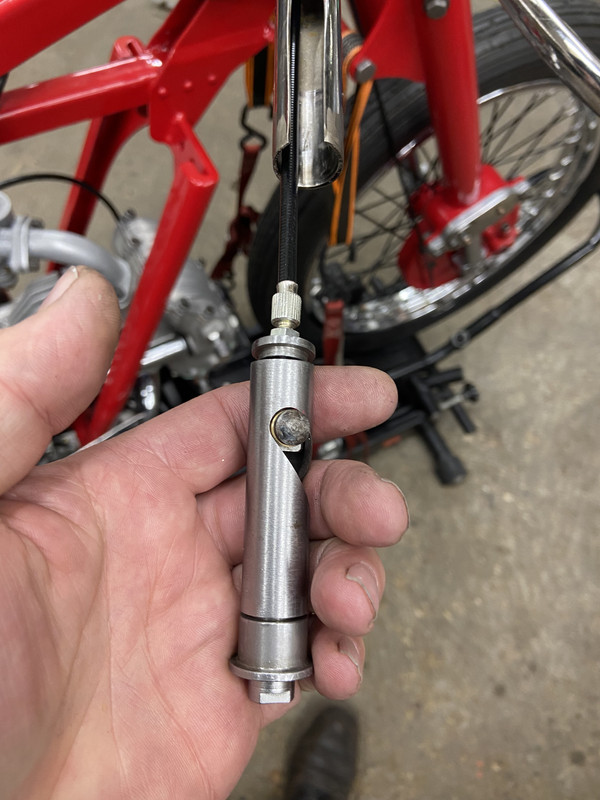

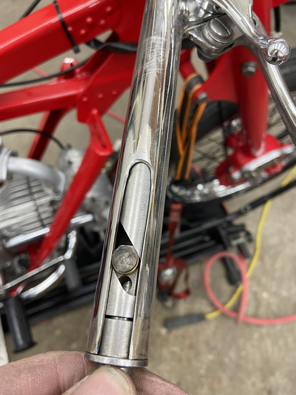

The throttle slide kit has a guide pin larger than the handlebar slot,
some grinding and file work of the handlebar required
now to make up a throttle cable and fit the rubber handle cover

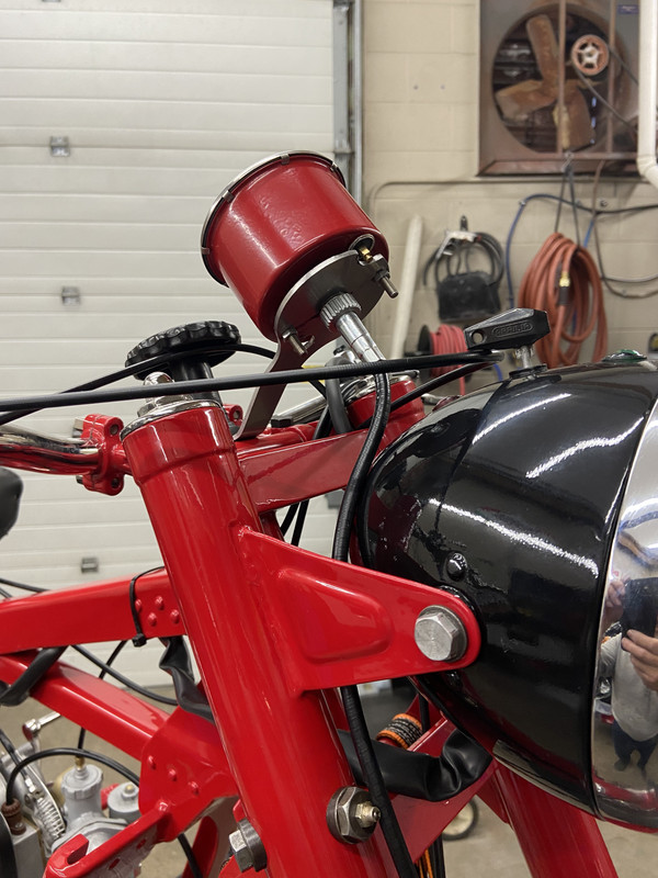

I rotated the speedometer bracket to align the speedometer cable vertical clear of the headlight, this requires re-drilling the bracket Retro sent me, too many holes now so I drafted up a new bracket with the holes where I want them and sent the pdf and Autocad file to a water blast cutter shop to cut out a couple copies for me in 3mm steel plate rather than the alluminum the original was cut from.
Once I bend the bracket to get the offsets I will probably weld up some stiffner gussets on the underside and see if I can figure out how to attach another anchor strap to meet an existing fastener on the fork assembly

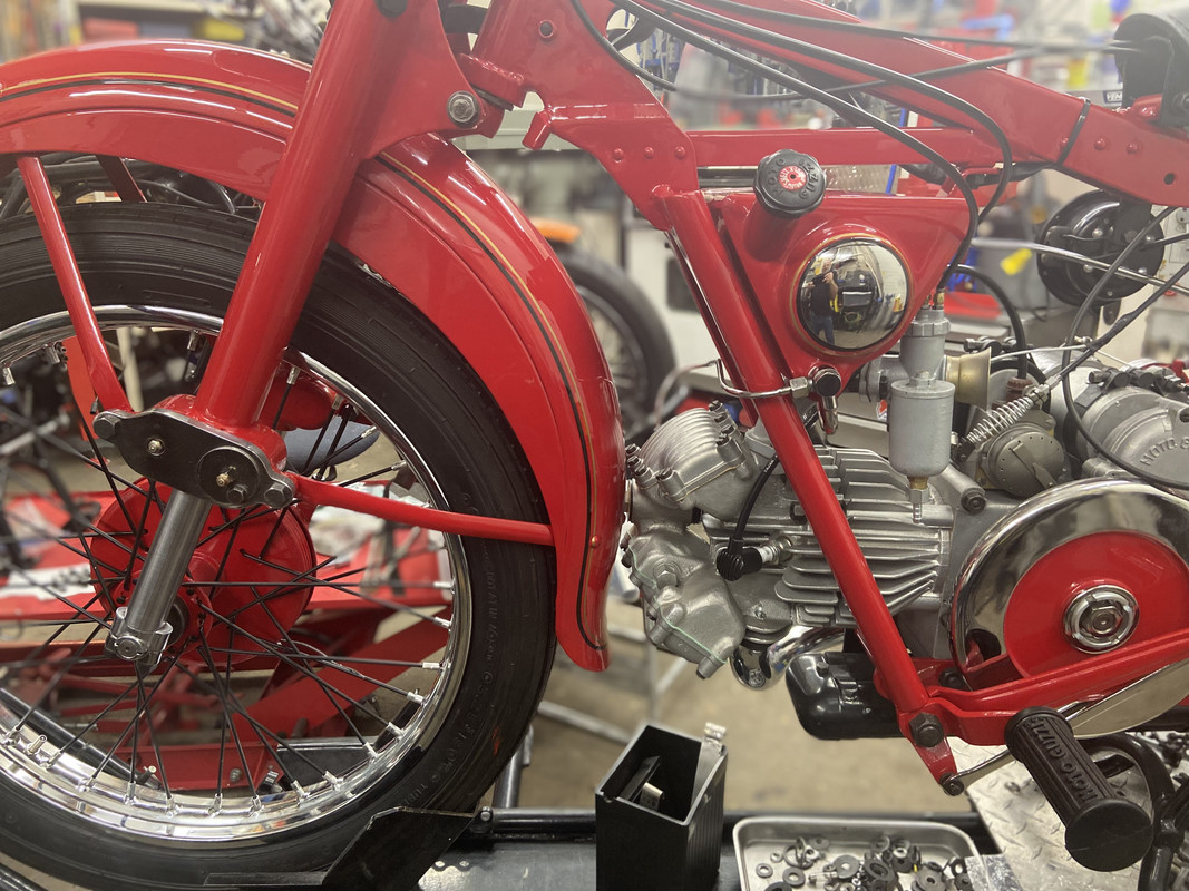

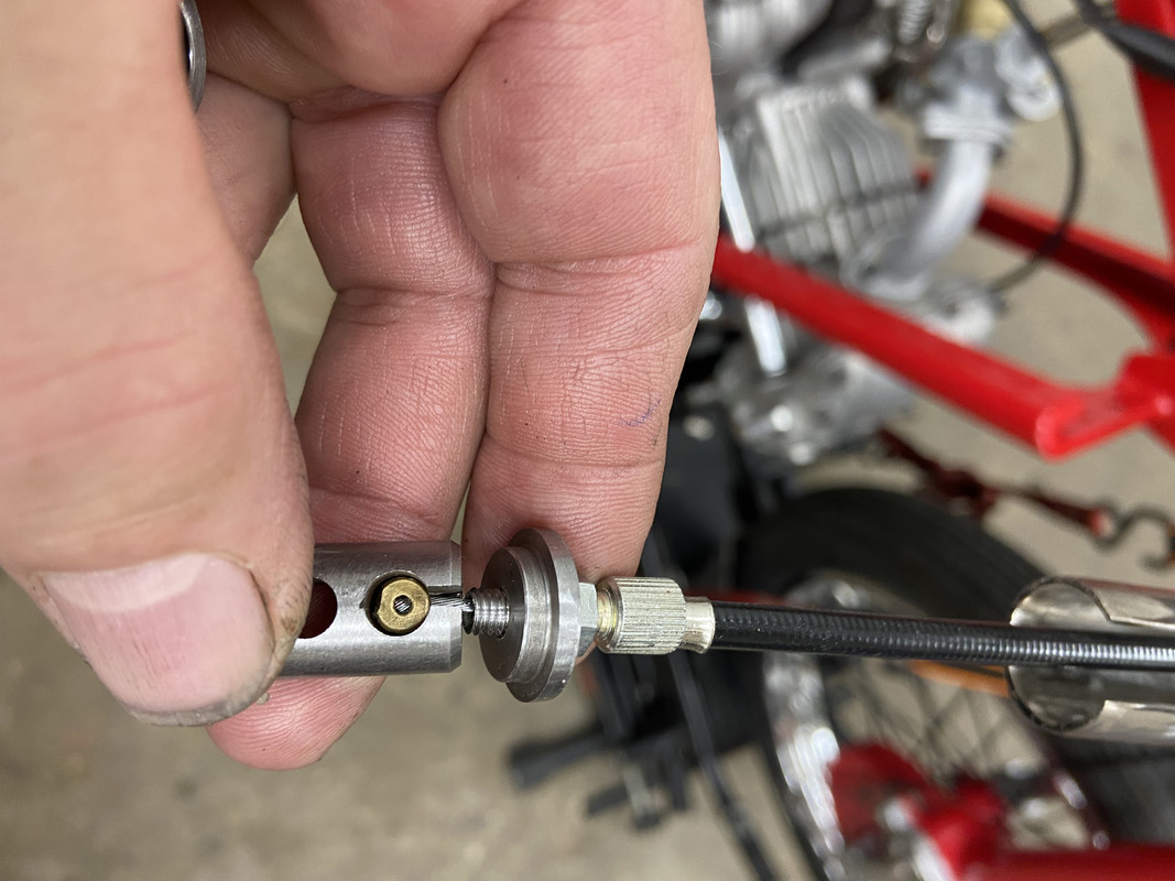

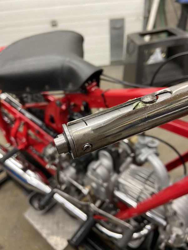

Finished the throttle control today, the outer shroud length and inner cable length figured out and trimmed, I used a clamp style cylinder end to lock the cable into the handlebar slide
a small set screw locks the fixed end of the throttle to the handlebar, needed to trim 1mm off the end of the handlebar to align the grub screw to the bar opening, then tighten the screw until it almost touches the rotating cylinder, peen the set screw to the handlebar and then file the head of the set screw flush to the handlebar outer face
and the bar end is finished, the outer cover tube includes the rubber grip and is secured to the rotating cylinder with a bolt and an internal compression spring

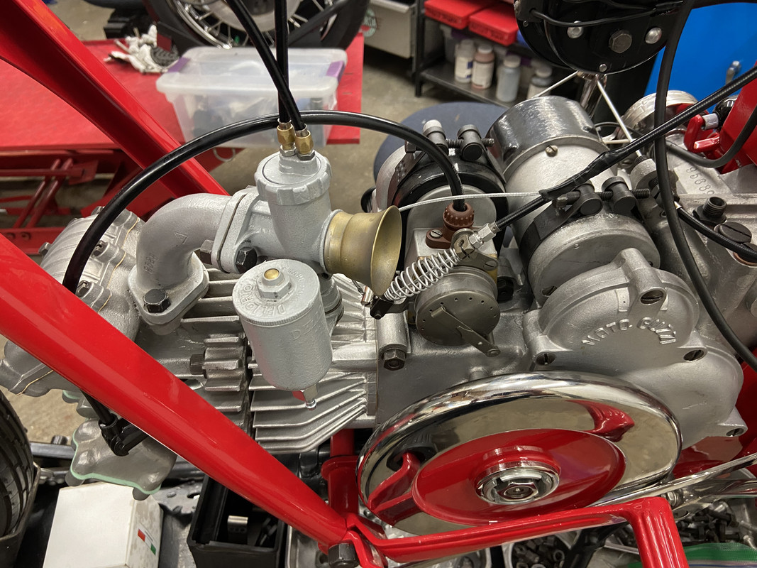

choke and throttle ends secured into carb

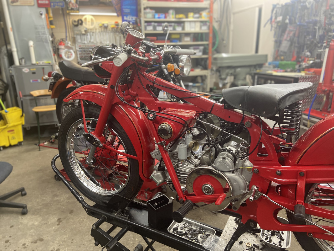

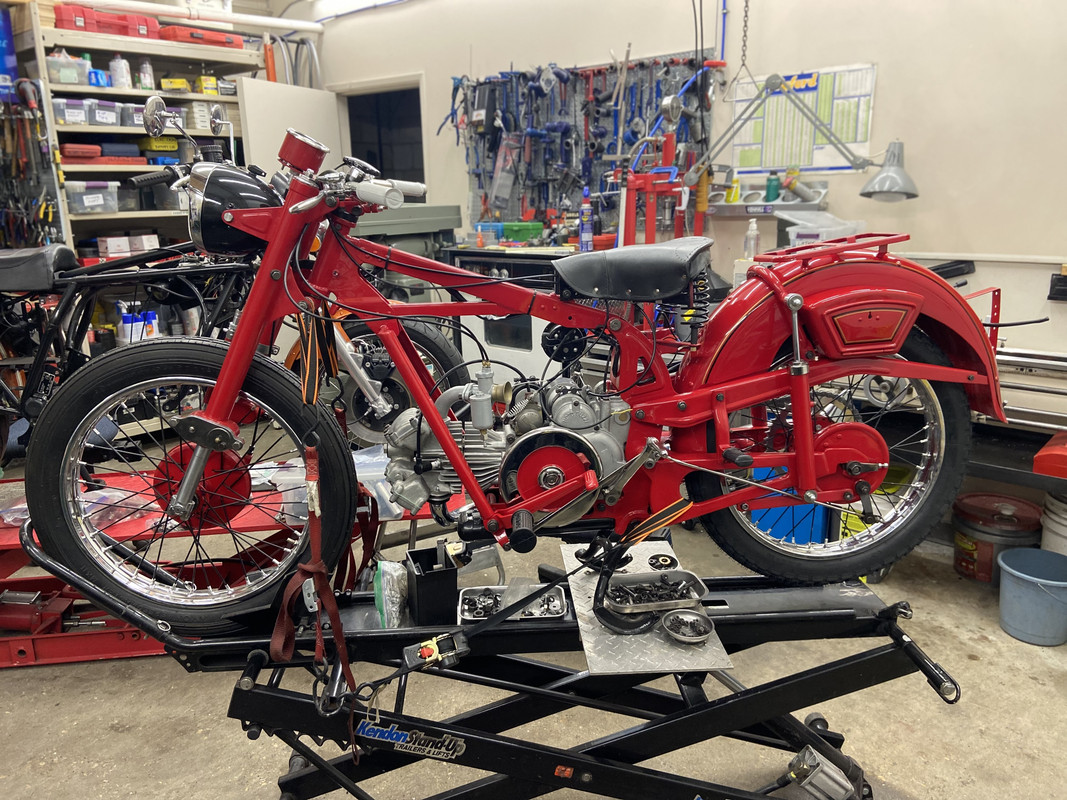

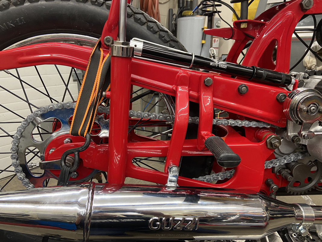

Installed the final drive chain and put the repro tire pump on its frame mounts
Almost ready for the fenders, leg shields, oil and gas tanks and tool boxes, can't rush my painter but I hope he finishes the pieces before spring.

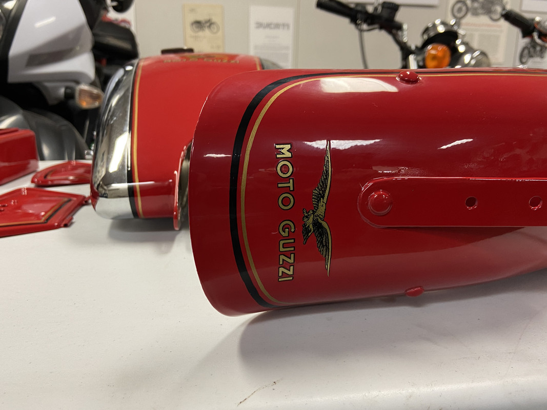

My painter called yesterday to tell me he has the fenders, gas and oil tanks, tool boxes and leg shields ready to pinstripe and the pinstripe artist would be at his shop today to get started. I asked if I could meet the painter and watch some of his work and after given the Ok I drove out to my painters rural shop and watched the magic.
The parts are painted in base coat and will be pin striped and have the decals applied prior to clear coat finish. I took many detailed pictures of the parts prior to refinishing and used a paper tape measure and a caliper to note placement and width of stripes.
The gas tank with the first black stripe done
It was a real treat to watch Dave apply the stripes, he has been doing this for almost 45 years, he has detailed thousands of cars and motorcycles. Dave used a masking tape guide line for the fenders only, by hand/sight for the rest of the pieces.
a leg shield with the gold and black stripes
I should have all the parts completed and back with me in a week or two, I think its going to look very smart.

the throttle is 'interesting' nice clean exterior appearance but overly complicated compared to the typical designs.

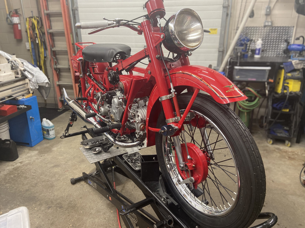

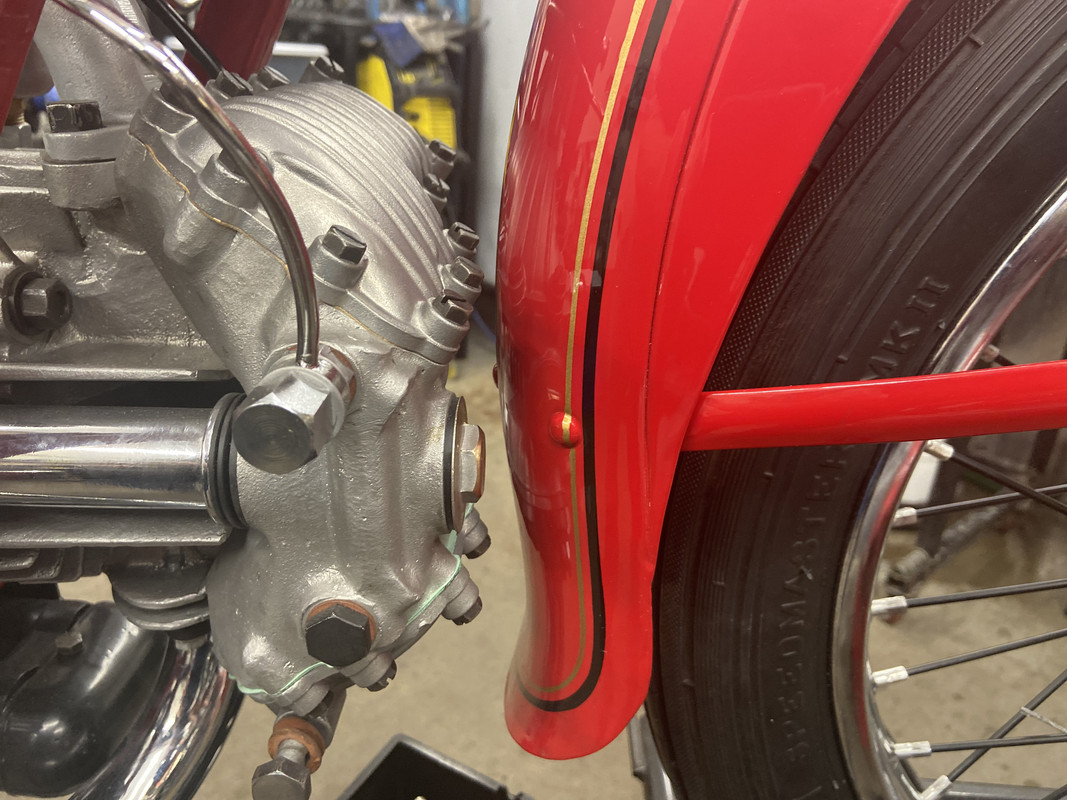

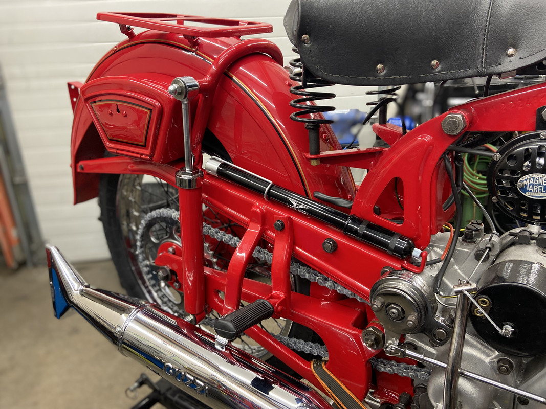

The painter is done with the Airone's painted parts, there was a lot of metal straightening and shrinking on the leg shields and the rear fender required a proffesionals hand to fix my attempts at merging two fenders into one, new metal was pieced into the side skirts, again plenty of shrinking and shaping, the painter I use has 45+ years experience as a red-seal autobody mechanic.
The gas tank is a new chrome reproduction I bought from Valenti a couple years ago, paint is base clear, stipes are hand painted.
[/url
The fenders were in very rough shape, I am very happy with the surface finish, hardly any bondo on these parts
[url=https://postimg.cc/jnwFZtm9]
This is one RED motorcycle
I need to let the clear harden for at least a week, I may just mount the oil tank so I can get the oil lines fitted and work towards getting the engine running.

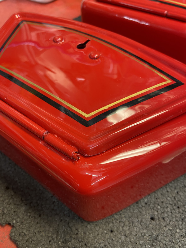

One small job I can do while the clear coat hardens, I made up some pins for the tool box lids, 3mm (1/8") diameter galvanized spokes (Benelli spares) fit great, I left the threaded end intact, cut to length and then using a hacksaw made a slit in the cut off end to fit a small flat blade screwdriver.
Snug fit, turned the pins in, then a dab of touch up paint
The pins are not going anywhere and the lids pivot nicely

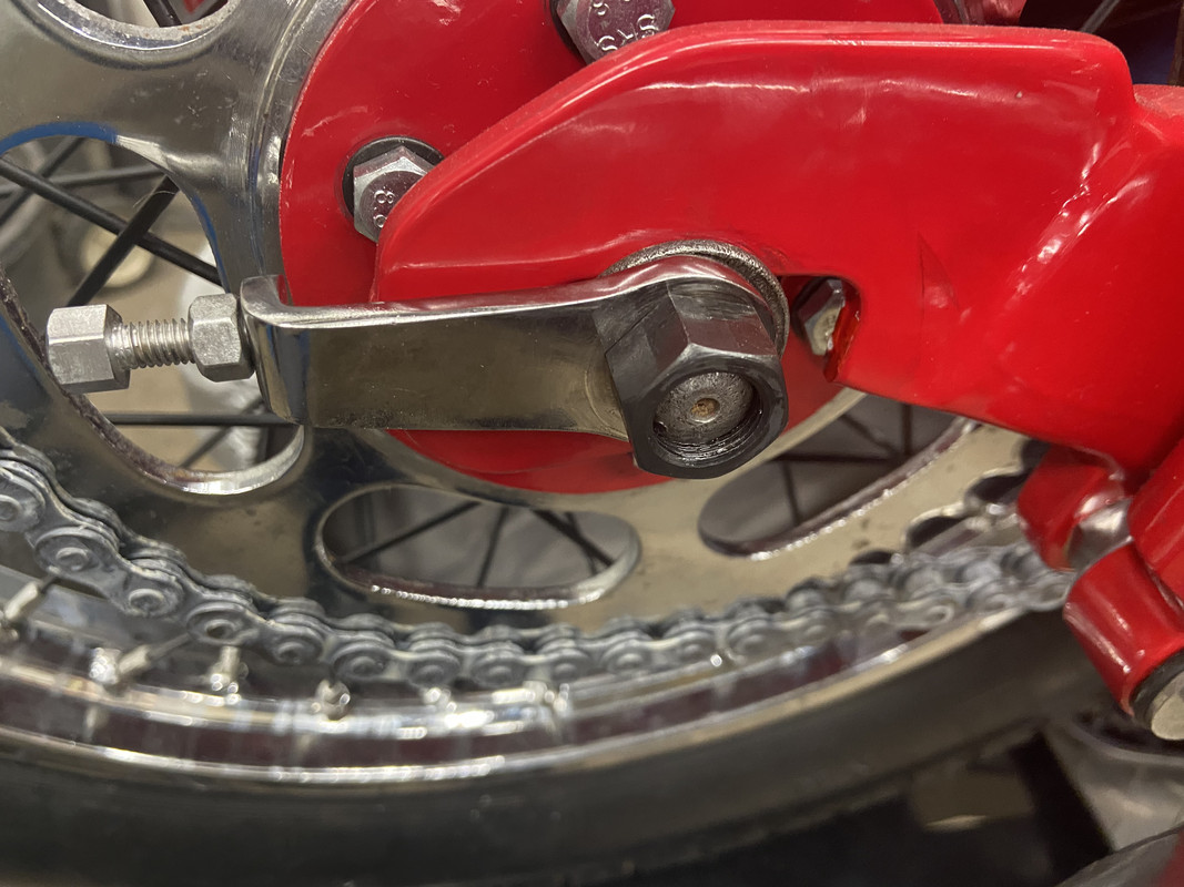

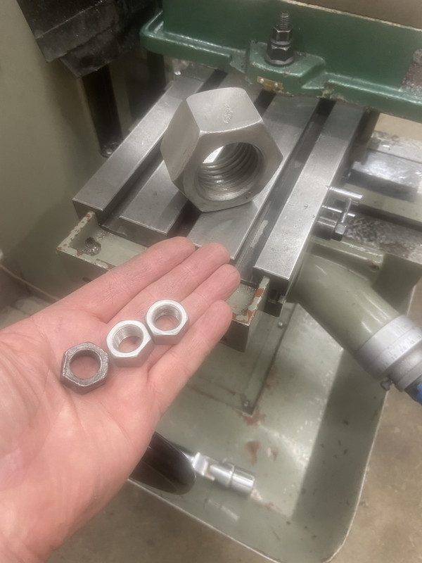

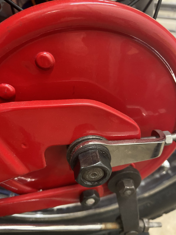

I made up a pair of rear axle nuts on my lathe and mill - M15 x 1.25, unobtanium from any nut and bolt supplier.
Start with 1048 25mm steel rod, drill and tap a section,
test fit the threads to the axle
make the flats on the mill, rotate each side 60 degrees using a big nut as a referance face, clamped the round bar direct to the mill table,
cut the nuts to length on the lathe with a parting tool
Chemical blackened and coated with ACF-50

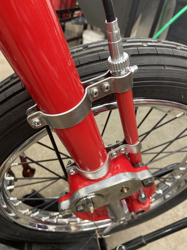

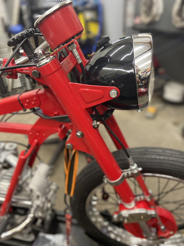

I got the water jet speedometer bracket back and test fitted it, then made a coule bends to raise and tilt the instrument
the speedometer fits so the cable is clear of the headlight

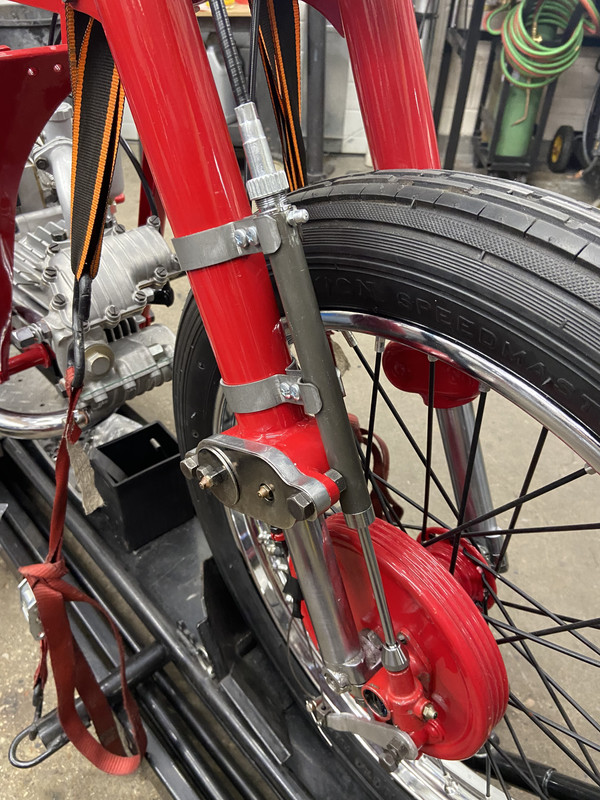

test fitted the reproduction telescopic speedometer lower section, a complicated design when a longer flexible cable would have done the job
The reproduction steel two piece clamps do not fit that well, the telescopic speedo section is too close to the bottom of the fixed fork section, the gap between the fork tube and the speedo shaft should be wider
I think I will try and make up some better fitting clamps out of stainless steel and make some press dies to form them
Now to take it apart and paint the bracket and the bare steel shaft of the telescopic unit
« Last Edit: January 29, 2022, 06:11:06 PM by Canuck750 »

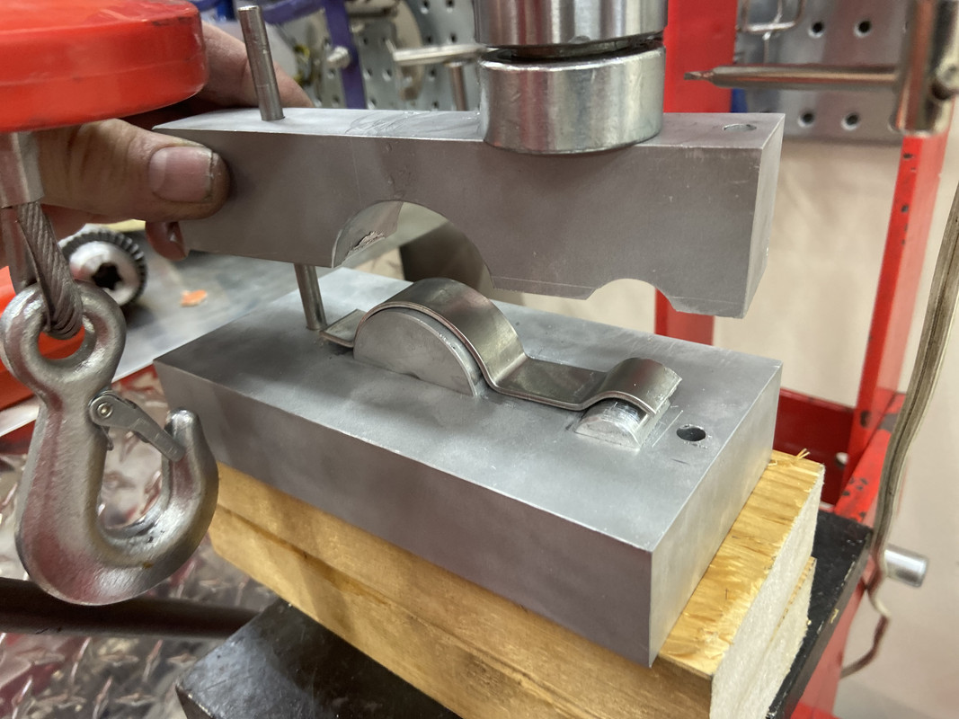

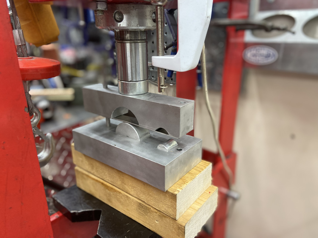

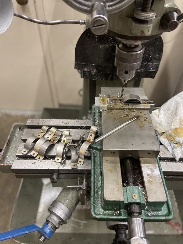

« Reply #203 on: February 01, 2022, 10:21:42 PM »
My first attempt at making a press die to form new straps to suppport the fork mounted speedometer telescopic unit. I made the two part die from 32mm wide aluminum blocks used the lathe and the mill to form the pieces with guide rods to center the pieces. The straps are made from 1.9mm thick stainless steel, 19mm x 125mm, I have a small 8 ton counter top hydraulic press, it worked fine
The new pieces shift the telescopic tube about 2mm further from the fork leg, no longer kinking the shaft
holes drilled for the through bolts, edges rounded off in the bench grinder
One piece needss a pin to keep the telescopic shaft from rotating, I used a press rivet like the ones used to secure the Guzzi Loop Frame steering lock cover
These new pieces fit well and the stainless means I don't have to pay for chrome platting
Painted the speedo bracket and fitted the instrument and flex cable
One more job done

Also appreciate seeing your press form.  I would have guessed the aluminum would distort too easily pressing on stainless but worked great.
Thanks Shawn, the aluminum press form worked great, very little pressure required to bend the 1.9mm stainless, I had the steel supply shop cut me 3/4" x 5" long strips of stainless, that made the job much easier. After forming 12 pieces there was some wear at the sharp corners of the die. I should have radiused the transition from flat to curved.
On a side note I watched several Youtube videos of dies made with 3D printing using a hard plastic. I was surprised to see the plastic two part dies stood up very well, some complex shapes were formed and they looked great.

I started to assemble the rear sheet metal today, I got the rear fender, rear rack and tool boxes installed, as well I put the 'right size' rear tire on a 3.00 x 19 (bike came with a 3.50 x 19), the new tire now has sufficient clearance to the swing arm.
I ran out of original 6mm blots and washers so I used new mid grade 6mm bolts and in the lathe I turned the stampings on the bolt head off then dipped the bolts in muriatic acid to remove the zinc plating (zinc must come off to allow the chemical blackening to take effect), it works in seconds, rinse the bolts off in fresh water then dip the bolts in chemical blackening solution, rinse again and then soak in ACF-50 and towel dry. They come out looking great.

next job was installing the front fender, this should have been straightforward, just the front and rear fender stays and one bolt through a bracket at the top to the forks. I had replaced the fender stays from another fender * originals had been rewelded, poorly), re-attaced with new rivets, the stays appeared to be identical but it turns out they are not, slight difference in length of the rear stay.
this turned out to be a real headache!
I ended up slotting the mount holes on the rear fender stays by at least 12mm and machining back a ridge on the fixed fork bracket to shift the fender forward, otherwise the fender hits the motor :cry:
I filed away slowly for a couple hours until I was abale to get a clearance of about 1/4" between the rear of the fender and the cylinder head,
tight, but it should be ok. I still managed the scrape the fender but it looks like its in the clear coat so I can hopefully polish it out. I also machined off a bit of the rocker arm access plug to gain clearance
one other thing I did today was refinsish most of the nuts and bolts I unscrewed to fit the fender and oil tank, I had refinished them in the past but the surface of the metal was still rough, I turned the bolts head faces in the lathe and hand filed all the bolt and nut flat faces, then soaked them in muriatic acid, chemical blacken and soak in ACF-50, they look 100% better now. I will probably redo a bunch of other nuts and bolts that don't look that great,
