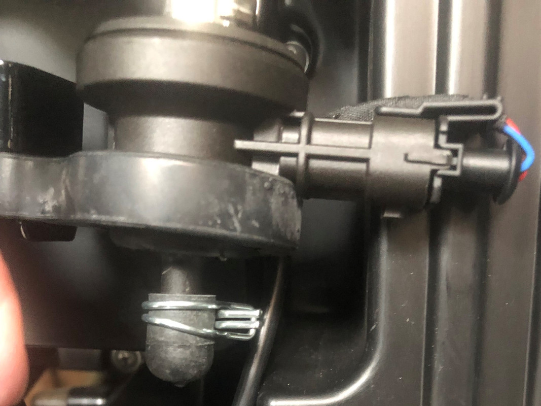

Here's the easy fix for the V7-850 hiccup.  Rather than remove the whole evap system (just lazy I guess) I just removed the lower hose from the Evap control valve and capped it with a rubber cap.  Works like a charm.
Thanks Dave, a pic is worth a thousand words!

As Dave's modification. Although once I confirmed the cause of my "hiccup" I did the complete canister removal because I could & hate unnecessary crap on the bike.

Don’t need to plug the hose into anything or block it off right?
It's not necessary to plug the hose.  You can see the hose tucked in behind the control valve in this picture.
